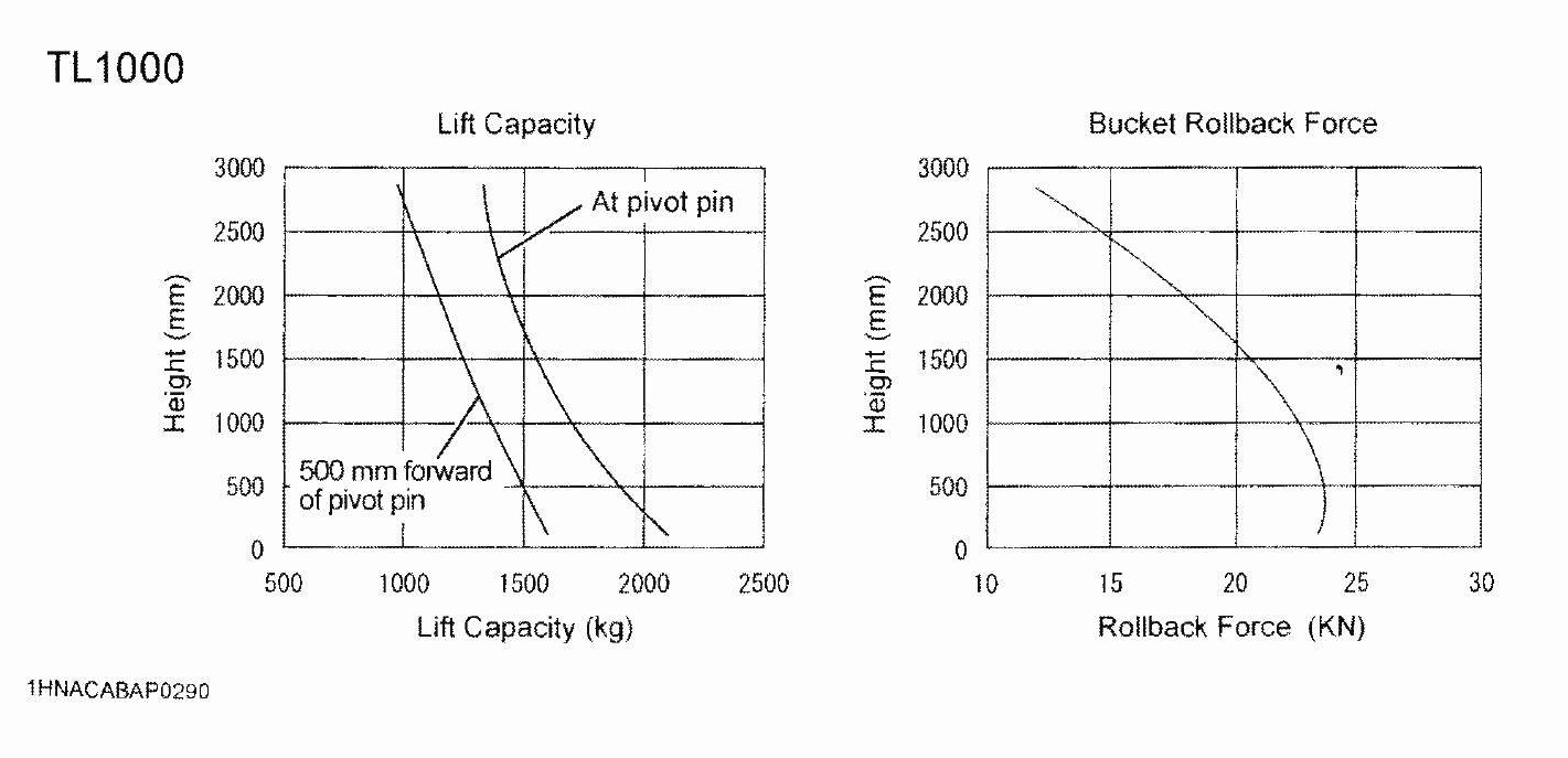

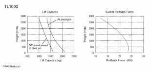

The loader will lift far more than the backhoe. The M59 loader will lift 4000 lbs at the bucket pins, 3000# at the midpoint of the bucket, and 2000# at the bucket lip. The M59 bucket holds about a cubic yard of material - which will vary from 2000 lbs for dry dirt to about 3000 # for wet sand. The smaller L45 bucket should be sized for it's lift, but I don't have the specs. I'll attach a graph of the backhoe capacity for the M59; it will lift about 1300 lbs. Digging downforce is much higher, and the backhoe has no problem lifting the entire tractor while pivoting on the bucket lip.

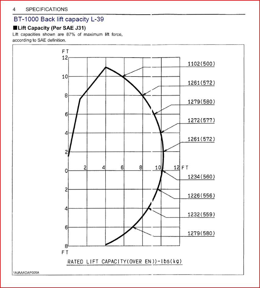

I.m surprised that the craning specs on the M59 are no stronger than the L39/L45 according to the manual?
The rest of the specs outclass the 10' ft. hoe

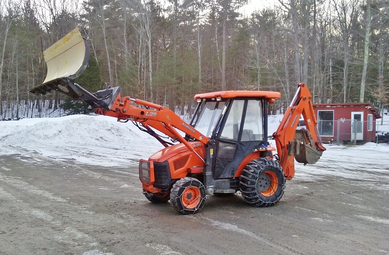

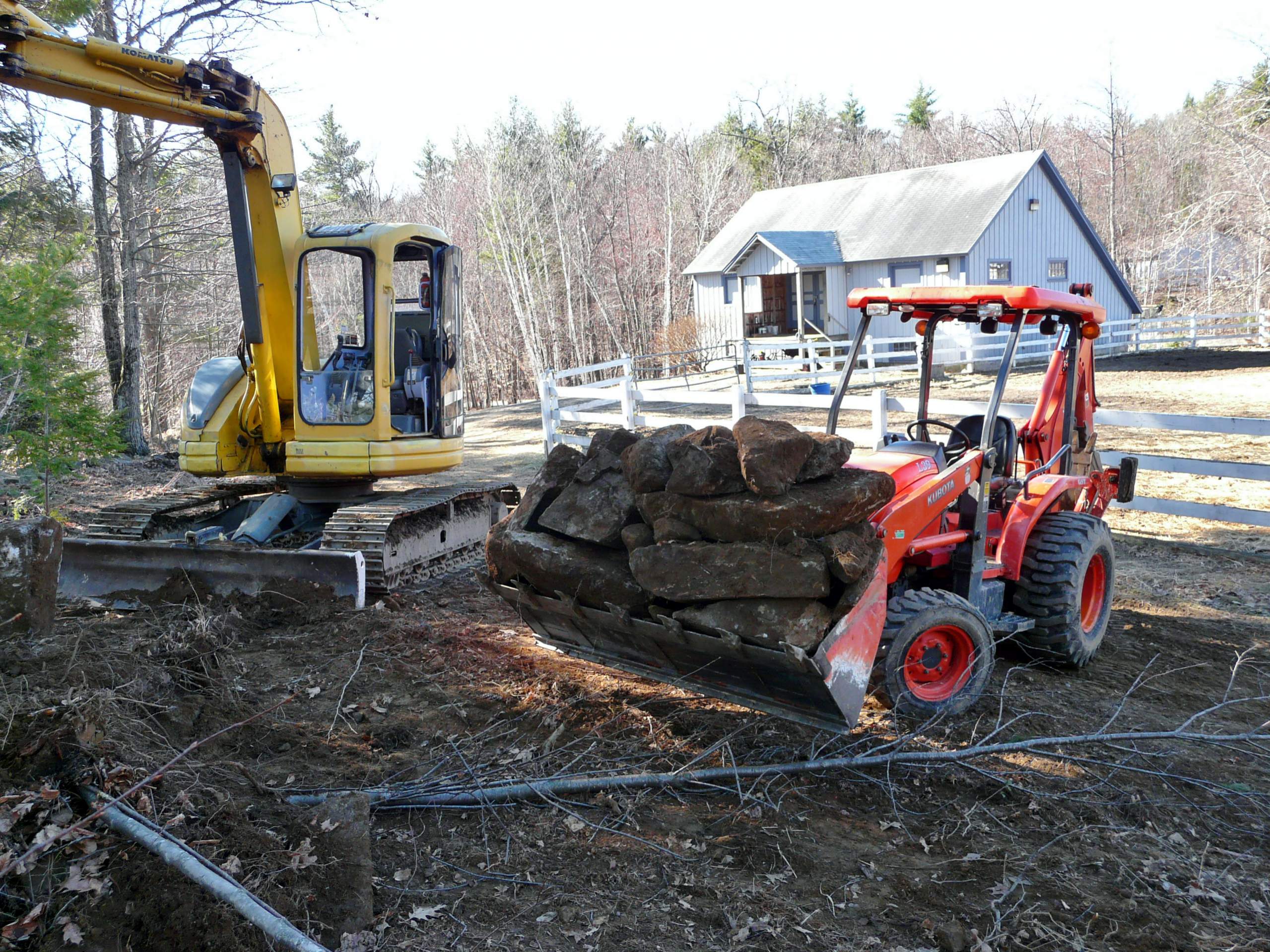

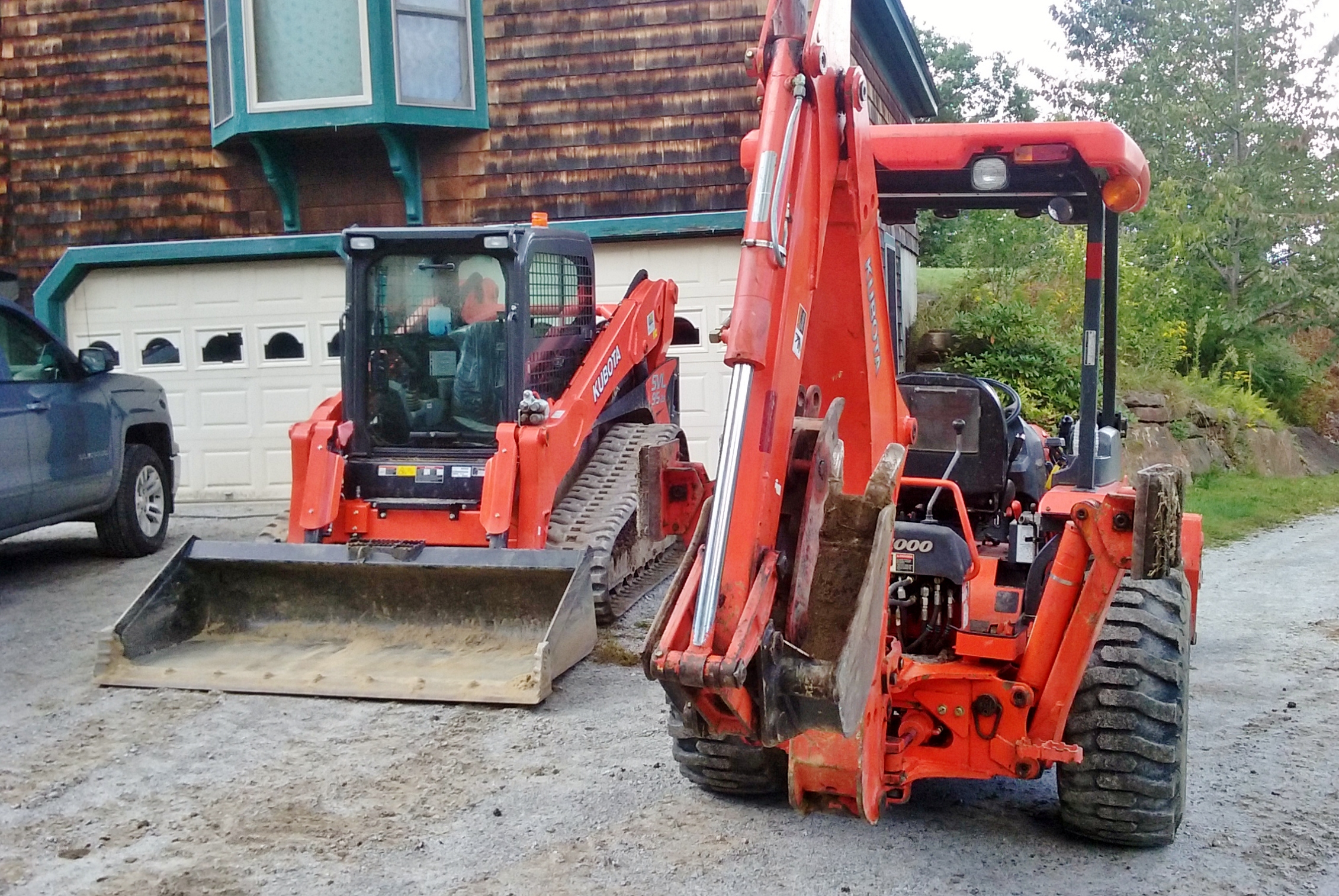

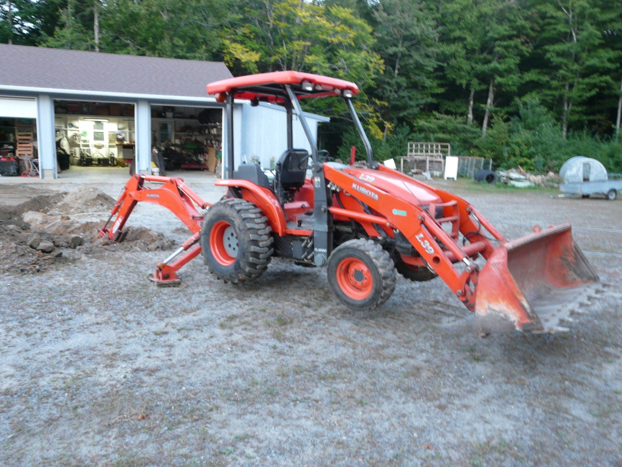

As can be seen in the attached my neighbor & I have different solutions to similar challenges.
Traction: Skidsteer, Tractor , Tracsteer, just something to consider.

How well would the L45 lift 2000 lbs? I've never looked at the specs but that's got to be near it's limit.
Lifts over 2,000 just fine. Just to full height is areal pucker factor.
I was really nervous lifting 1,800 up on a 1'st floor deck, and I have wheel weights also.

So the rental place dropped off the L45 a day early and they're coming back on Monday to pick it up. Apparently they had a lot of deliveries scheduled.
We had an ice storm last night and so everything is frozen and it was pretty windy too, so I had to really bundle up. The rental yard didn't bother removing the 2 cubic foot ice cube from the backhoe bucket, but the kids got a kick out it when I finally got it loose.
It's smaller than I was expecting. I'm only 6' and there's no way I can swivel in that seat, my knees and feet have nowhere to go. The L-N-M-N-H lever is really hard to use on this particular unit, but I don't know if that's normal. Needed two hands to shift. It has 900 hours, but all rental, and it looks roughed up. The parking brake also didn't have a good feel on it.
The ground here is frozen so that doesn't help, but the backhoe was really struggling with a 24" bucket to break some of the rocks out of the ground. I'm sure I need a lot more practice, but I was surprised how easily the bucket would just freeze. Wasn't slow, it just couldn't curl and break the rocks out of the soil. I don't know if the wheels are filled or not, but it was kinda scary how easily the backhoe could drag the whole tractor around. The outriggers just dragged along the topsoil. Maybe the parking brake wasn't set right. I'll check that tomorrow. The overall backhoe reach also seemed short. When I read that it was a 10' backhoe, I was thinking "I won't need to dig 10' deep holes" but what I wasn't thinking is that you can only dig a few feet before you need to reposition and you can't empty the bucket more than maybe 8 feet on either side. So that was disappointing, but I also know that ~$30K isn't really going to get you a lot of backhoe, especially when you can remove it and run a 3 point off the back.
I had fun for an hour before I had to get back to my desk job. I think I'll like having something around, hopefully tomorrow I'll be able to decide if I can live with the L45 size.
