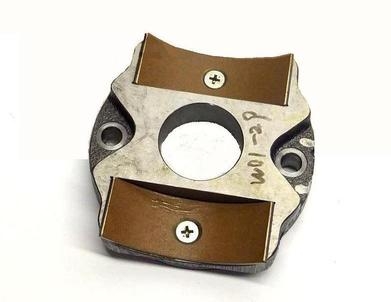

Here's a WSM page showing where the cradle bracket goes in the unit. After bolting it in I solvent cleaned the surfaces and put the port block back on with Permatex Ultra Grey (no gasket). HST is ready to reinstall.
after blowing up the picture 400% it still looks like brown paper over the bearings, you can even see it crinkled..
The pic was an online image. The new part looks the same - its coated with light brown grease (for that crinkled look:rolleyes:) and sealed in plastic wrap. I cleaned it, coated it with UDT and bolted it into the case. The bearing faces are bronze - high copper, low zinc, maybe a couple percent silicon for hardness.

Any idea as to how the bearing came loose? How did you diagnose it prior to removal? .............Cradle bearings need to be very low friction so the swash plate can pivot easily. All the units I work with have needle bearings...........
Rolling bearings trade low friction for high contact stresses - fretting (same as potholes - shear failure below the surface). Shell-type bearings spread out the load better than rollers. But they're not perfect either.
With everything immersed in oil, the unit will run a long time even with worn cradle bearings - as long as they stay in place. In this case the head of the shell's retaining screw was gone (worn away).
My guess is root cause was debris in the fluid sometime in the past. I don't know the machine's history - prior owner said the dealer serviced it. When I opened it up, one bearing was out of position in the corner blocking swash plate travel.
With a new bracket and bearings it all glides freely now - ready for a couple thousand more hours.

rScotty: I should have been more clear in post #31 above. This weak reverse condition has existed since 2013. Back then, to avoid the project of dismantling the machine I tweaked the regulator and servo piston to favor reverse - so reverse worked again - but it's never been 100%. I've put the current job off for years but the cradle bearing damage was already done. I just didn't realize it, having only diagnosed it from the outside.
When I got it apart I found the swash plate had severely rubbed into both bearings, and both cradle retaining screws. One was a bit worse than the other - both more than 70% gone - very little remaining thickness.
No idea why one side was worse than the other - the servo piston pushes from one side so there are uneven operating forces on the swash plate.
The failure came when the screw on one side let go, the bearing crumpled and jammed at the servo cylinder, blocking it from going past half travel. The tractor abruptly lost full reverse and the condition hasn't changed since.
Reverse doesn't need to be fast so the tractor has been operating with damaged cradles for several years. It's an extra tractor around here and doesn't get used much. It usually has a brush grapple mounted so with the hydro fixed it may get more use.
On the question of no apparent damage on the swash plate, the bearings are a much softer material. The flat head retaining screws are steel, but also softer than the swash plate. Hence no scratches.
I'm not at peace with the design to retain the bearings. Each has one small screw. If the oil is clean they see very little shear load, but any foreign material that increases friction can threaten the unit's longevity.

Here's a picture of a new bracket with bearings.
Interesting saddle bearings, Dick. The way it is secured is a little surprising...Philips head machine screws.
Here a is comparison saddle bearing on a McCormick GX50H (Landini), a similar sized 50hp tractor with servo-controlled swashplate. Most of the exotic material (bronze?) seems to have worn off mine. Pins retained the bearings, and were unlikely to back out. The maker is Bondioli Pavesi, if anyone cares.
Thx for posting. Any pix of the worn out parts?
Hi Dave - great to hear your voice ! I was hoping you'd see this thread and comment, maybe curate a bit with you knowledge of Kubota HSTs. btw I almost bought a Landini orchard tractor years ago - big power in a small package.
Here are a couple pics of the worn parts. The bearing still in place shows a narrow edge of original thickness and remnants of bronze facing. Looking close there are scuff marks on the head of its screw - and it is loose. The other bearing is trashed, screw head gone - threaded end is in the hole and turns freely.
The HST in the L48 is the same one used in Lxx10 models. The L48 is over twice as heavy as a L3010. Think about the pressure peaks reversing a 4-ton machine vs one only 2 tons. I'd say the cradle bearings have an easier life in the L3010.
