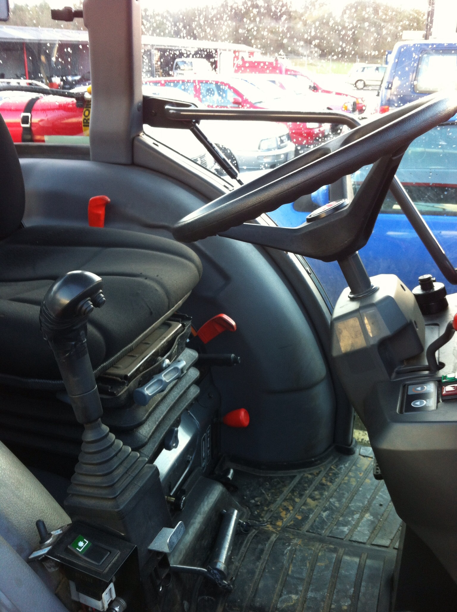

What was wrong with the cylinder? I have that problem on my 5030 as well.
I have to admit that nothing was wrong with my tractor. It was just the 3pt valve under the seat. I knew about this valve very well, and tried to adjust it to remedy the problem. Well, it turned out that looking back at the 3pt arms while operating the lever and at the same time turning the valve between my feet, I was actually adjusting the seat air suspension knob which strangely had no effect on the 3pt......
You can see on the picture that they are pretty close....
Anyway it was a cheap fix, just some hurt pride....
