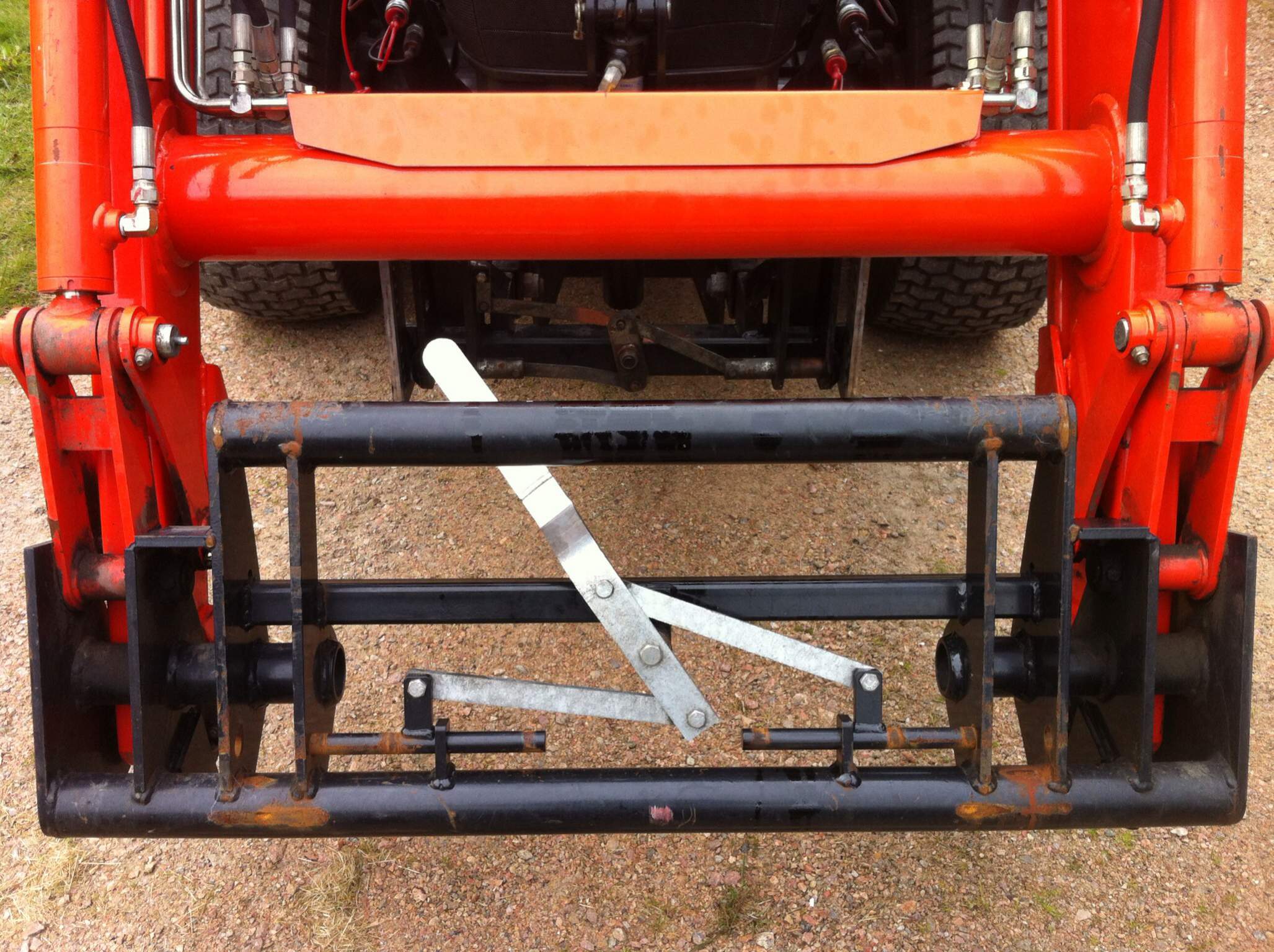

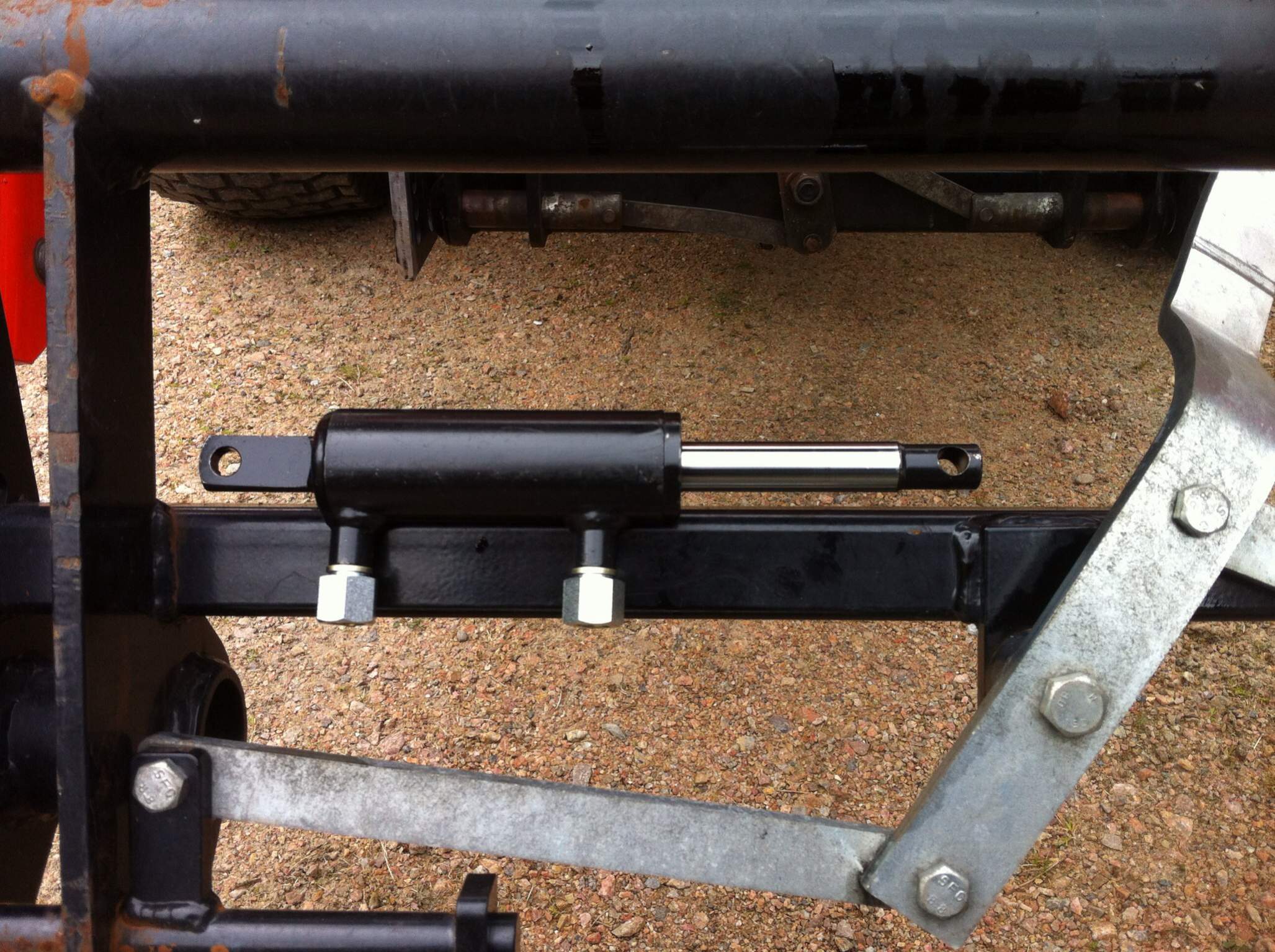

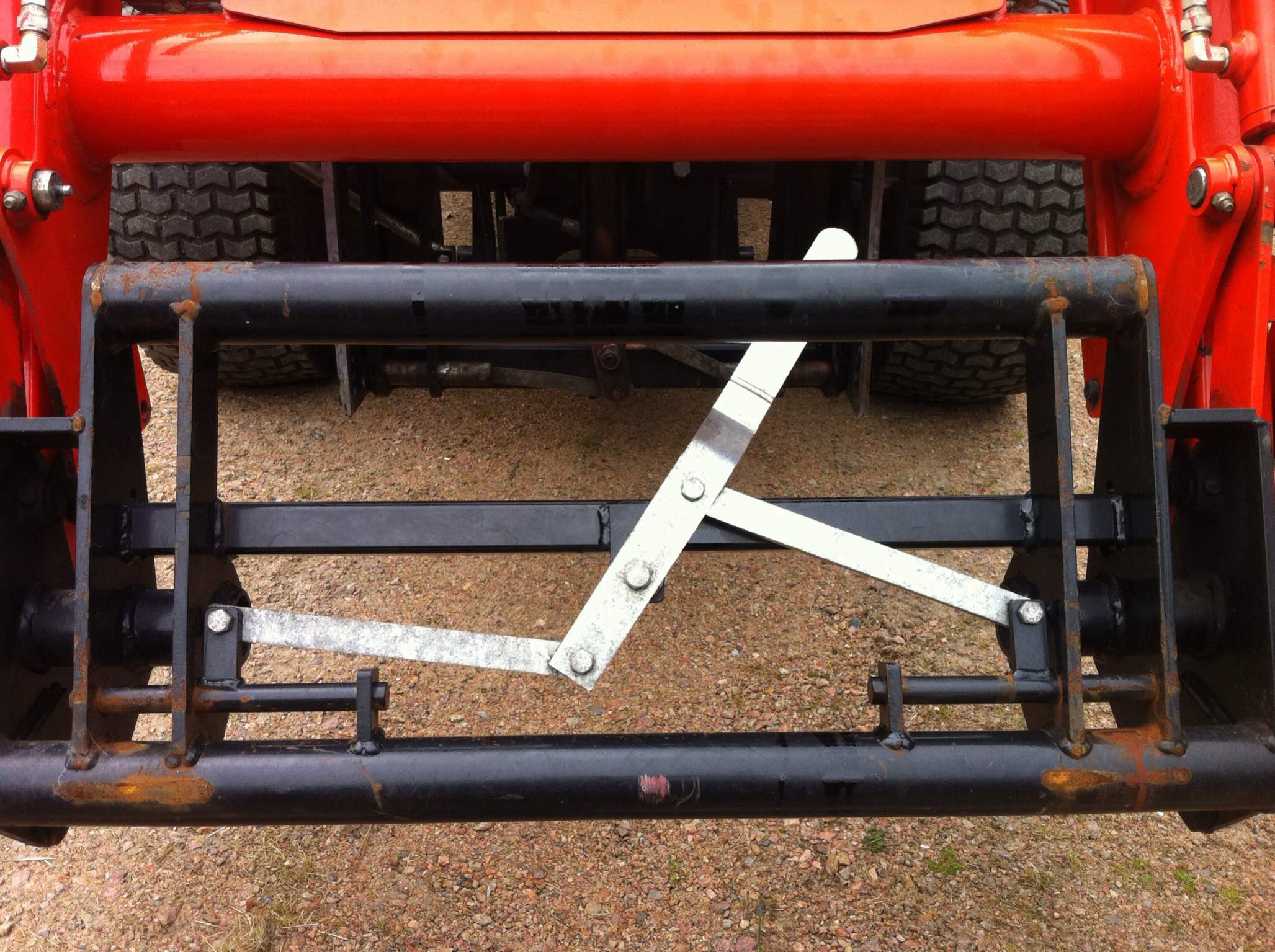

Will add a hydraulic cylinder to the existing QA lock mechanism. Using a small cylinder I already have but will have to weld on attachment points.
More photos will be posted as the project progresses.

Is this a home made quick attach? Looks very very beefy!
   / L5030 Trima/SMS Quick Attach adding hydraulic implement locking
Great week end project Marcus!
Keep us posted on your work progress!:thumbsup:
Thanks! The Trima QA is widely used here on Ag equipment for the last 40 years or something ( slowly being replaced by the Euro QA on new equipment), and all LA853 loaders came equipped with it by the Scandinavian Kubota importer.
Been working mostly on the forks project http://www.tractorbynet.com/forums/...rklift-hydraulic-forks-trima.html#post4152594 so no real progress yet, but I did find a 3/2 electric valve that I think would work to pipe this into the planned third function and get them to operate independently.
Will keep you posted!
