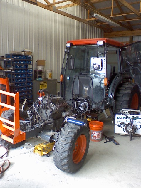

   / L5030HST Lleaking oil from weep hole #6
Someone asked what the seal looks like, and how the jacks were used to support the tractor ends. Here's a couple of shots I took that showed how I did it on my Grand L3240:
This shows the transmission input shaft and, below that and marked with an orange arrow, the location of the propeller shaft seal. I tried using a pair of small screwdrivers to remove the seal, but ended up pulling off the mid case so I could remove the propeller shaft and get a better grip on the seal. Lots of extra work! There is a coupler in the mid case, but as can be seen in the photo, the propeller shaft has been pulled well forward and out of that coupling without causing the coupler to come off the spline at the other end. Maybe I was lucky, but when I go in again to replace the seal, I'm going to try pulling the propeller shaft all the way out without removing the mid case and see if I can save a little time.
This shows the front and rear of the tractors split apart. I used a small jack under the rear half and a large jack under the front half to roll that part forward. It was a bit of a surprise when the engine tipped to the right after the mid case came clear of the mounting studs, but it only tipped a few degrees on the engine mounts and nothing bad happened. Just wanted to mention it so others could avoid the same surprise. Once the two ends were apart I supported the weight with jack stands while I was completing the repairs. FWIW, it's an HST tractor and there was virtually no wear on the clutch plate after 3100+ hours.

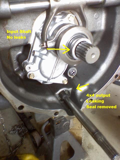

Here are some photos of tractor repair. I am going to try to take photo of chaffing on seal also.

   / L5030HST Lleaking oil from weep hole #15
How did you remove the propeller shaft seal without removing the propeller shaft?
I thought about drilling some holes in the seal, then using a slide hammer to pull it, but ended up just pulling out the propeller shaft to get better access. That meant removing the mid case, a step I'd like to avoid as that sucker is pretty heavy and I don't have any way to lift it other than a floor jack.
Any tips would be appreciated!
Thanks,
Scot
   / L5030HST Lleaking oil from weep hole #16
Thanks,
Scot
Sears and snap-on make a seal puller that has a little hook on the end and a handle on the other. I forced it past the seal turned hook and a quick yank. Out it came. It was not in there like a normal seal. A flat peace of steal like an old dip stip or something mite work well also. Bend small 3/16 hook and try??? Let me know if this works????
