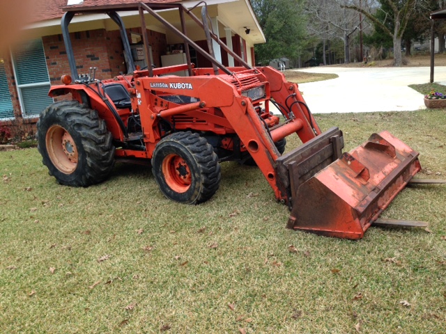

It may depend on the loader you have. I have the LA1150A. I never take mine off but it has the set of kickstands above the steering wheel and it is all set to take it off.

The loader is just like yours. It even has the remote valve mounted on the fender as in the picture. This tractor has two bolts holding the brace in the cradle in front of the radiator. The steering tie rods that are ahead of the front axle are bowed, probably from running over saplings. That is a bad place for steering tie rods IMHO.

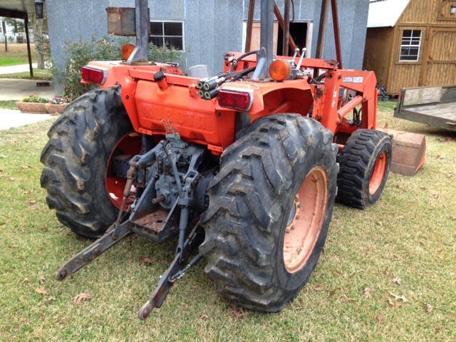

Tom, we were at the Kubota dealer for the transaction. He looked up the serial number and said it was made in August of '98. I've found Tractordata.com to be a good reference, but some of the data is general, at best. Here are two pictures of the homely girl.

You say she's homely - I say she's positively fine! Some examples: (1) the fender-mounted tail lights and blinkers are still intact -rare. (2) the sheet metal is all there - also rare. (3) the grille guard is still straight, as are the extra limb lifters (4) the rear rims look to be rust-free at the valve stems (5) the 3-point lower arms are reinforced with flat bars welded along the bottom - gives a clue about how a L5450 3ph will lift a house (6) I really like that it hasn't been repainted - there are some worn spots that show it has done honest work, but no hiding of old damage or weld repairs. I think this L5450 looks great - an honest no-bull beefy tractor. Congrats !
If you look under the floorboards along the loader stays, the 2 braces may be clipped on there. I'll see if my loader manual has a drawing I can post. The two bolts from the front cradle are used to attach the flat bars to the bucket - and the stays support the boom.
