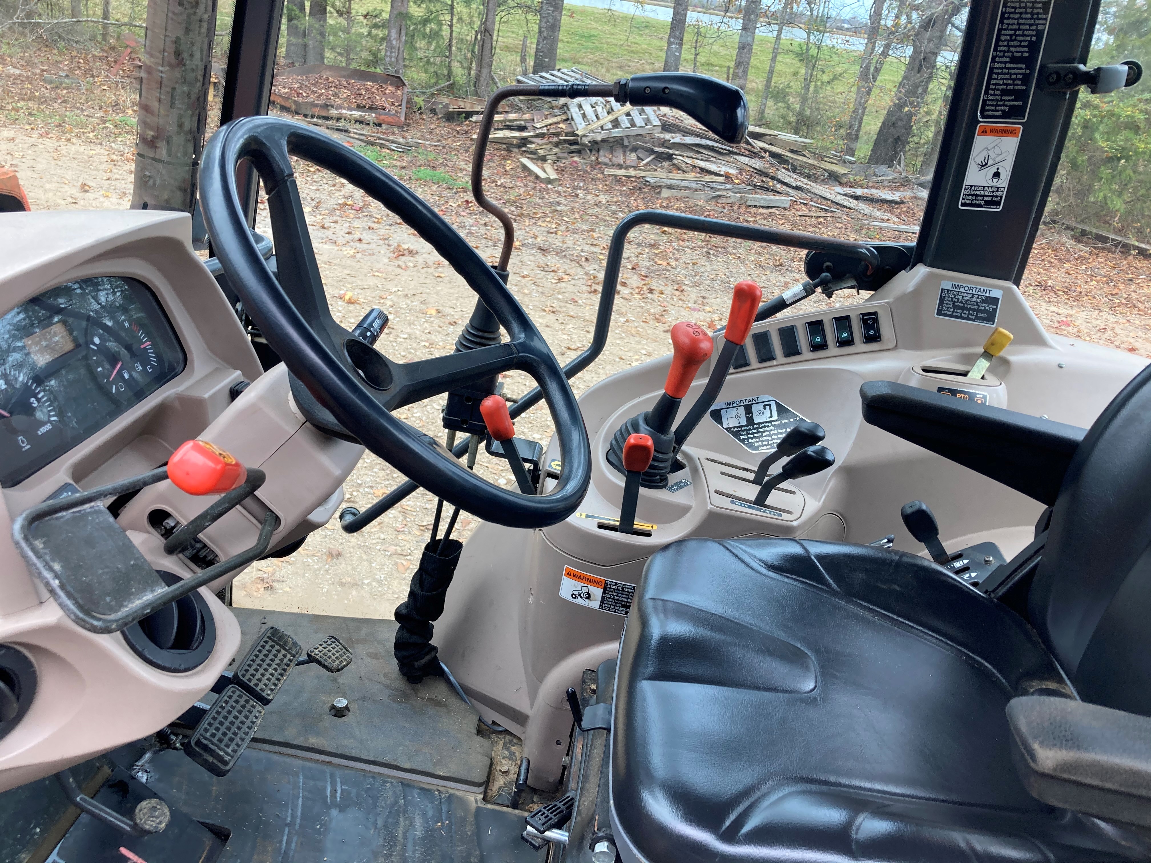

Hey guys, looking into a Kubota M9540 cabbed tractor, 4wd, loader, Hydraulic Shuttle.. Has the ultra grand cab with air ride? seat. The tractor is around an 08 or 09 model. Been very well cared for. Interior cleans up super nice, exterior looks really good. The tractor was purchased new w/o a loader and a new Kubota loader was put on it 3 years ago. The bucket is practically new and it comes with a new hay spear as well. It was priced to me at $27,500 and from what i can tell it seems to be a pretty good deal on a well cared for, pre emissions tractor. My only concern is that it does have 5200 hours on it. It has spent its last 3 years as a farm/hay tractor. The current owner is a close friend of mine and i know he's very meticulous. When he purchased it, he replaced the entire a/c system and put a new starter on it. The only thing i can find wrong with the tractor is that it takes just a brief hesitation (maybe a second?) when going from forward to reverse with the hydraulic shuttle when COLD. After it warms up, it seems to be fine. It has a small hydraulic leak at the shuttle valve, the Kubota dealer says there's likely an o-ring there. I wont put 100 hours a year on it, but i'm in dire need of a decent tractor. I'll be using it for general farm work. Bush hog, light loader work, a little haying here and there.
Give me your opinions pleases!! Thanks in advance

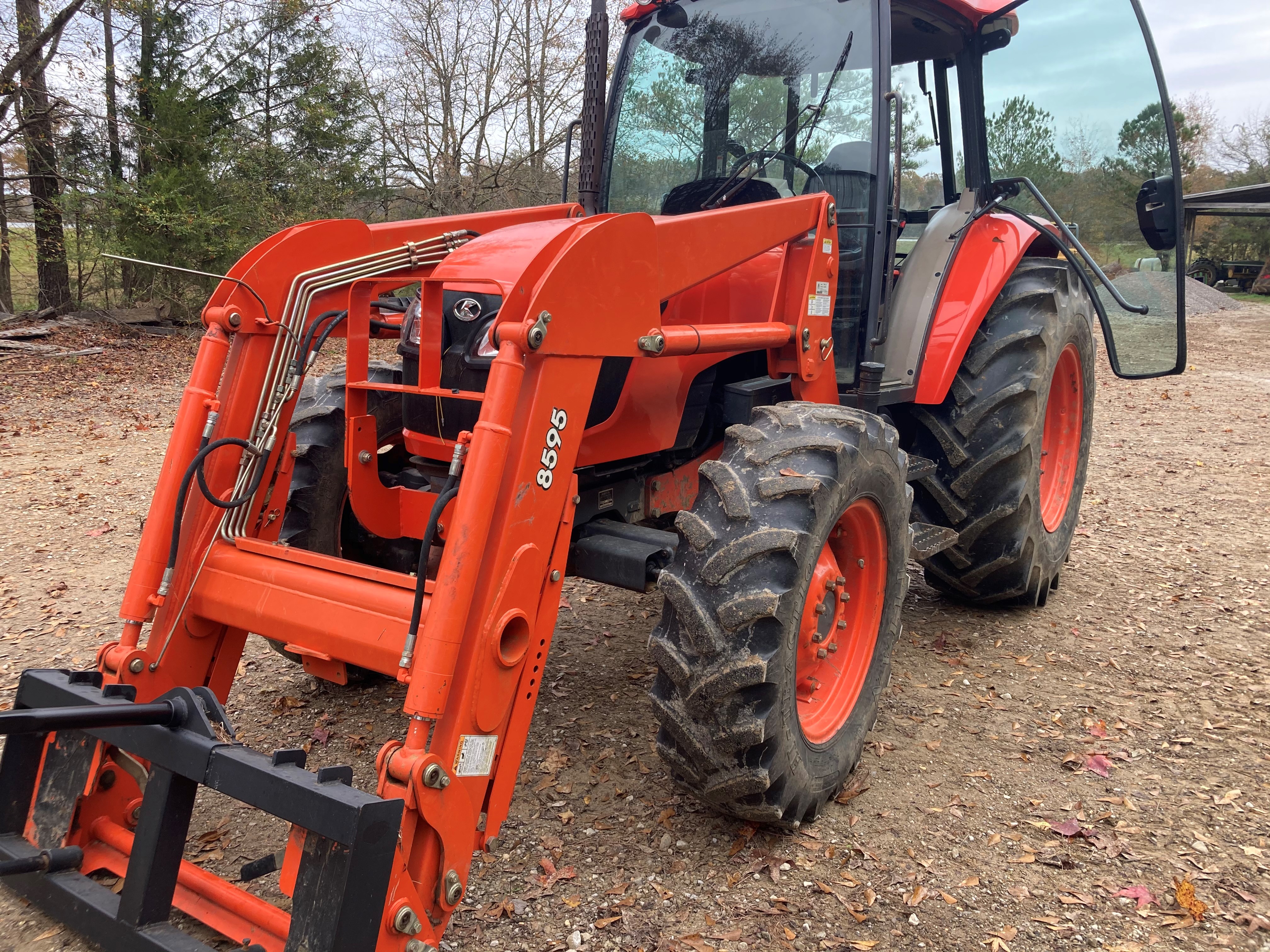

Looks pretty good for a 12 year old tractor. Few things got my eye but I'd have to see it in person.
First, those tires don't have much life left from the looks of it.
Next, I'm not seeing grease on the loader like I'd expect so might be worth checking other grease points and see if it's good (take a gun and pump some grease to see what the condition of it is etc.).
Looks like aftermarket bolts on the lifting arms at the extension? I'd just have to see what was going on there.
Last, the housing at the hydro dipstick looks cracked in the picture? Probably just hay or something.
5200 is a lot of hours but if you'd only be using 100 or so hours a year it has some years left. Why's he selling it?

Very nice tractor. I had a M9540 Dual Speed which is a partial powershift :thumbsup: also came standard with a park brake on the shifter, air seat, extra remotes and a bunch more goodies. I paid 40k, but it was only 3 years old and maybe 350 hours with a loader.
I think the hours are a tad high, but with proper care and service, they are a very nice hay tractor for smaller operations. I sold mine and bought my M135x for heavier bale lifting, more HP and bigger wheels/tires.
Lots of guys let go of higher hour tractors when it comes time for tires. They are a big expense and some sellers look at that as part of the deposit money on a newer one.

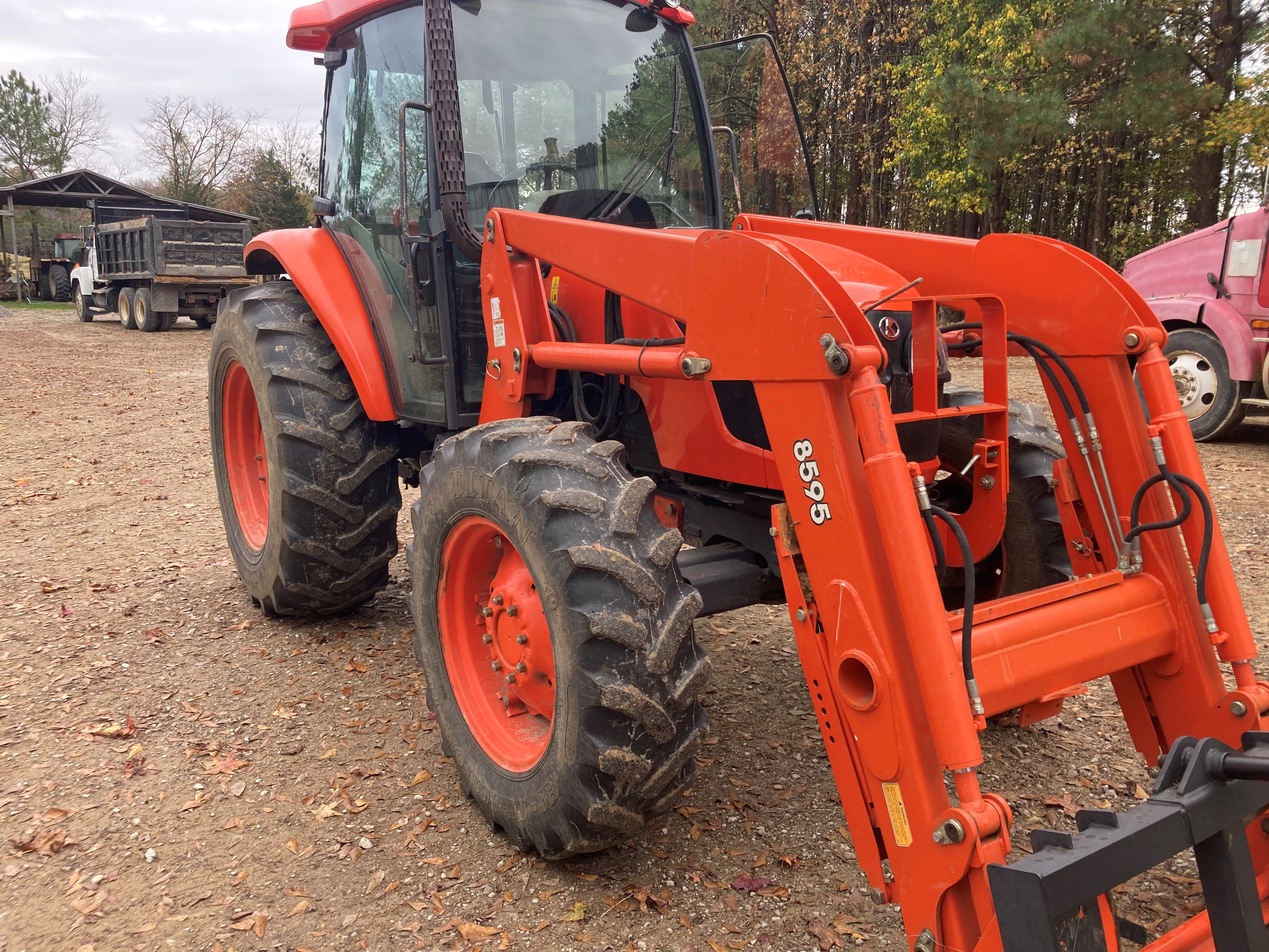

The tires probably look a little better in person, I'd say i have a good 3-4 years left in them. It wont leave my farm very often at all, so it shouldn't see any pavement.
I didn't notice a crack at the dipstick, but ill certainly check it out.
He's pretty good at greasing stuff, but he pressure washes everything a couple times a year. I am confident the loader is tight and been properly maintained. He runs a excavating business, so he knows the need for greasing things.
His main tractor (100+ hp John Deere) went down last spring with trans troubles and it stayed in the shop longer than expected. It got to crunch time on hay mowing and he bought this tractor to get him through the year until he got his JD back. He finally got his JD back mid summer but kept this one just because it was handy to have a 3rd tractor. He purchased it from the service manager at our local kubota dealership who sold his farm and no longer needed a large tractor. Service manager owned it for the 2-3 years prior and used it has a hay tractor as well.
