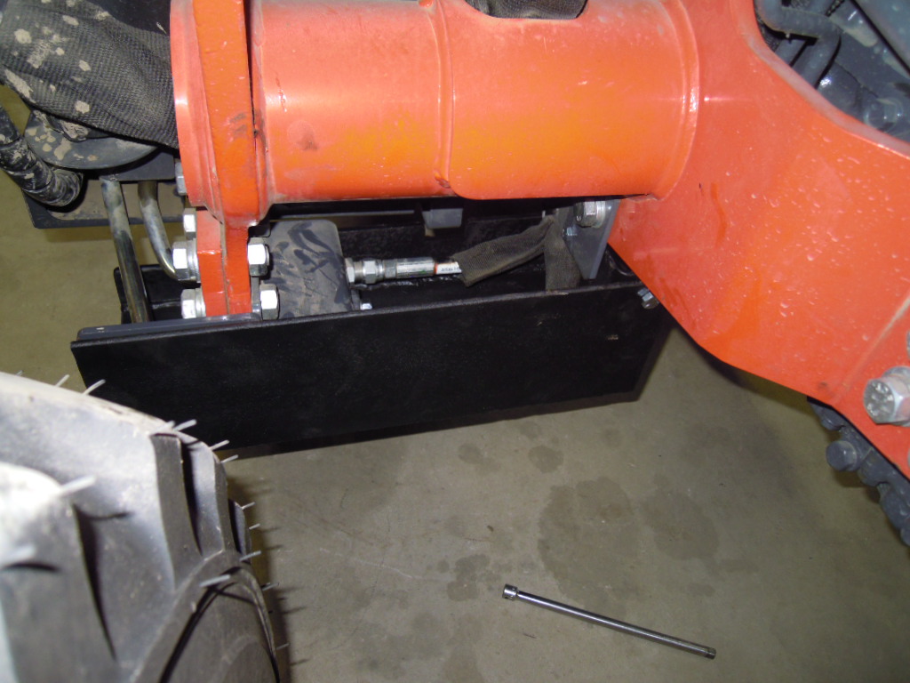

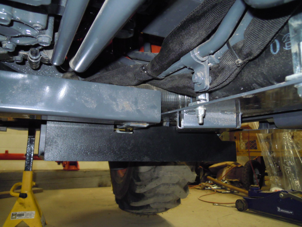

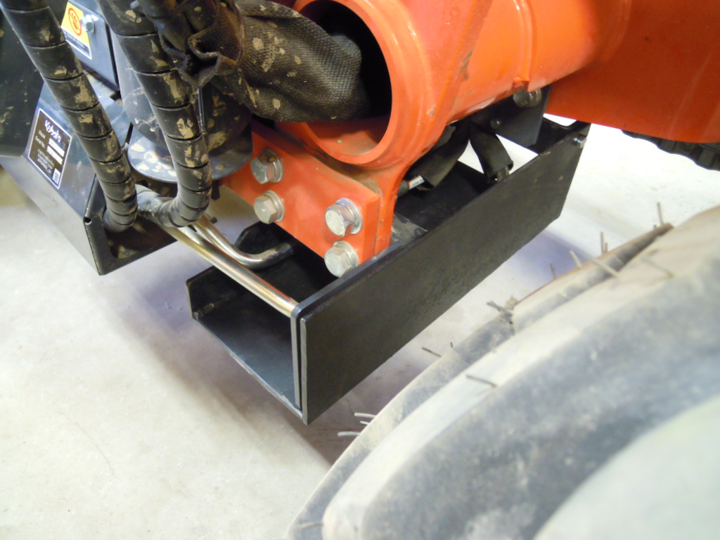

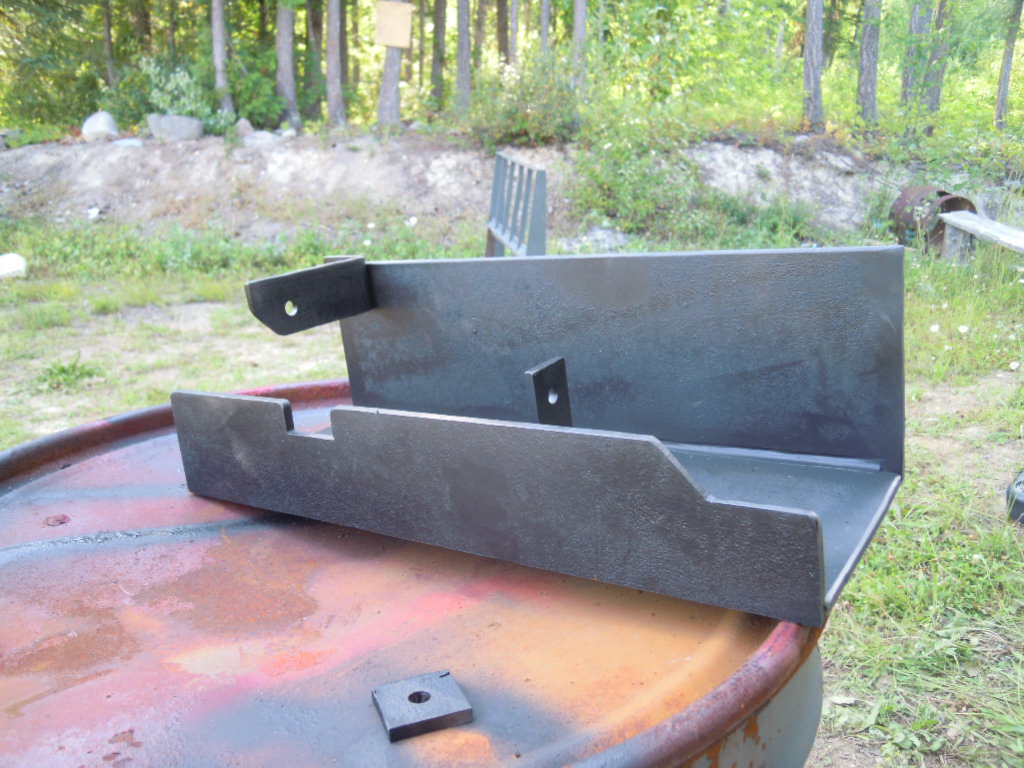

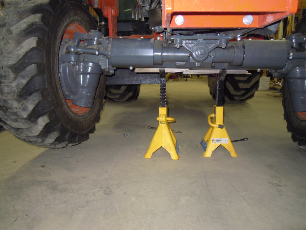

Well I finished making a guard for the 3rd function hydraulics and here are some pics. The first pic color is wrong, not sure what happened there.
After installing this I realized it may not be a great idea, since the whole thing hangs lower than the rest of the undercarriage and makes it more susceptible to getting hit. So I thought about it for a bit and realized the real problem is that the hydraulic lines should be routed somewhere that they will not be exposed to potential damage. After looking at the setup for a while I believe I found a solution that is very simple. I just need to talk to my dealer to see if there is some reason that I can't reroute the lines the way I want to. Maybe they will be too close to some major heat source or something else but I don't see anything obvious. If he says it's OK I may give it a go and remove the guard. If I do this I will post pics.

Mine have 45s where they come out of the bulkhead routing the hoses upward.
Still vulnerable but not so much.

That's what I was thinking would be a better solution. At least that way the lines are sort of protected by the front tire, unless you climb over something with it. Have you got a picture of your setup?

I went to the Kubota dealer today and talked to the salesman and the service manager about this issue. Told them it was a very bad design, especially considering that the rest of the tractor underbelly is well laid out protected. The service manager agreed. I told him there was very easy fix to make it better and explained how it should be routed. He liked the idea and asked me to take some pics and email him so he can forward to Kubota. He said they might do something about it but couldn't guarantee it. I asked if he had the equipment needed to bend the steel lines or make some new ones and he said no. The kit comes with the lines preformed. They just install them per the directions that come with them. It will likely be up to me to fix this flaw on my brand new Premium (expensive) tractor.
There are a LOT of things I like about this tractor and some that I REALLY like but this install is not one of them.

100% Agree with this needing a solution. I had my dealer make a fabricated plate that I saw here on TBN.....and protect those vulnerable fittings. So far so good. I cannot understand what they are thinking with this situation. Just asking for trouble.....IMO.
