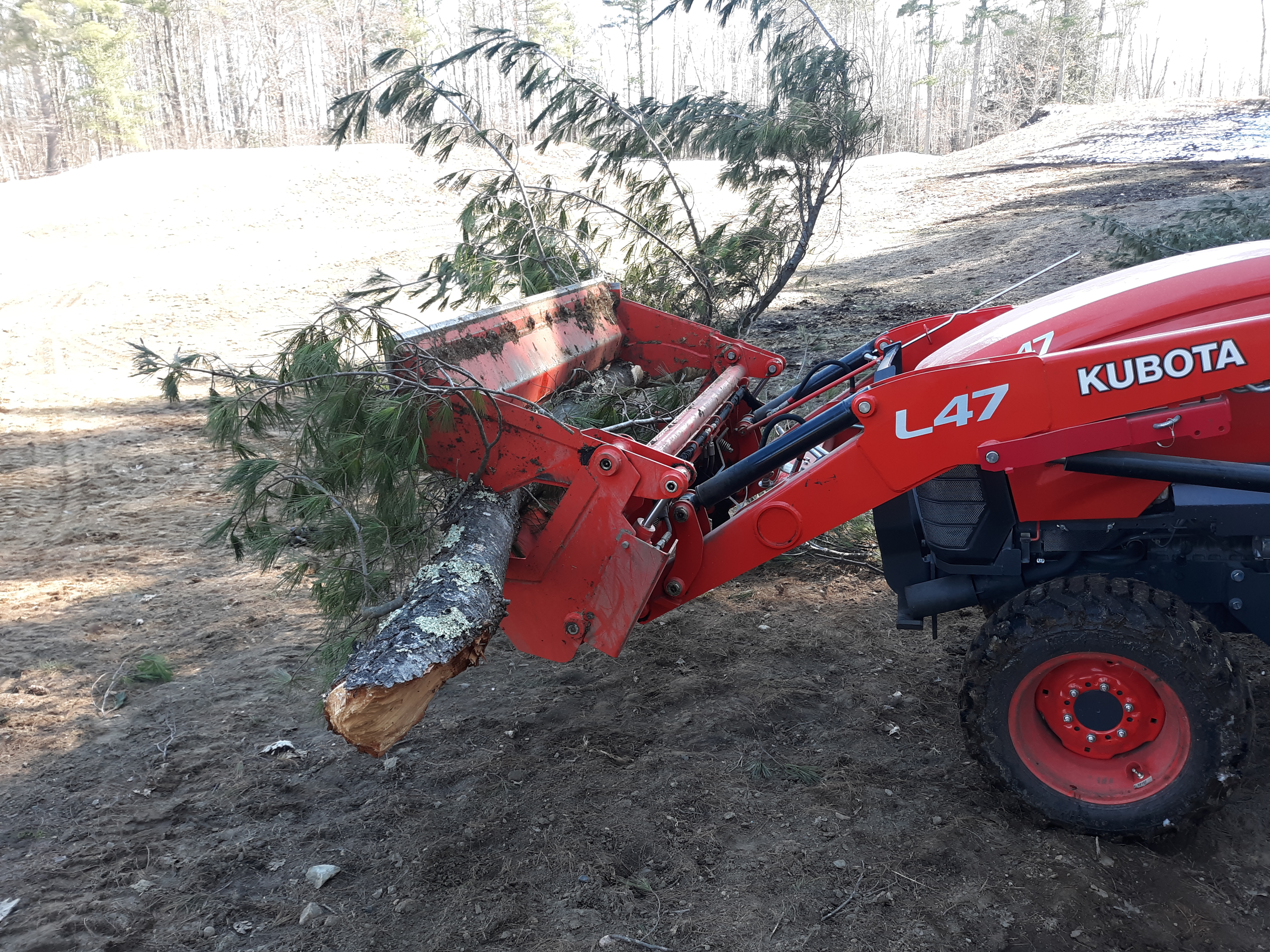

I really like my 4n1 on b26 best use is on last bucket or 2 of material in a pile, or grabbing a rock or one stick will doing chores, I wouldn't buy another machine without one.
But that is why they make 100 different attachments not everyone likes same thing. If you need to sell it they seem to bring near new price.
