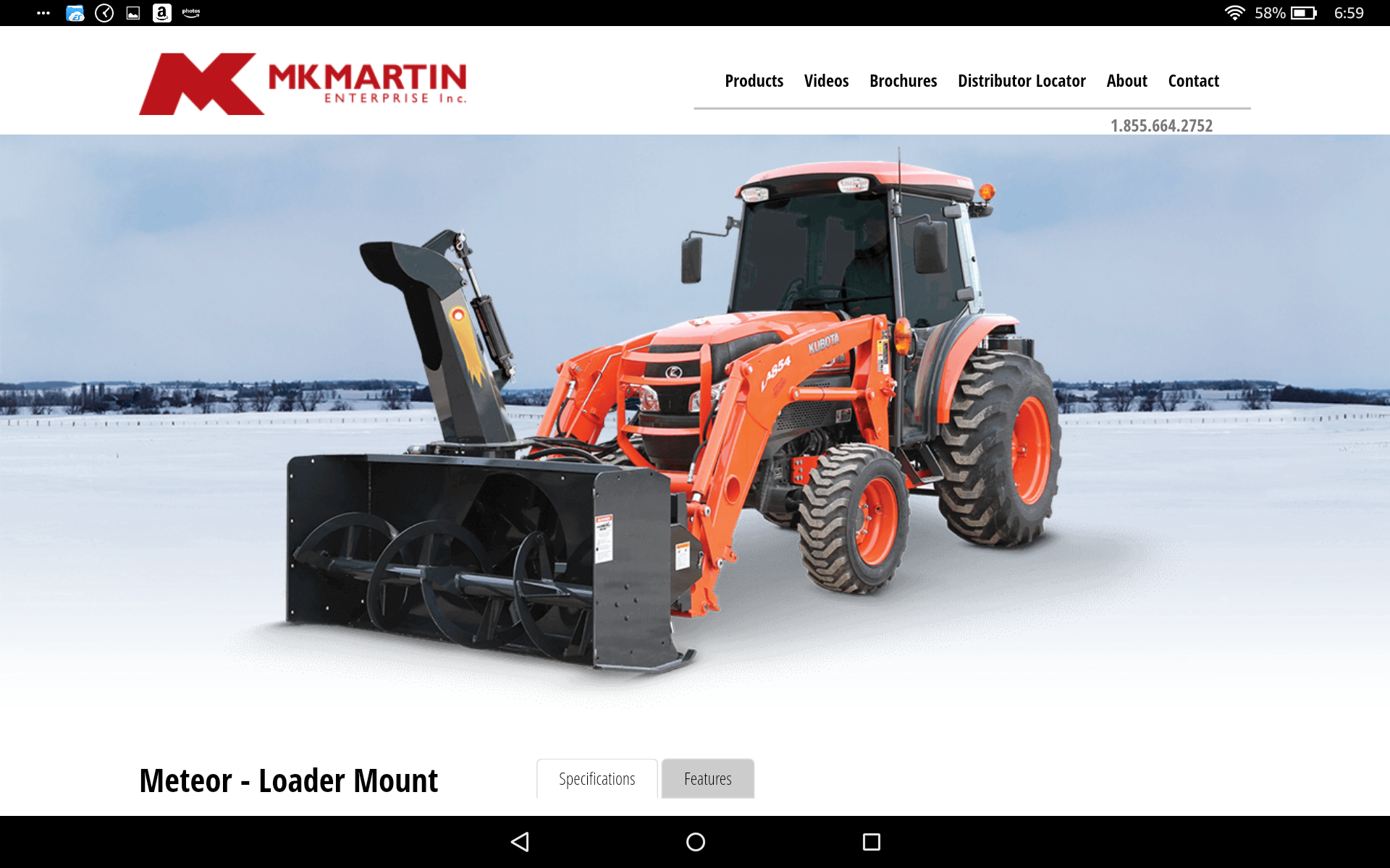

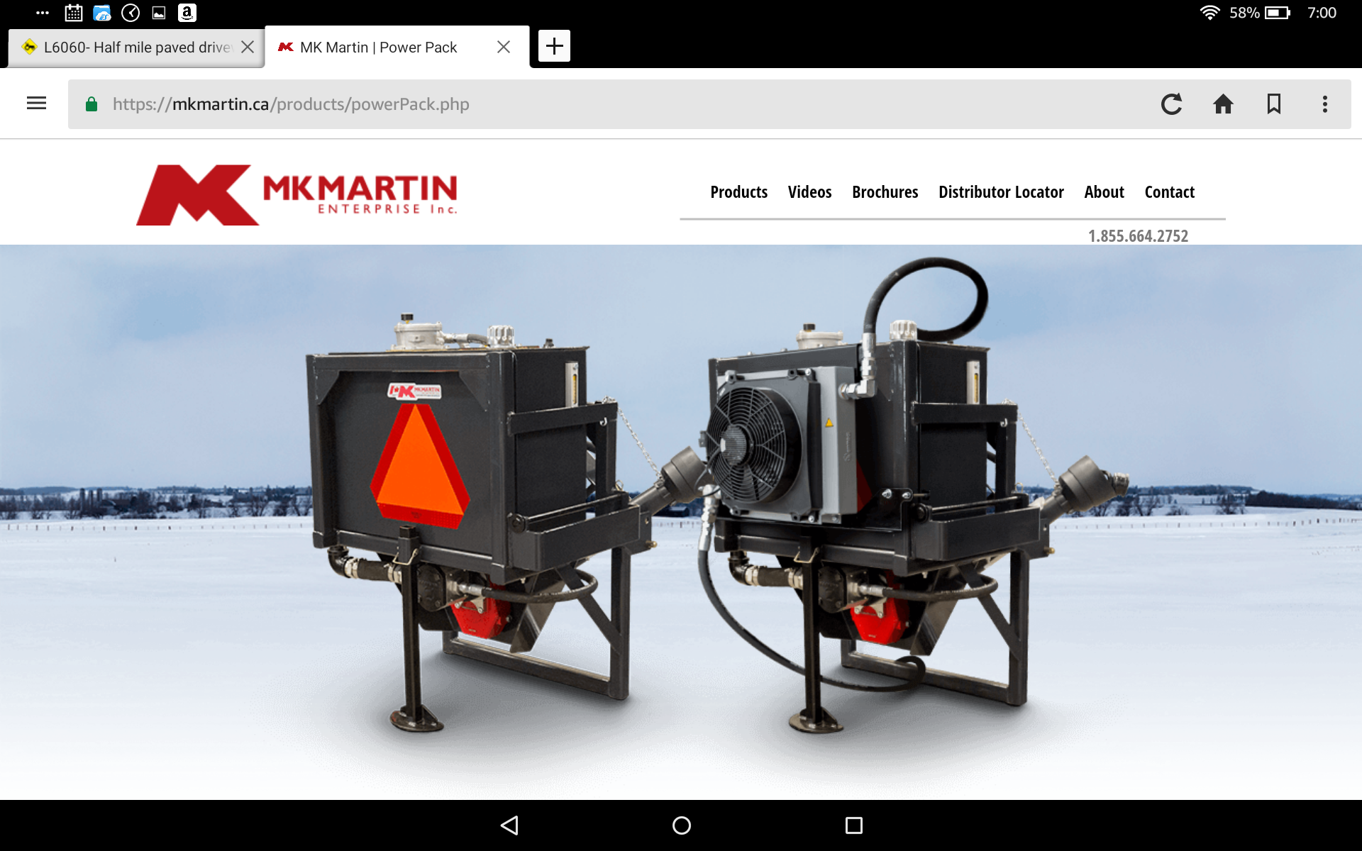

The hydraulic power pack and hydraulic blower is a great tool but very expensive. I built a power pack last year capable of 32 GPM @ 2500 psi. albeit to power a front mount mower. But future plans do include a front hyd blower.
I have reservations about 20 gpm output being adequate. ?? There is a link in previous post to MK Martin in Canada. If I were to purchase a power pack/blower combination, that is the source I would choose.
Last year I tried a snow pusher, no hydraulics required, it worked well, will continue that removal route this season.
Good luck in your quest. Note: My snow pusher has rubber cutting edge, gentle on paved surfaces !! Photo below.
