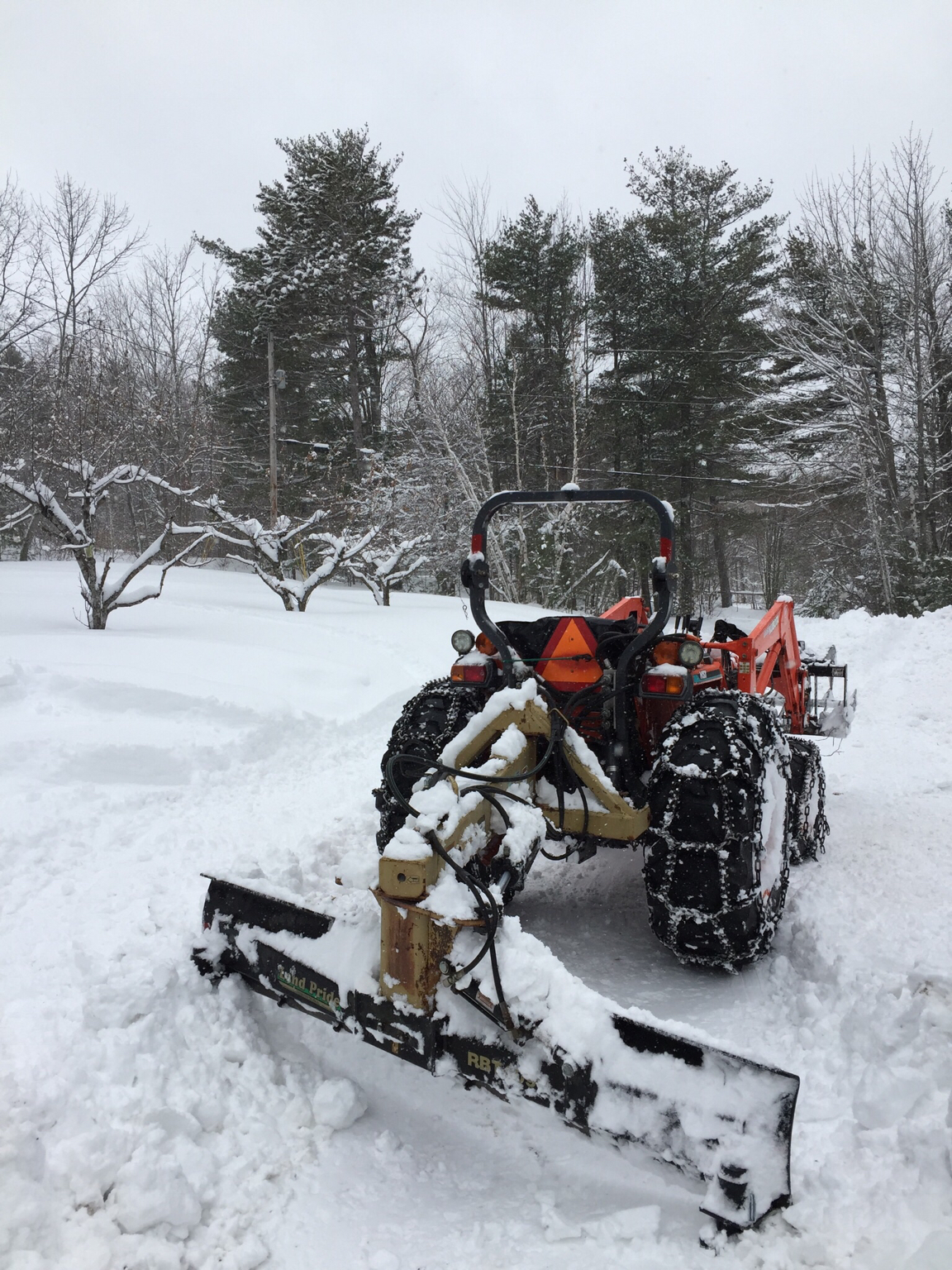

Geeze - I'm sure glad that Majorwager told me how lame it is to drive over the snow first - before its plowed. And to think - I and a whole lot of other folks, who use rear blades, have been doing it SO WRONG for all these years. PTTTTTTTTT.................

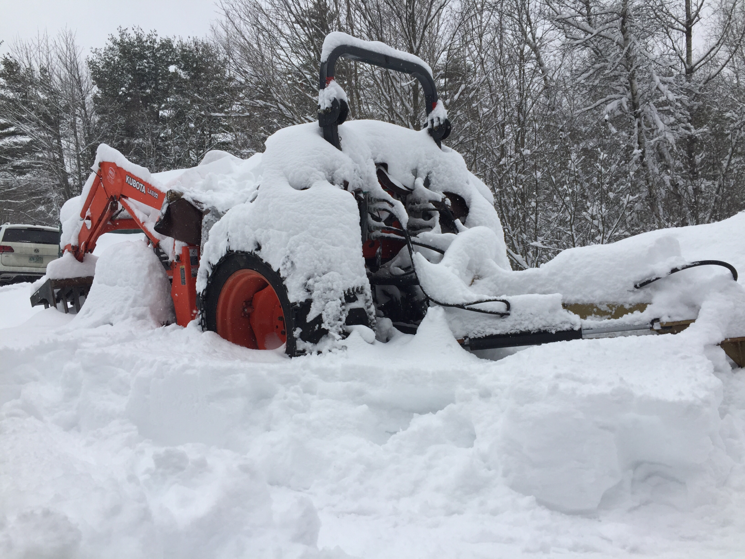

Piston - tell me that top picture is just a rare occurrence. Being dressed like an Eskimo - being out in the cold - AND having to clear all the fresh snow off before you can even start the tractor. I'm going to throw another log on...........
My carport is not much be it does keep the sun off the tractor/tires and also keeps the snow off. NOTHING can compare to an open station tractor in the cold - the pleasure of lowering your hemorrhoids down onto frozen vinyl. I smell the pines - even on the coldest day.
Reminds me of that famous saying - - "I love the smell of Napalm in the morning" - Robert Duval

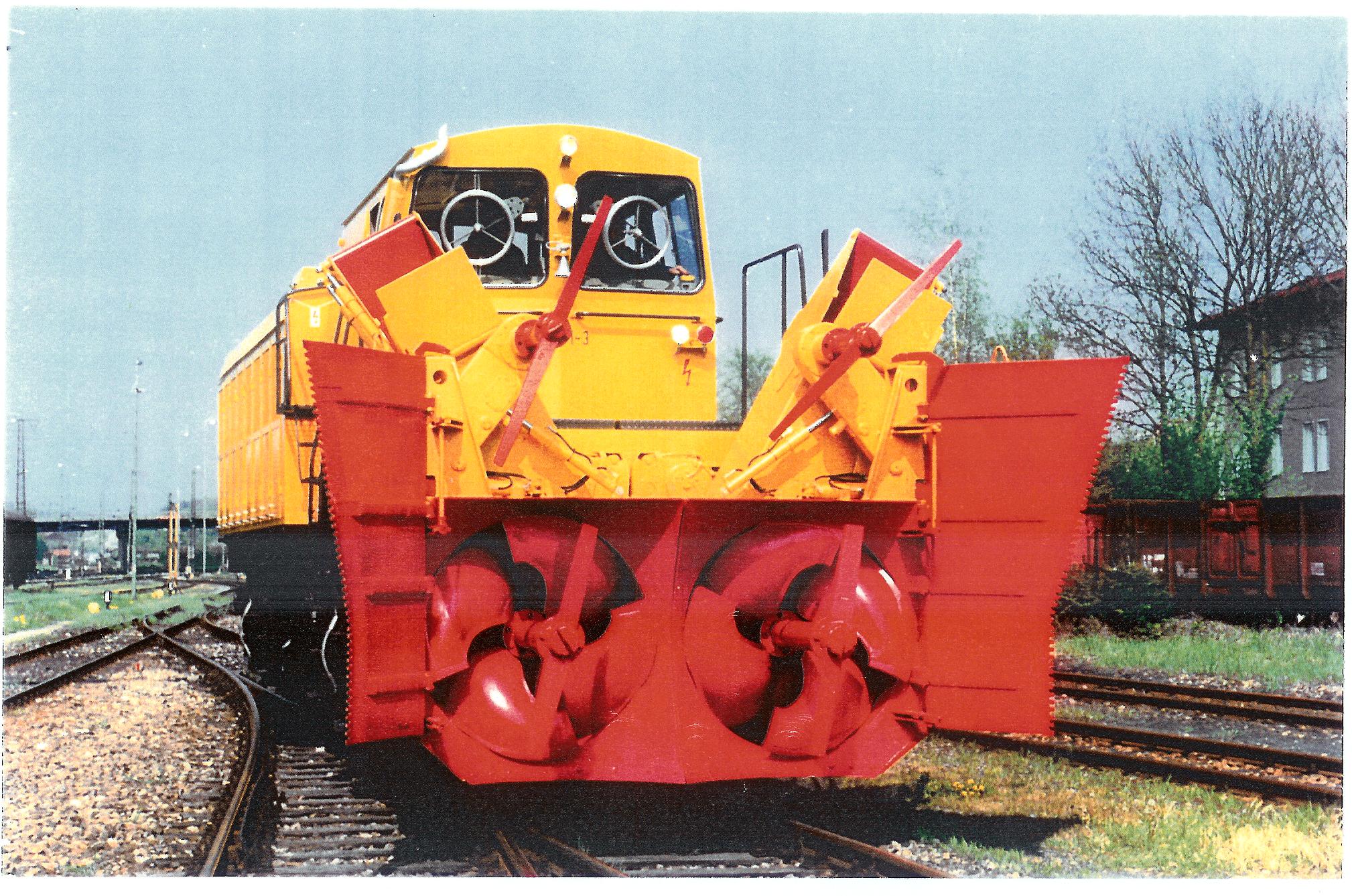

For what is worth, the Russians have been using surplus tanks and surplus MIG jet engines to clear snow for years.
There are or were a bunch of videos of them working on you tube.
ME I much prefer to do it this way and clearing over 22000 tons per hour of the white stuff.
At least fluffy and his crazy political future are no longer a problem.
