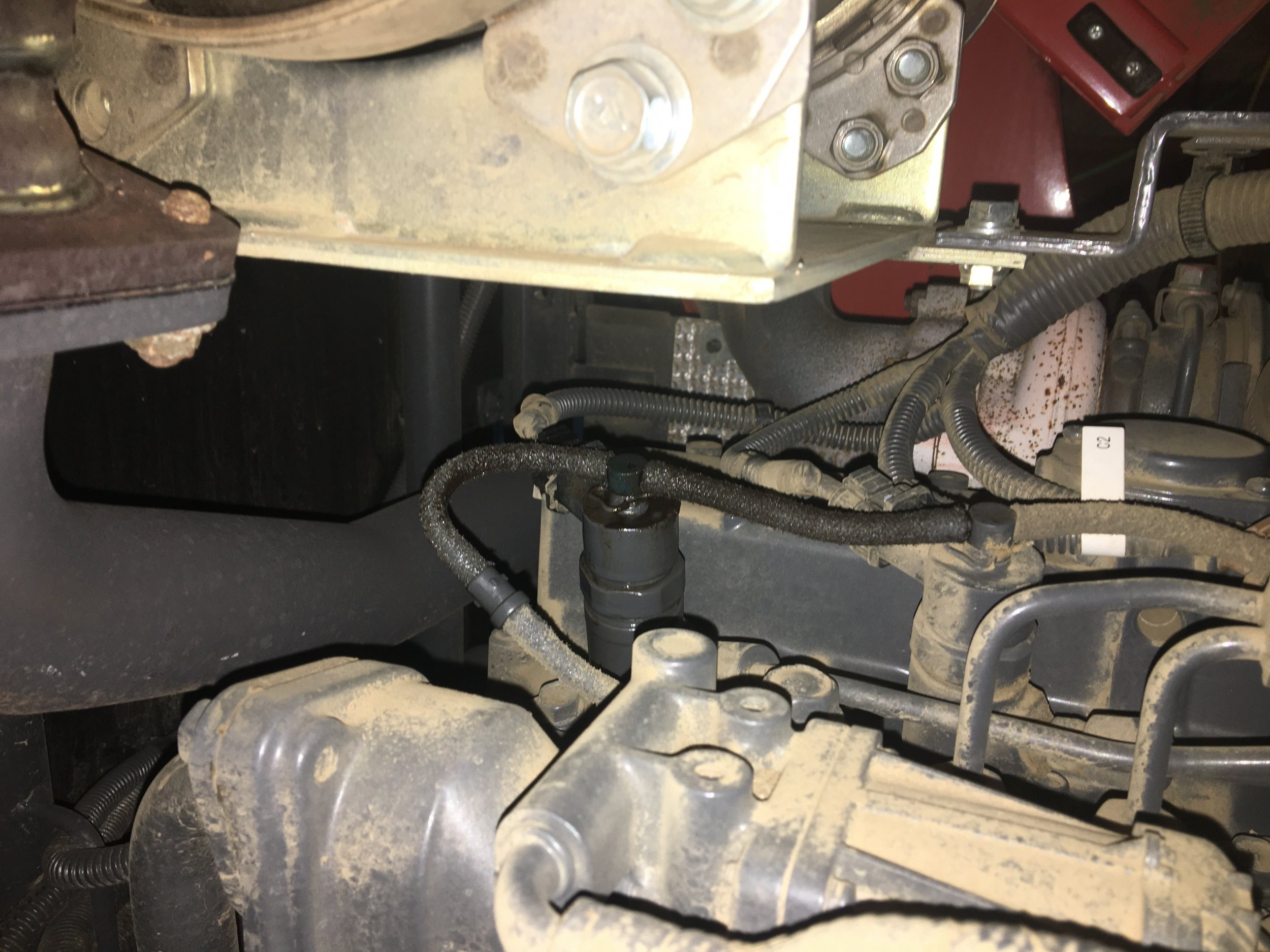

I agree and now something else rears its ugly head.
While looking for the GP's, to see how hard they will be to get at, in order to test their resistance, I noticed what appears to be a leaking fuel line or injector. At least I think this is an injector. That liquid on it is definitely diesel. I'm calling the dealer tomorrow to discuss this and the hard starting issue.
Fix the fuel leak first, that is also an air leak into the fuel system when the engine isn't running, the fuel tank is below the level of the visible leak. As the machine sets, air is allowed into the fuel system at that leak area, then when starting, the fuel system has to compress the air then bleed the air out before fuel pressure is high enough to actuate the injectors. Fix that first!
Maybe that was the knocking I was hearing, when trying to start it. Maybe the leaking injector was not yet adding fuel to the cylinder. I want to check with the dealer regarding what is covered under my current warranty. I don't want to be fooling around with something that is covered and then have them deny coverage because of something I did.
