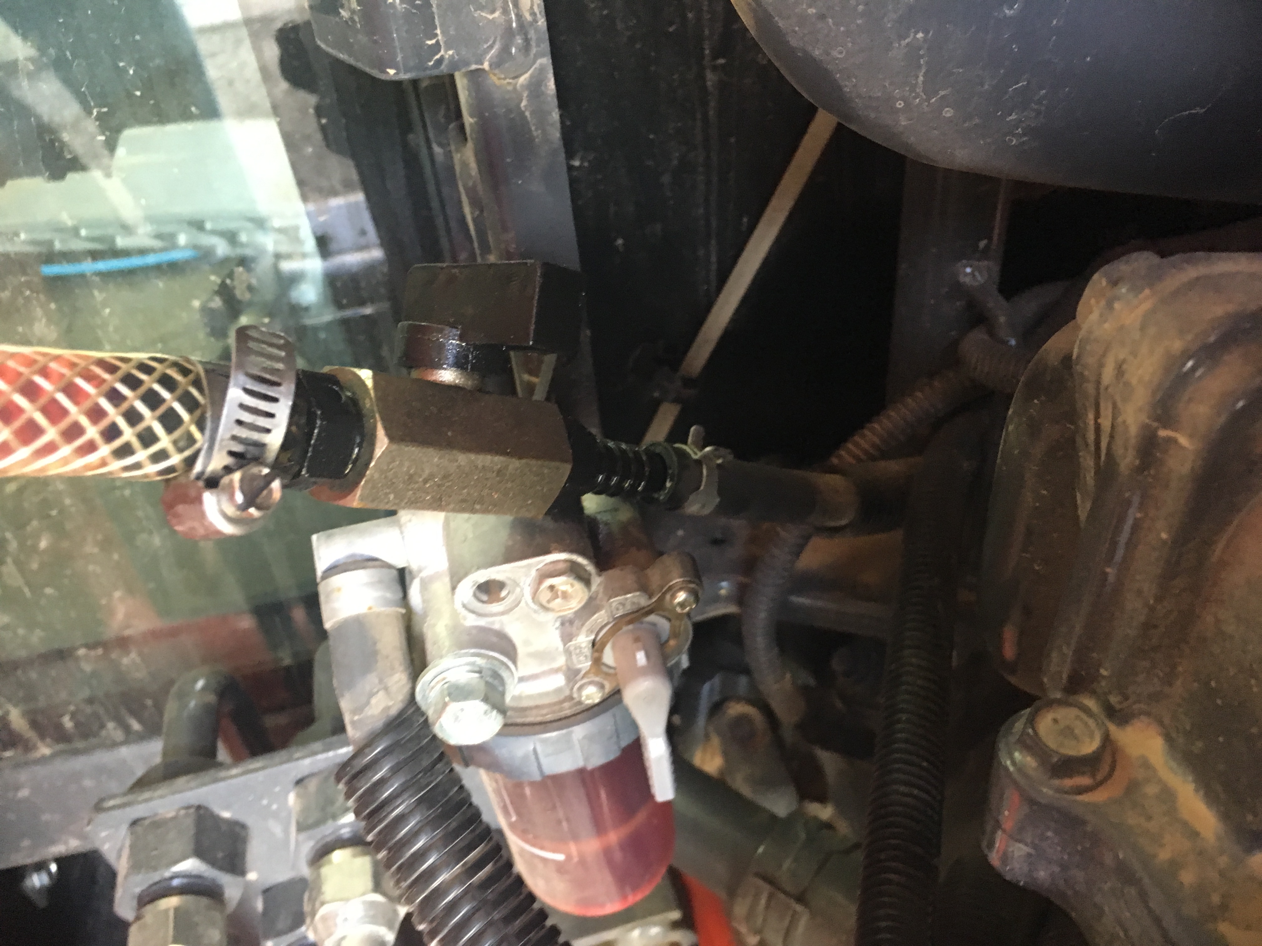

Was able to detect very low fuel fill by removing line after the electric pump (the one that goes into the check valve) and running with key on into a bucket. Suspected the electric pump but able to test that by removing the line from water separator to the fuel pump and putting that in a small container of clean diesel and retrying key on - ran fine, so issue clearly between tank and pump. Removed line into water separator from tank, loosened fuel cap and blew air through the line, can hear left hand tank vigourously bubbling as do so. Flow fine after that, reassembled system and worked flawlessly afterwards.

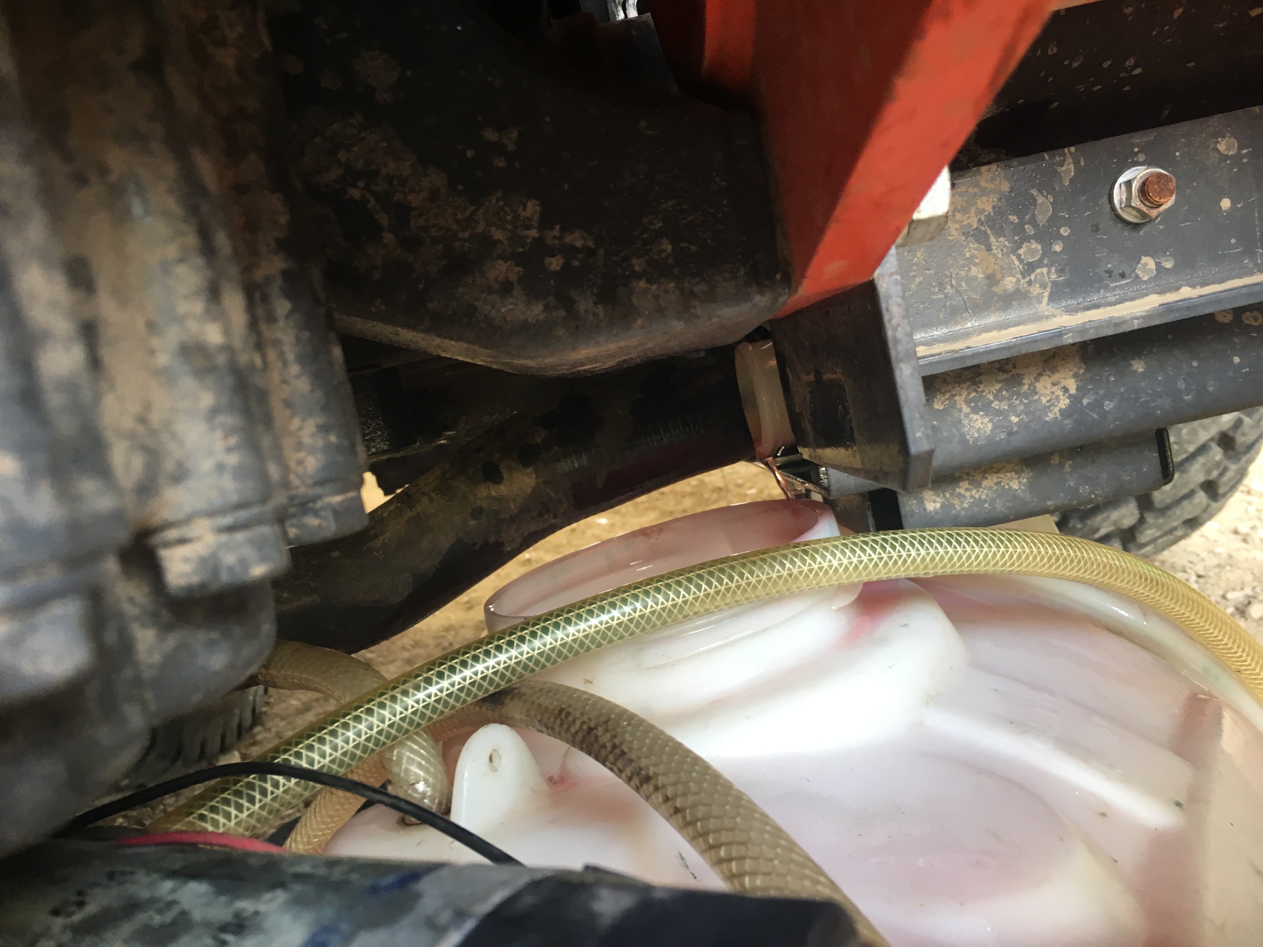

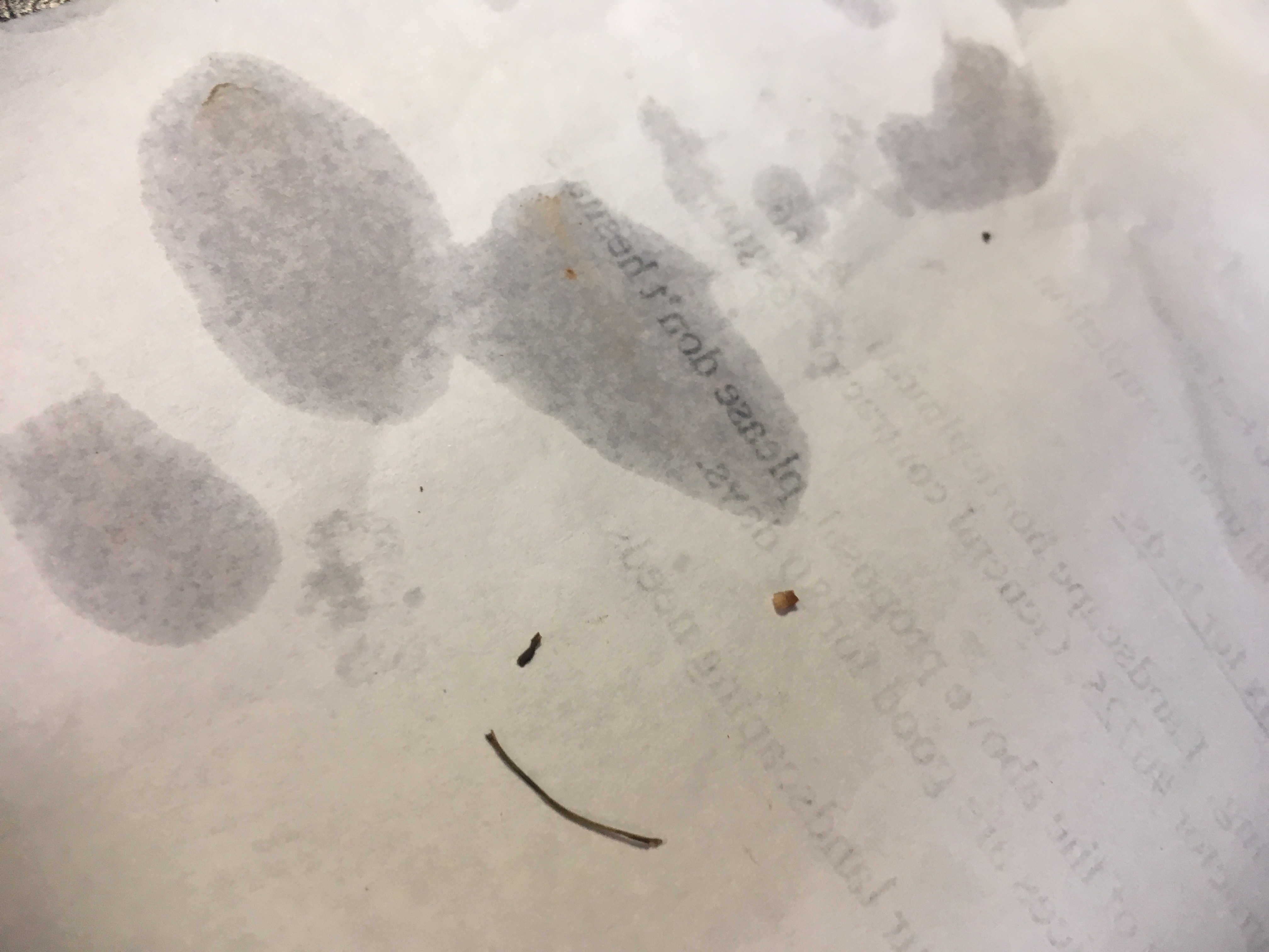

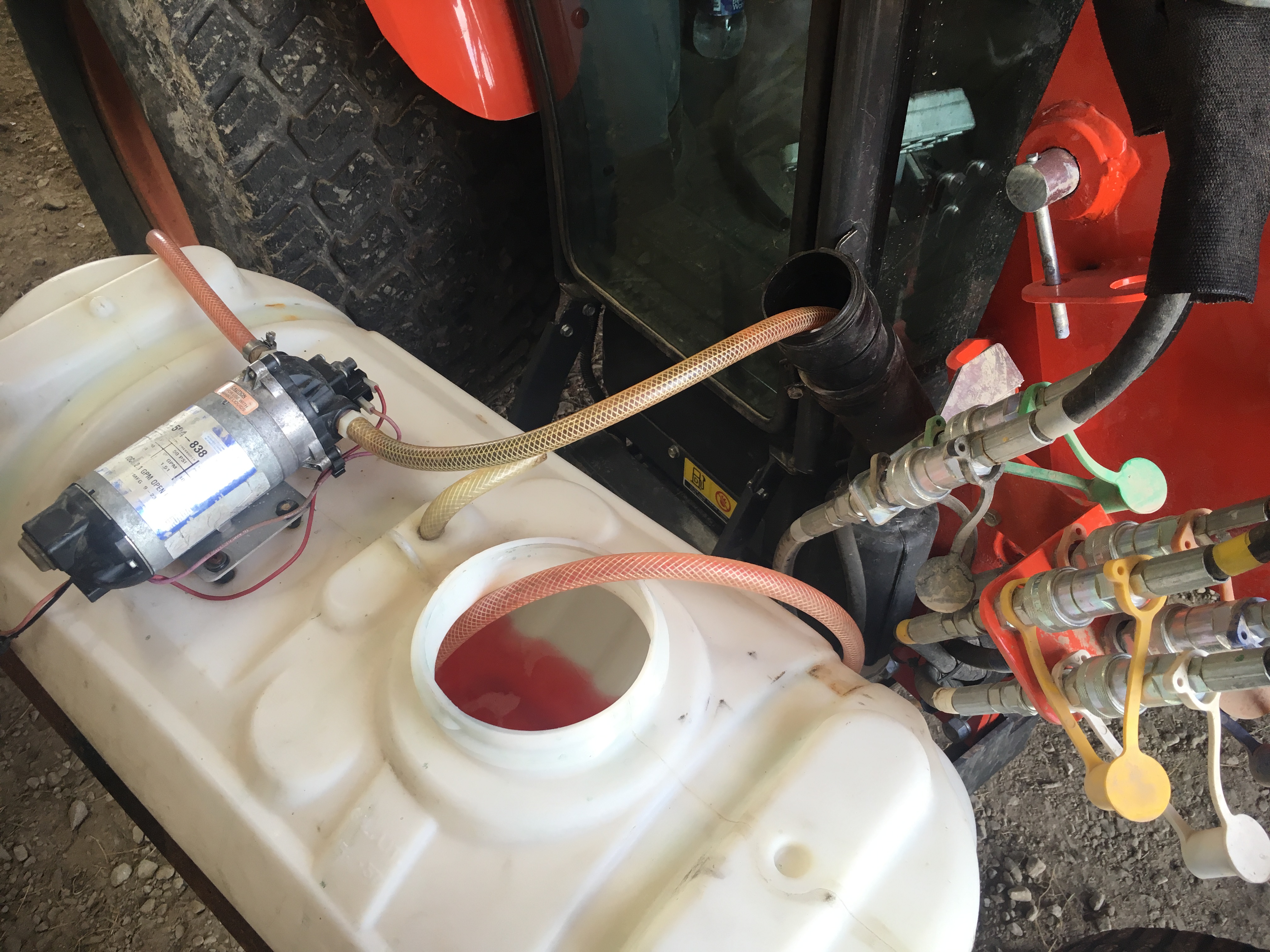

I was able to work on this project today. First, I found an old tank with a 12 volt pump on it. I cleaned it out and ran a little bit of old diesel through it. Then I stuck the suction into the right tank and sucked out what I could. I probably got 5 or 6 gallons out.

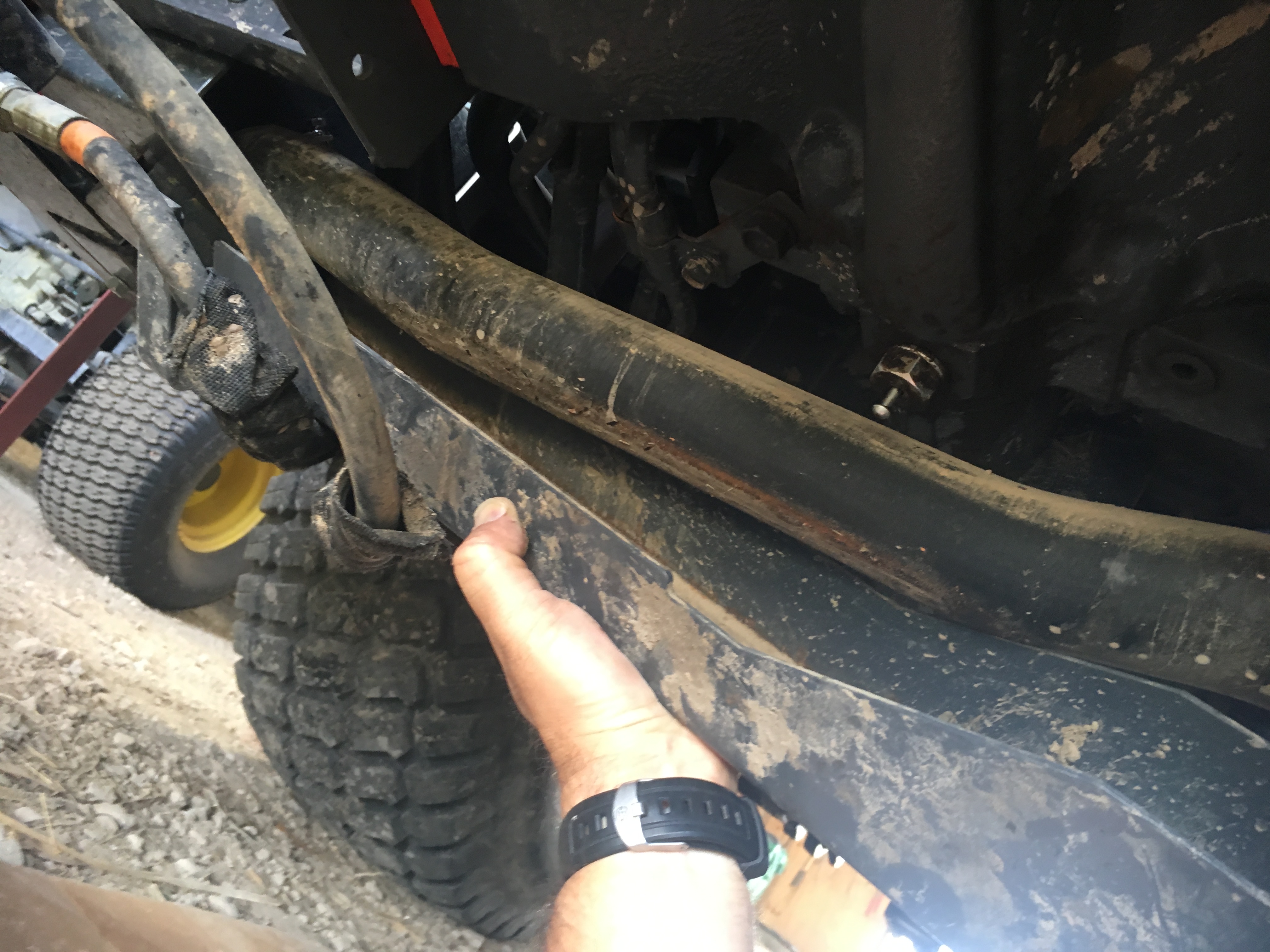

Then I removed the guard that protects the crossover hose that connects the left and right tanks.
Next, I slipped my old spray tank under where the crossover hose connects to the left tank. Remember, there is a check valve near the right tank that prevents fuel from moving from the left to the right tank, but it allows fuel to move from the right to the left. Then I slipped the hose off of the left tank and let it drain into my spray tank. This is where a little diesel spilled. I only got a few drops on my lips.....
Then I went to the water separator and blew air back into the left tank. This is what we had done to get the tractor running again. After blowing air, I ran some diesel back into the left tank from my spray tank. Actually, I did this twice.
View attachment 552225View attachment 552226

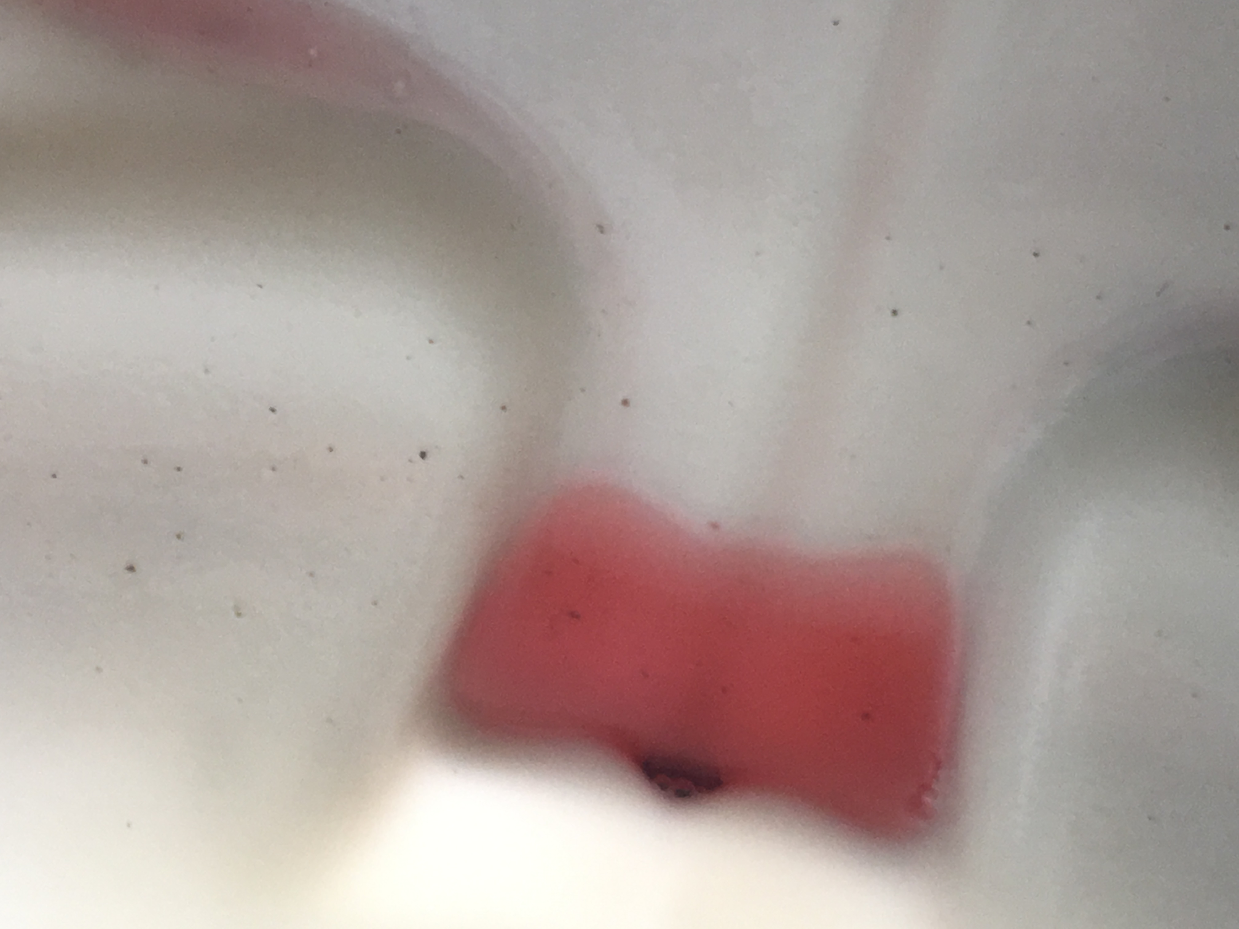

I also ran a bit of fuel through the right tank. I did stick a camera into the left tank while I had
