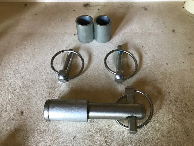

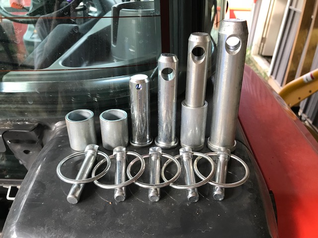

The tractor came with a variety of pins for the three point which no one explained what they were for.
Here is the low down. Here is what I received:
One setup of these is for cat 1 implements which has the bushings to go to the cat2 setup on the tractor:

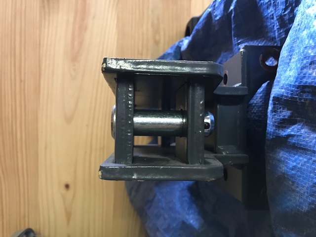

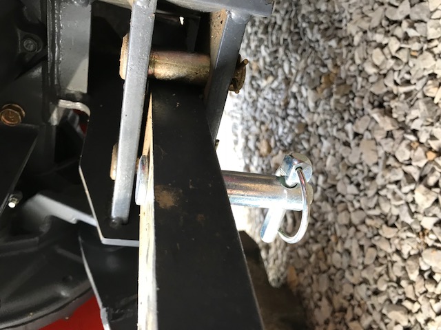

One pin is to hold the drawbar in (I have a swinging drawbar but the dealer gave me back the standard drawbar that came with the tractor, so here is what it looks like with that pin):
And one is for the implement on the drawbar:
The three point goes on very easy and should come off very easy. The BH92 was very simple to remove. I have not removed the LA1055 loader as I have no desire to ever do so.

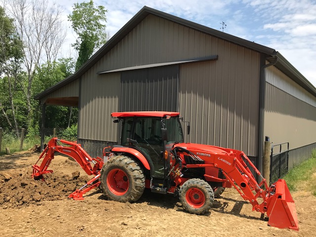

Here is one project with the backhoe, 2' ditch for french drain and gutter drain around my barn:
The ditch was so easy for the backhoe to dig. It was very quick to get my gutter drains done with it.
Here is another picture with the backhoe on that project:

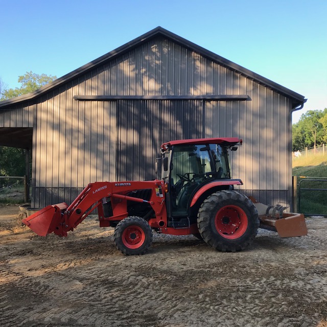

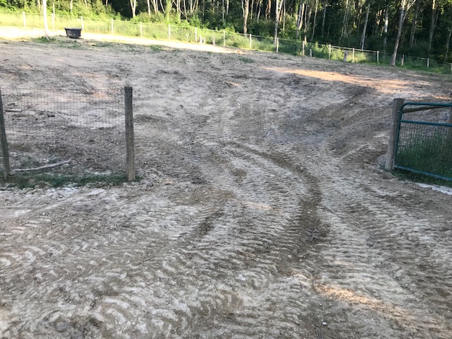

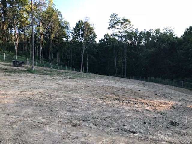

And this is my latest box blade project:
I did a lot of leveling in the pasture but more importantly had to make the water drain towards the french drain ditch I put in a couple months ago. Prior to doing all this the ground was just full of hoof prints, and when it rained it was a slosh mud mess that took literally over 2 weeks to dry. I am hoping I got the slope correct this time to get things draining towards the french drain I just put in. I expect I'll have more work to do later but I need to determine how the water flows in the next rain.
