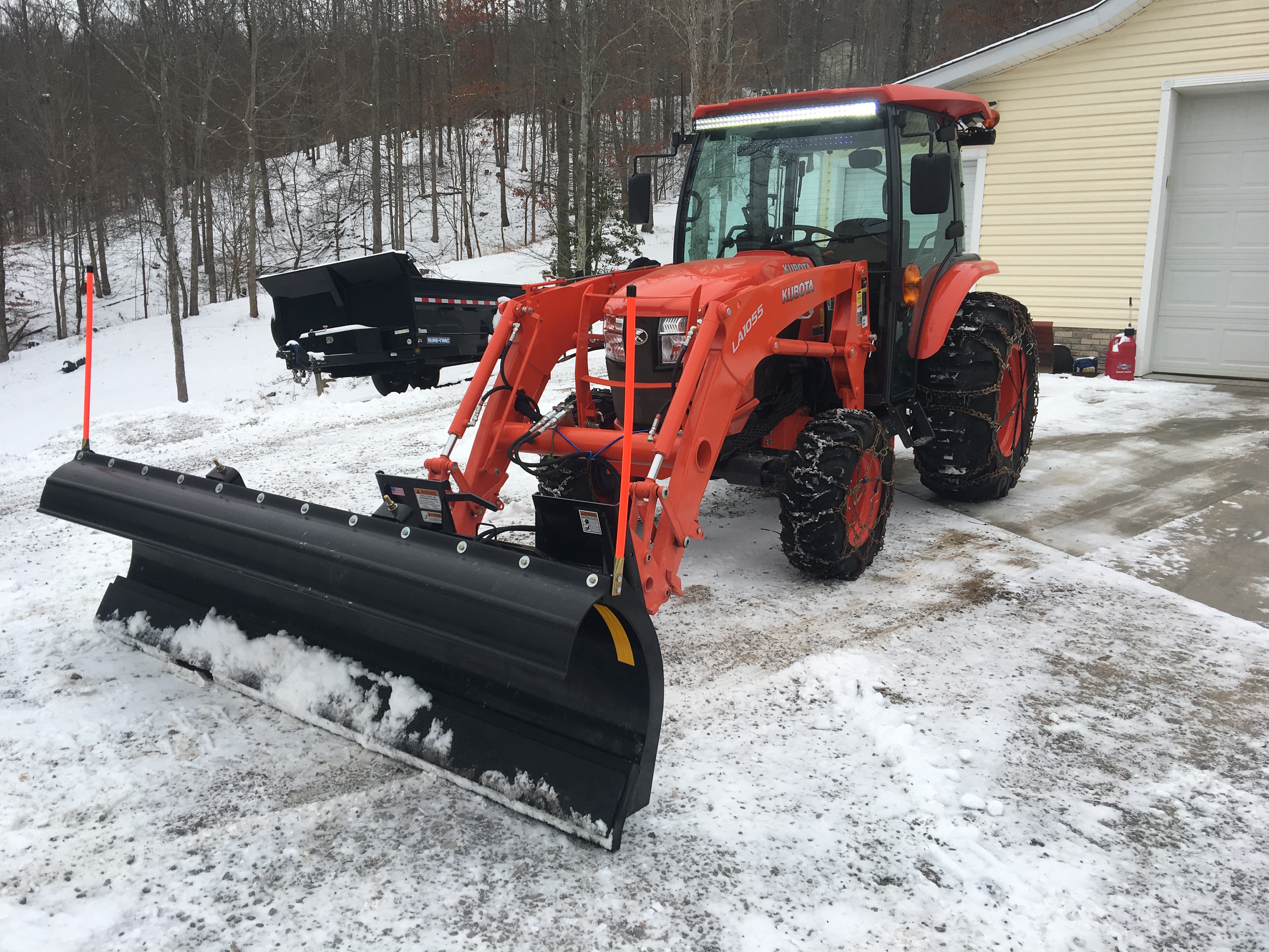

I plowed some today with mine and am so-far very pleased as well......
The only thing I wish this tractor had was more than one speed on the windshield wiper, I'm going to try to figure out a way to remedy that, years ago you could buy a box that installed on the windshield wipers in cars to accomplish this but since all cars now come with this option I doubt it's readily available anymore...
Interesting, I could see that as an issue. I haven’t had to use the wipers yet as it stopped snowing by the time I was off work.
I love the front plow setup you have. That looks very convenient.

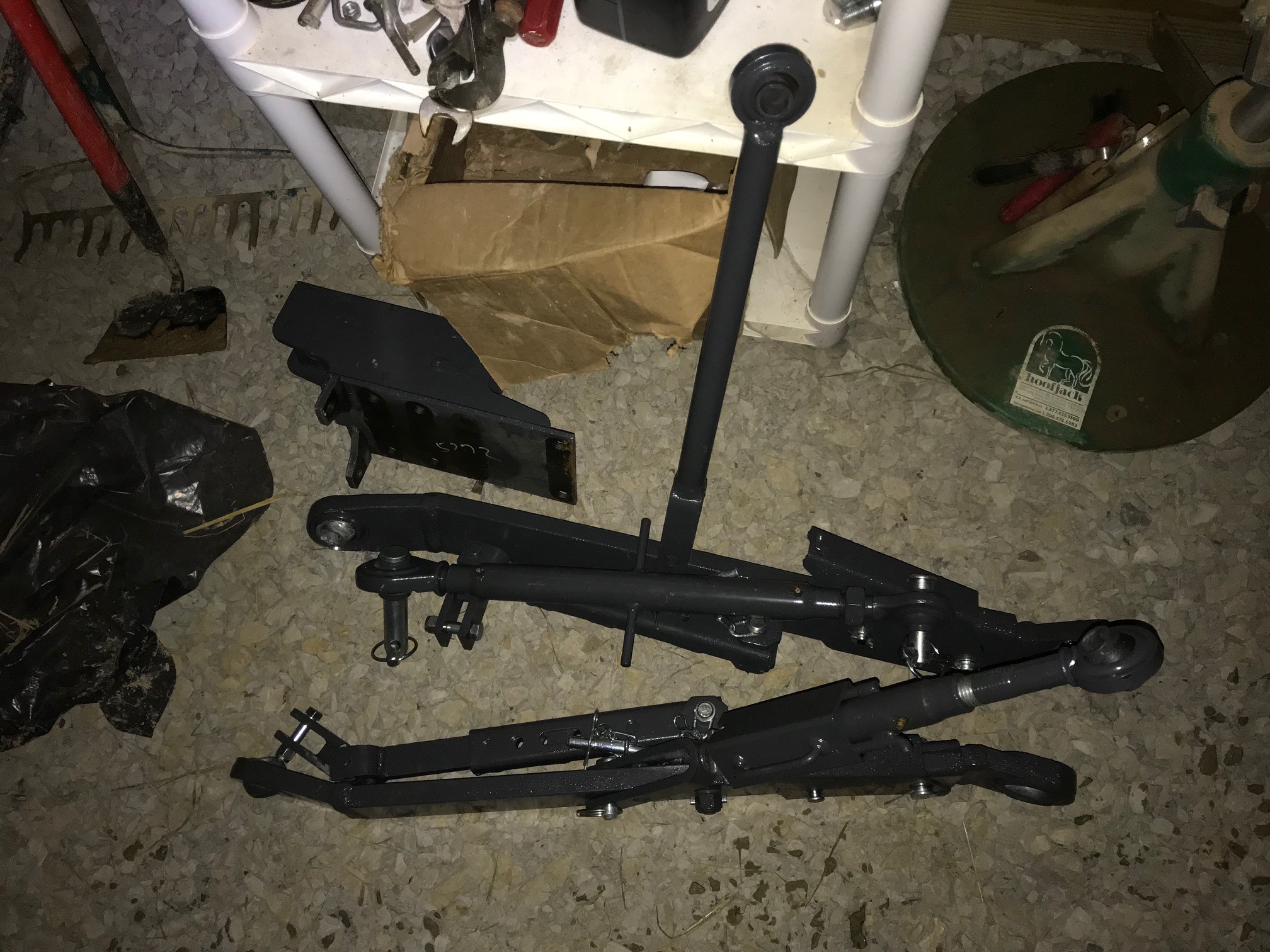

I also haven't figured out all the three point pieces. I haven't removed the backhoe yet as it is supposed to go back to the dealer Monday to install the defogger switch and for them to look over a few other minor things I have pointed out in this thread. It looks like the three point system needs wrenches to install. If so I am somewhat disappointed in this because I figured it would be faster to install and uninstall, as everyone raves how easy it is to remove and install the backhoe.
I have three pins I have not quite figured out. I think the fourth one is a cat II top link pin which I inserted into the top link so I didn't lose it. These other three pins I haven't figured out what they are for yet.
And here are the lift arm pieces:
I think when it comes back from the dealer next time I may drop the hoe and try to figure it all out. My concern is if I have all the parts I need so I don't go to use my blade and realize I can't work until I get the correct parts.

Regen starts at 100%. The leftmost switch on the left side (sorry don't have the manual handy) needs to be on to allow regen. I don't know if there is a way to trigger regeneration early. I usually go 12-18 engine hours between region cycles. Interestingly, plowing the last 13 inch storm caused the PM reading to decrease without regeneration. Can't help on pins or three point arms as mine haven't been off. Maybe a cat 1 toplink pin and cat 1 to 2 bushing?
