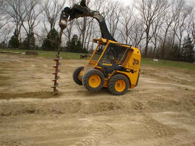

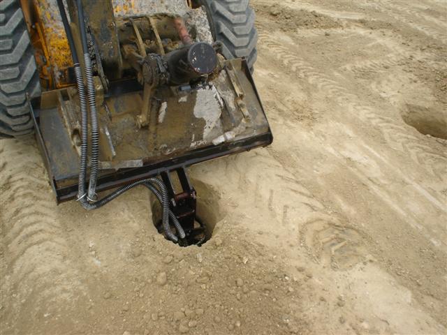

There are fifty four interior piers that had to be drilled along with thirty two piers in the perimeter beam. I originally started with drilling with my standard twelve inch bit and extension. This gets me down eight feet. The bit is Pengo and very aggressive. This is handy because in the sandy loam we have chunks of limestone. Some of the limestone is relatively soft for stone and some of it's rather hard for limestone.
I drilled most of the exterior piers down to eight feet and some of the interior when I realized just how big a problem removing the tailings or spoils was going to be. So I put on a borrowed twelve inch auger on my extension that allowed to get to ten feet deep.
