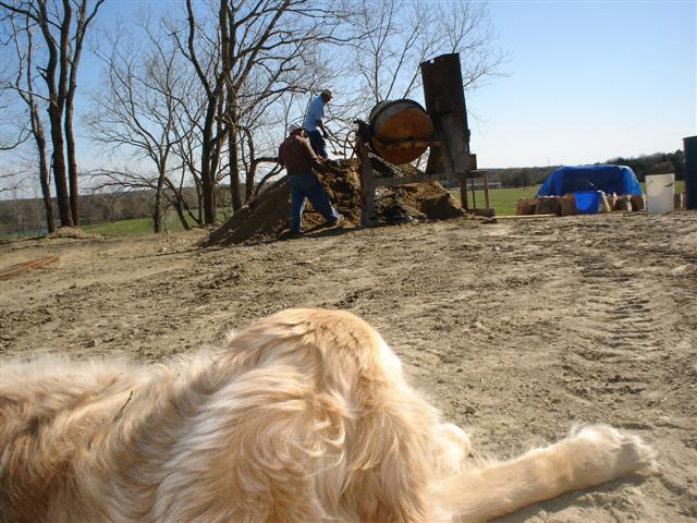

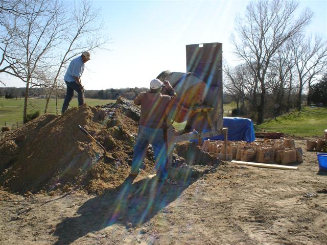

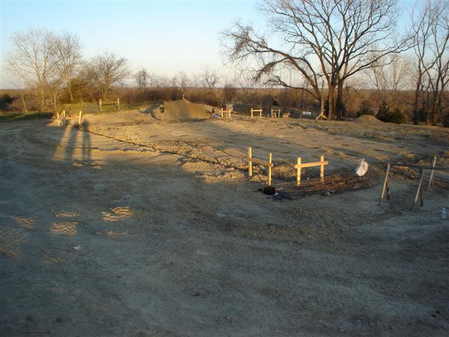

Anyone who knows me knows me what the first picture is all about. The second picture is from an observer with a critical eye's perspective.
The third picture reflects the end of a good day. That pile of tailings from the pier holes is getting it's due.

Great pics Harvey!!
With piers that deep, there should never be any movement in the foundation. Is that how they are building homes in that area? I've heard of them going down over 30 feet for homes on a hill in California, but I've never seen anybody do that deep here in Texas.

EDDIE I'm a Bayarea contr. we usually go around 20 ft. + with 18" dia. hole.
6- 10 ft. into rock. sonatube NEVER below ground! We get an additional 1000 lbs.per ft.carrying cap. from side friction. Geos. on every jobs. There great teachers. Another great harvey project. Love those horses
