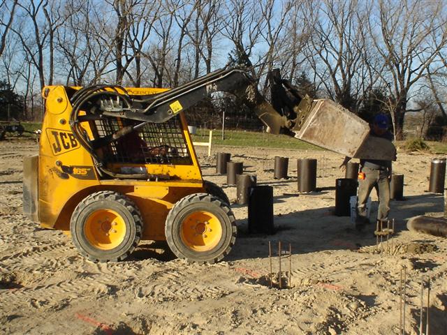

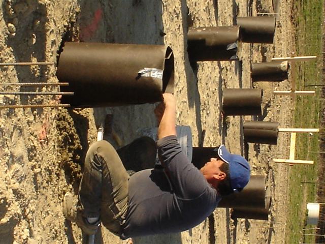

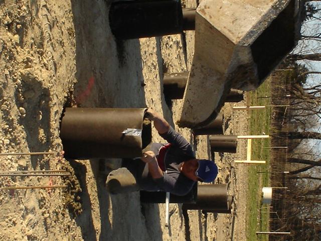

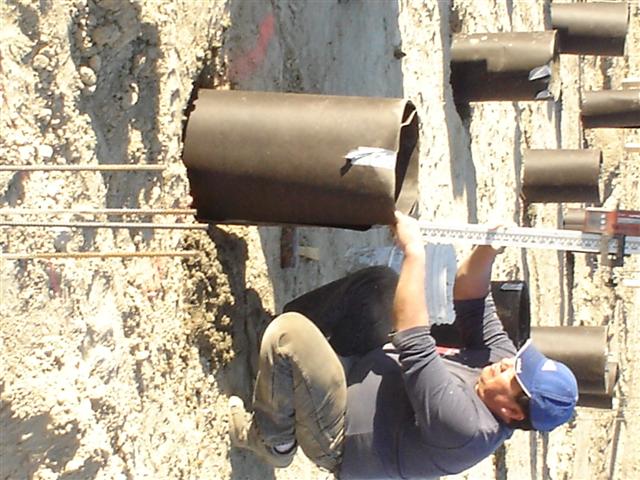

Hmmmm, I've been asleep at the wheel evidently. I've let this thread die and it doesn't deserve that kind of treatment.

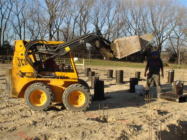

Here's some shots of the piers poured with the roofing felt instead of sonotube tubes.
All total we used fifty yards of concrete to fill all the piers.
The felt tubes worked perfectly. By the time we reached the end we were using only small pieces of duct tape on the tops to hold the shape full of concrete.
The way it would work is I'd fill the pier hole to almost grade. Then we'd put the felt tube in place. Using the lazer level we'd shoot final grade and make it with a nail through the felt wall. We'd then fill the tube to that mark.
Nothing but a thing, as they say in France I hear.

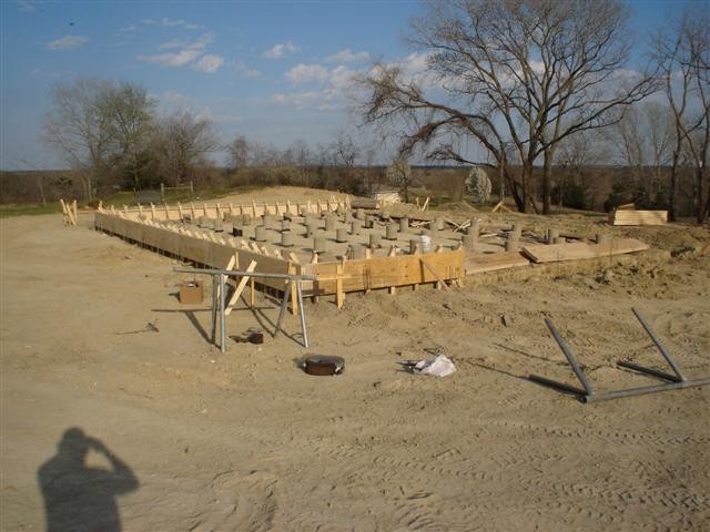

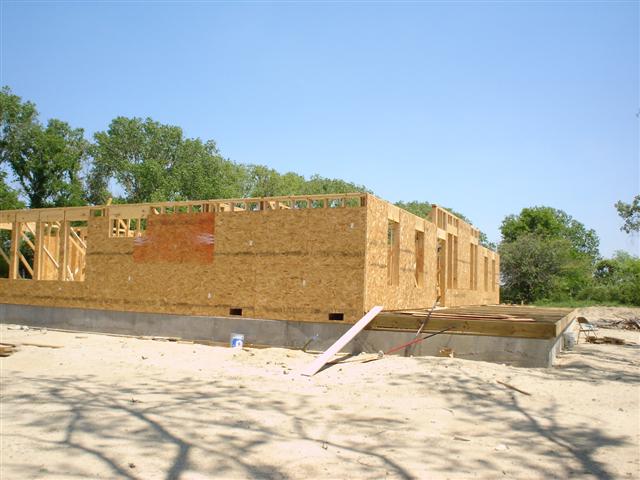

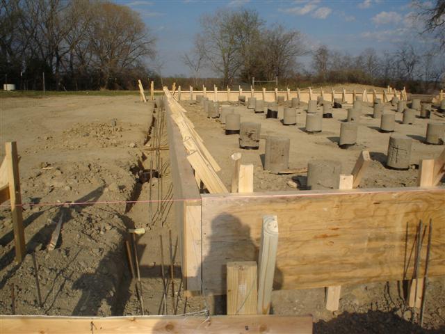

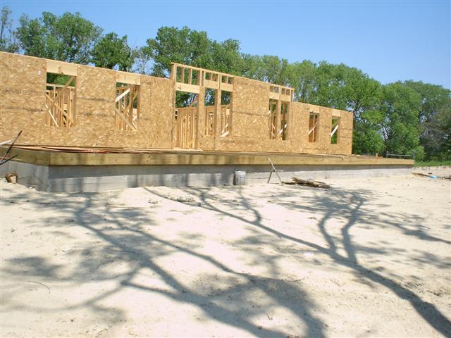

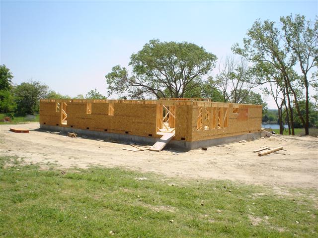

Once we had all the piers complete it was decided due to time constraints to have the professionals come in and form up the grade beams and handle the pour.
I wasn't back on the job until my services were required again.
The framers had the ground floor complete.

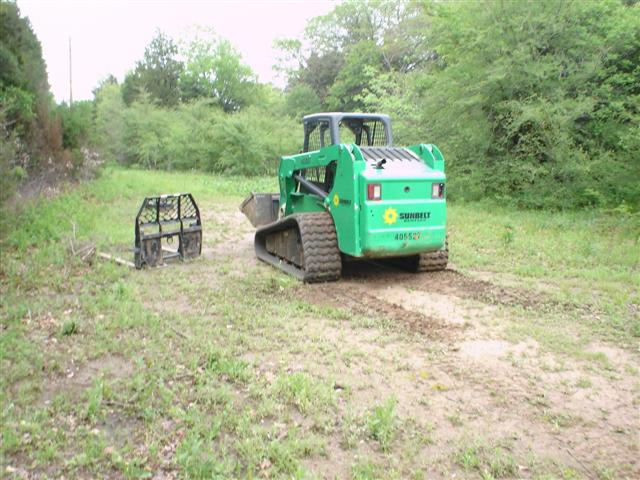

The reason I was called was the builder was in a little bit of a bind. The company that had agreed to go into the timber lease and bring out the cedar logs along with milling them into beams and planks had pulled out of the deal.
I was asked if I could bring out the logs if they were on the ground in the lease and already de-limbed.
Nothing but a thing as they say over there.

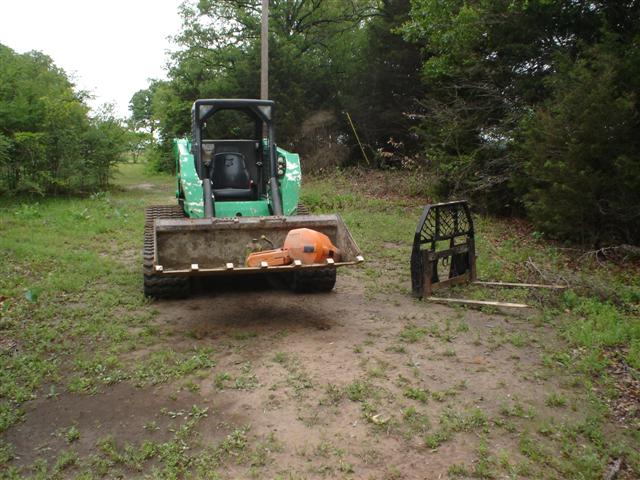

We rented a Bobcat T250. That's a tracked ten thousand pound approximately skid steer. It's a hoss.
The reason we needed tracks is it's sandy loam bottom land with seeps and the only thing more of than poison ivy is places to get stuck.

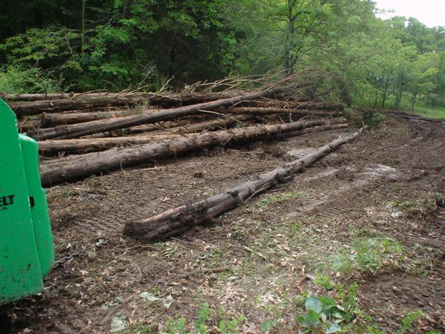

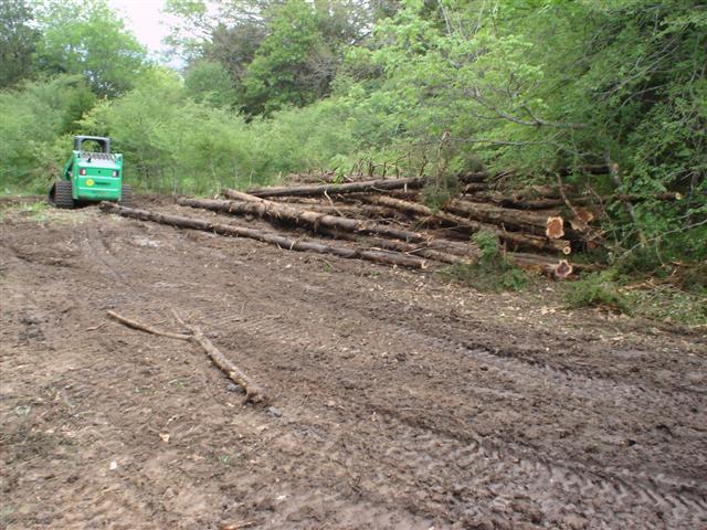

As some on TBN might have guessed by now I like a challenge.
We had challenges.

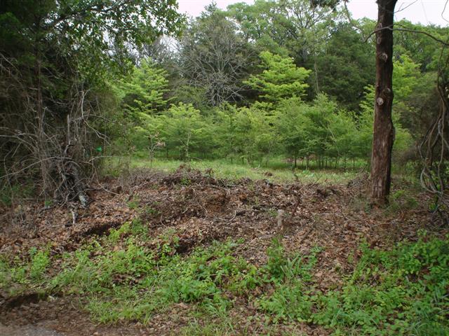

First was access. A county road about one and a quarter lanes wide with bar ditches on both sides just begging for tires to swallow, especially if they're attached to a red truck named Lucy.
I had one opening in the fence/tree line. It was about eighteen feet wide and was for utility company access. Inside of the tree/fence line I had a staging area to bring in the logs.

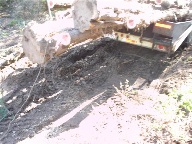

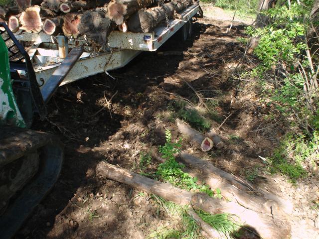

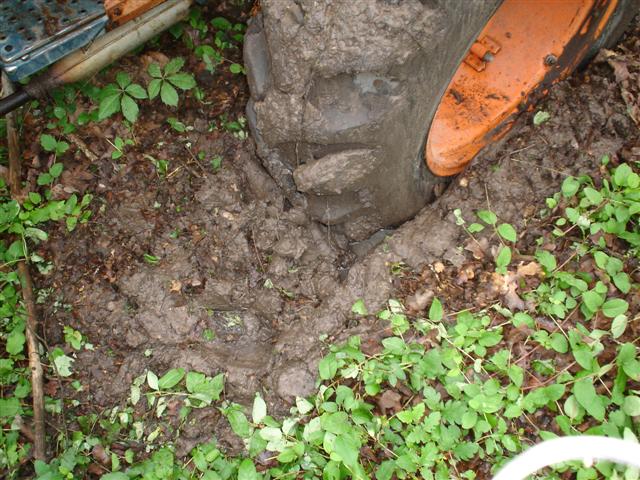

It was interesting. Except for one and a half days I was all alone with the tractor, the chainsaw for trimming and the woods. I made all the trails trying to keep them down to a minimum.
Last evening I faced the real problem with working by myself long days and no one expecting me home until well after dark. About five or so in the evening while trying to find logs de-limbed I came upon a clearing one thicket away. I put the forks up at an angle for breaking through the thicket and charged on through. About half way in an arm sized cedar limb stabbed the back wall of the tractor about six inches off from my neck. I never saw it coming. I guess it was like one of those walking into a tree limb when it's in that blind spot between your eyes and the hat brim.
Cedar lower limbs die off as the tree grows upwards. Dry cedar doesn't bend, it shatters. This was a sharp ended broken piece still attached to a tree. A little to the right and they'd been looking for an old man in a tractor in woods after dark. In woods that are easy to get lost in during the daytime.
I belive that was either number eight or number nine. I can't remember which. I'm sure it makes a difference.
I learned how to put a track back on by myself. It happened twice. The first time I called Sunbelt and told them I needed to talk to a good mechanic. I asked him to walk me through it because I didn't have time for him to come and find me. I was out in the woods and the only thing harder than him walking in would be me giving him directions on where to walk to.
I've decided the smartest SOB on the face of the earth is the guy/gal that invented the grease gun tensioning device for adjusting the tracks. He/she is one sharp cookie.

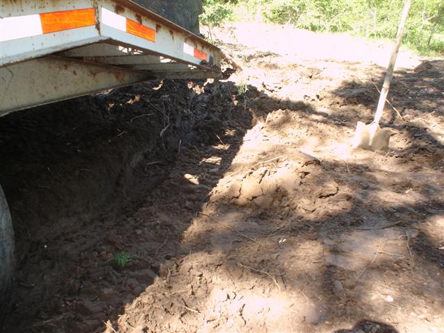

I also got it stuck. Something I thought could never happen. I buried it bigtime. But I got it out without using the cell phone.
The way it worked was I'd pull in front of the opening in the tree/fence line and drop the trailer. Using the trackloader I'd manuever the trailer into the clearing for loading. When it was loaded I'd use the trackloader to manuever the trailer out on to the road and down to an intersection. There I'd turn it around so I could hook it up to the truck. The alternative would be to back out almost a half of a mile with a couple of nineties to make it interesting.
