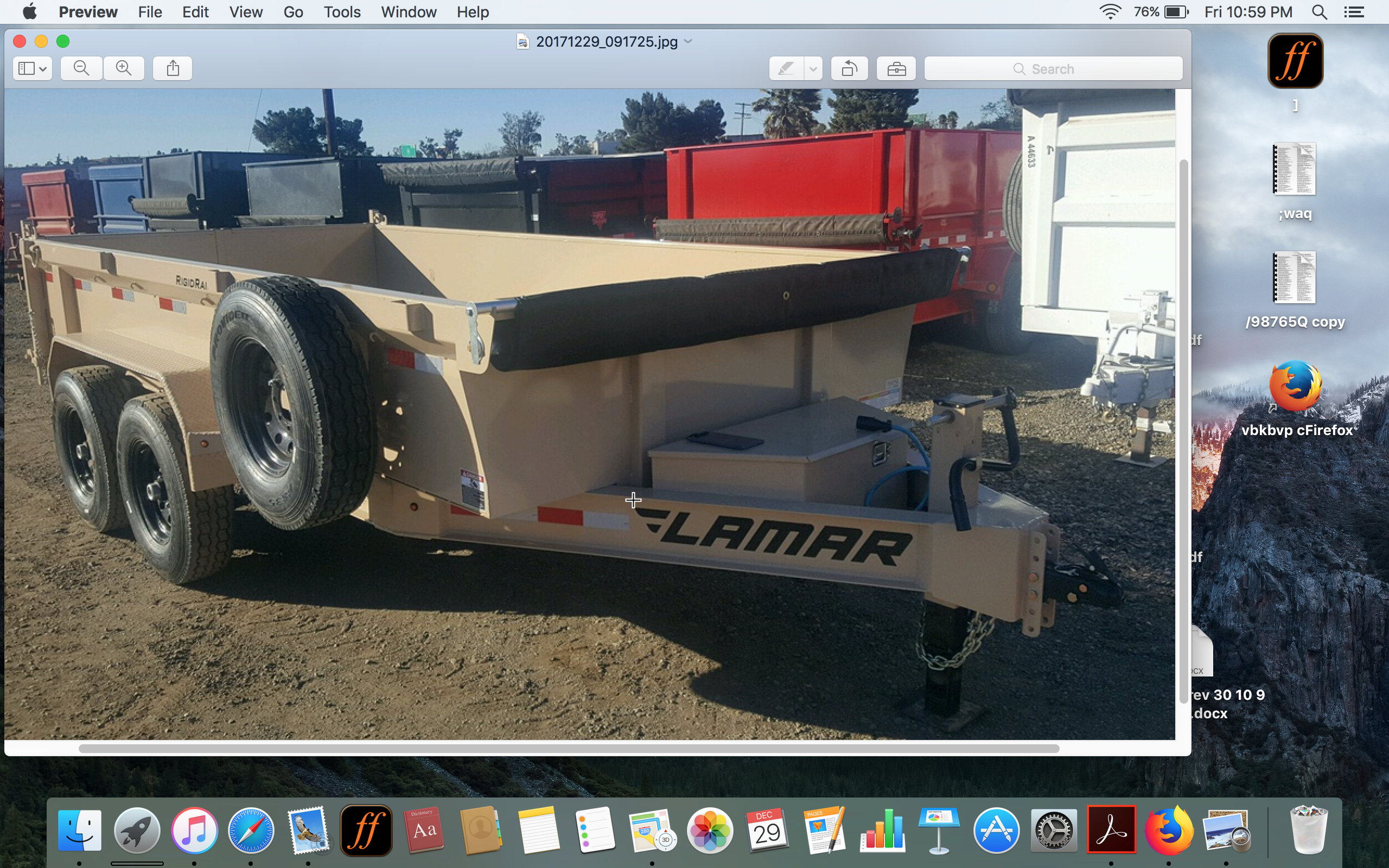

Headed south in a few days to pick up this new Lamar dump Trailer.

Very nice. Looks like something the military would use.

Looks well built. What plans do you have for it?

Lots of rocks. Logs,brush, bark,chips, soil,road base,sand, garbage, and other assorted waste. My Kubota can also be hauled when needed. I'm anxious to get it dirty.
This Lamar replaces my two year old PJ lo pro. The PJ, I'm sorry to say was built an "off day" at the factory, and my concerns were totally ignored by the dealer, and PJ Trailers.

Well......didn't work out too well. Drove the 680 miles each way to pickup trailer. Observed right away the deck height was higher than 24". They neglected to build with drop axles. No way I could use the trailer as my L47 TLB has 1" of clearance loading with 24" deck height.
They did have another 14' with drop axles which I agreed to take. Switched out the 10ply tires for 14's, completed paperwork and made the journey back home.
Got home only to discover the tongue length on the LAMAR dump trailers is only 36" compared to the PJ's 4' 10". I need the longer tongue for increased turning radius with loader and bucket extended/curled up, over the front of trailer.
After talking to the dealer and LAMAR, everyone agreed the trailer does not fit my needs and they will refund my cash payment, minus 4%. Another $500 in fuel/hotel costs and the original $1400 savings is eroded.
The dealer did compensate me $300 for the mistake, so it's on the auction block for $8800 for a $125 loss and a hard lesson learned.

Well that stinks. Didn’t think about it till I looked at the pics and after you said something but the front of the Lamar is stubby, probably good for overall maneuverability as it cuts down the length but no good if your hanging a bucket over.
I’m sure you know your machine but I’ve found lifting the dump up a bit can decrease the breakover angle and make loading a bit easier.
Sorry about your troubles, makes me hope I got my measurements right on mine.

The folks at LAMAR Trailers are building me a trailer with a 5' tongue. In addition they are adding a couple of extra goodies to the trailer. And to top it off they are splitting the cost of my travel expenses running up and down the interstate. Needless to say, I'm most satisfied, and appreciative.
