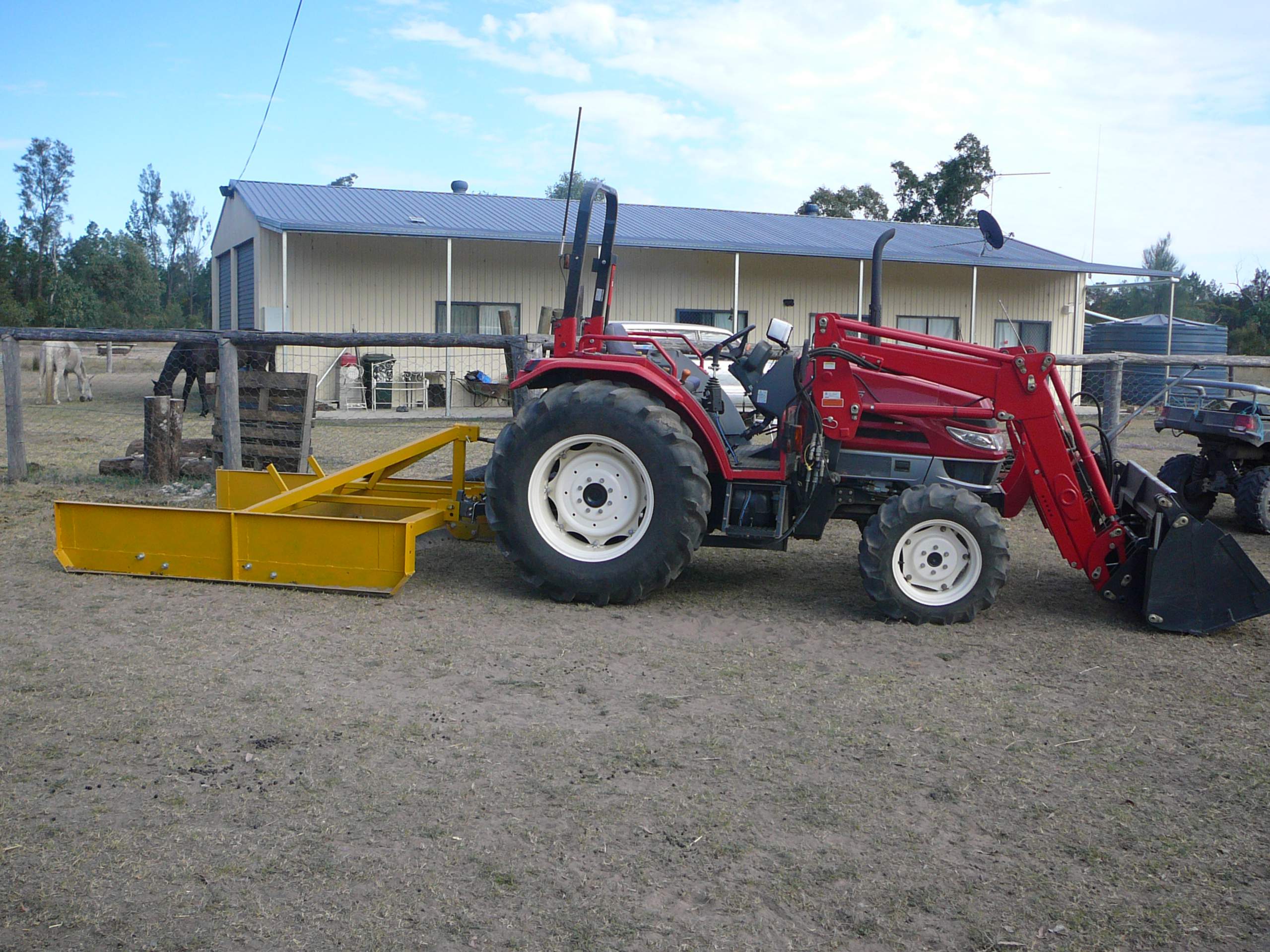

Hi Jimbob, the cutting edges are 2 position adjustable. The front blade can be 3/8" (10mm) or 3/4" (20mm) below skids and the back blade 3/8" down or level with skids and are on a 20% angle left to right with 2' gap between blades. I don't have a gravel road to grade only sandy soil ( at the moment) so I hope that will work as I haven't used it yet, tomorrows job. If not I just have to drill new holes to adjust differently.

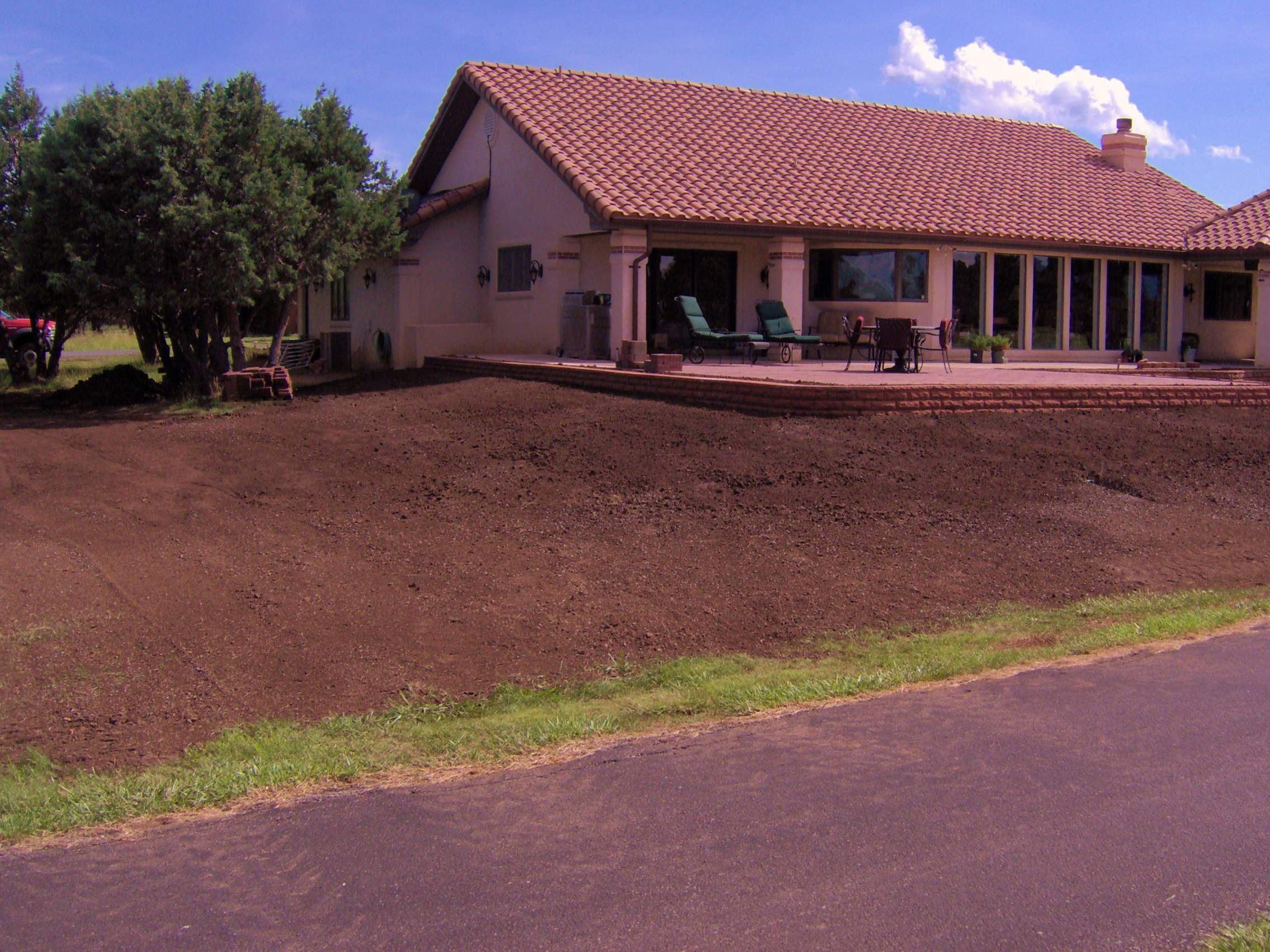

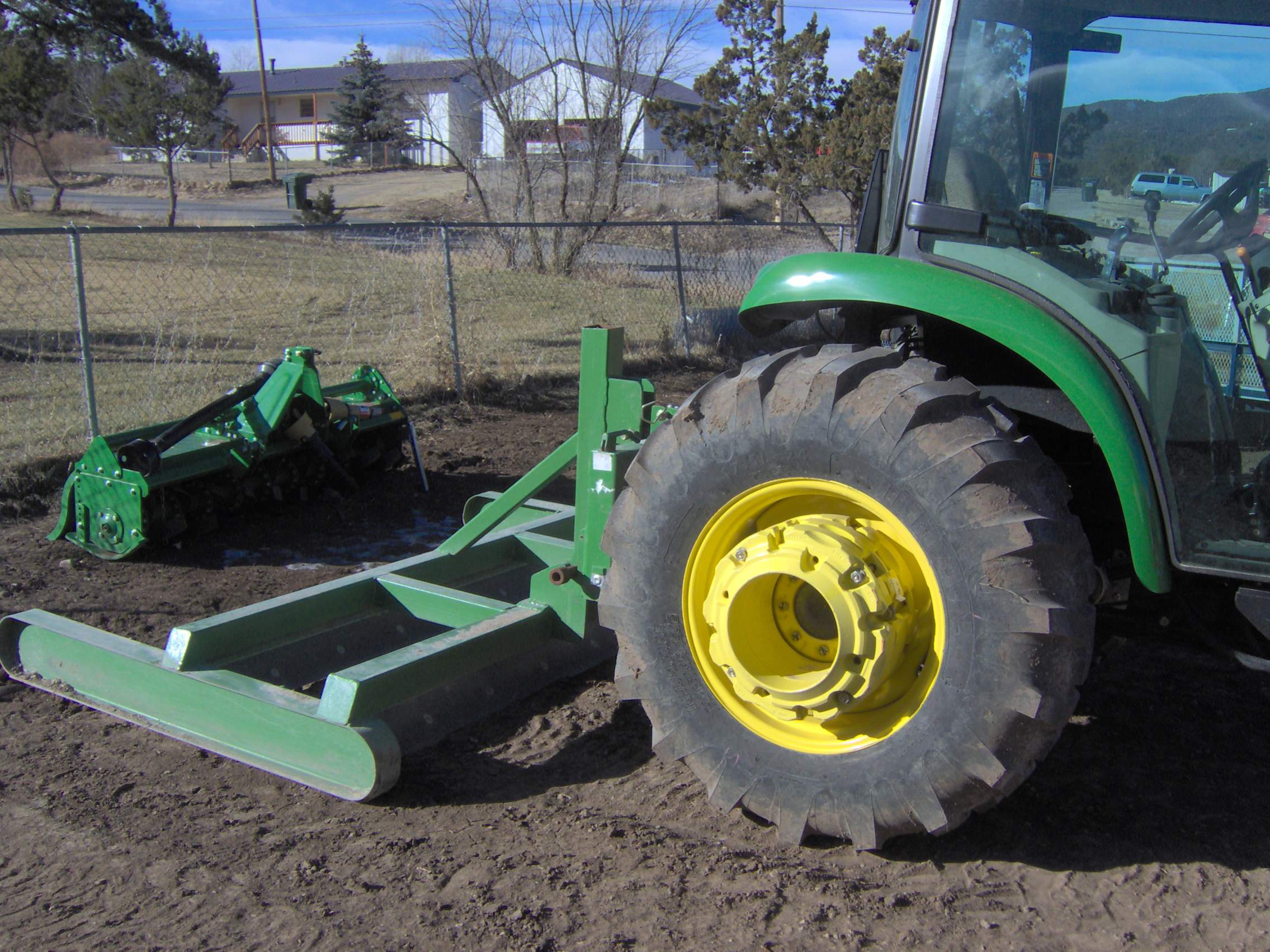

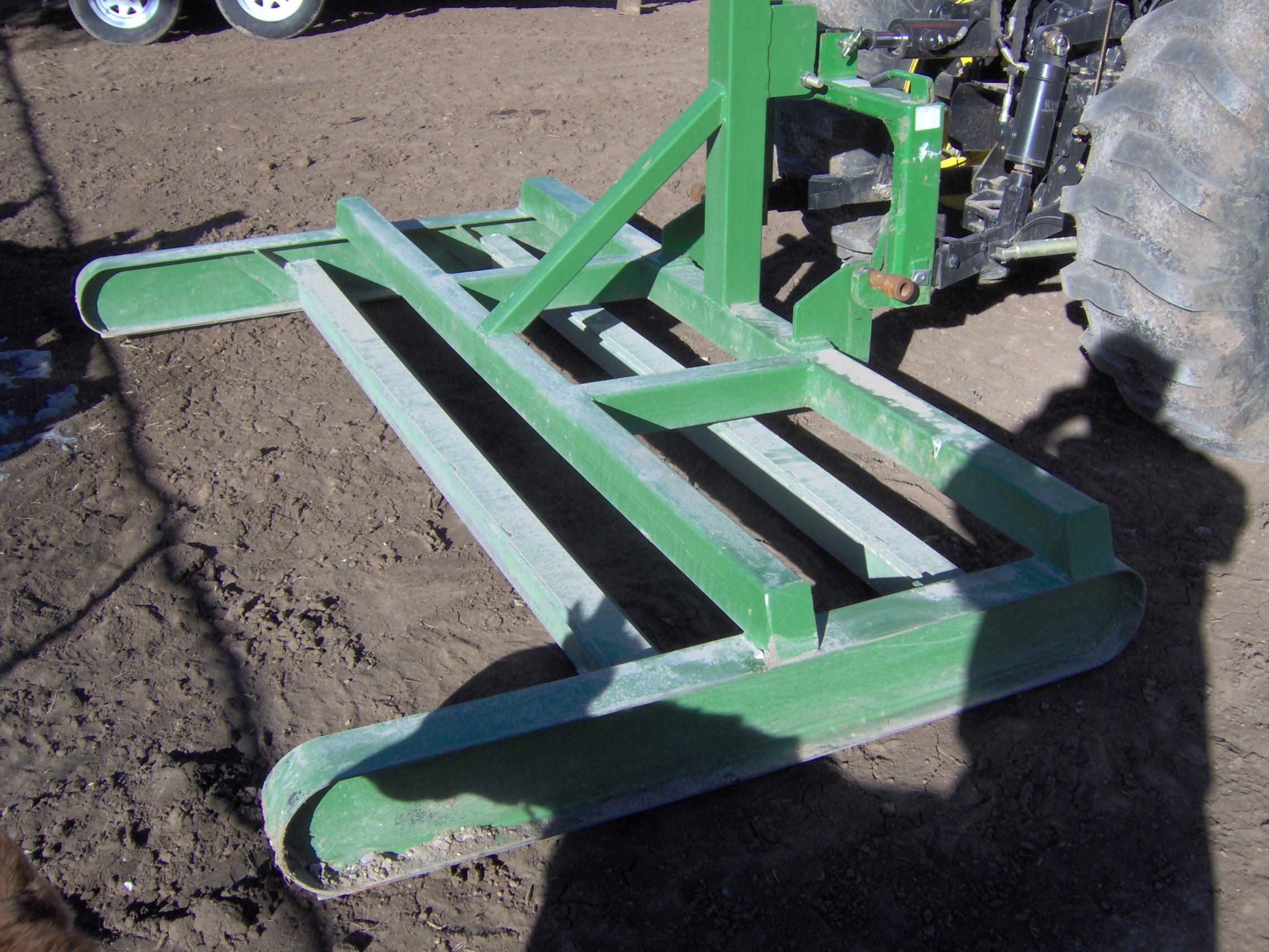

I use my land plane primarily for lawn and pasture smoothing and maybe 5% of my work is gravel driveway work. I find that setting the blades straight and even with the skids works the best. The sheer weight of the land plane will enable it to cut enough for smoothing out a field.
Here are pictures of my larger land plane I built in 2009 and a few pics of jobs I used it on including my rear lawn. Really helps smooth up the ground.

I was going to put both blades level with the skids at first but most advised that some cutting was required?? Any way drilling two more holes is all that is required to make the front blade level. I am just about to take it out and use it so we'll see. I have a driveway of 1 mile and lots of tracks that need work also. It will get lots of work as the kids cut up the tracks with the motorbikes and quads, little buggers, but gives me an excuse to need these toys:D

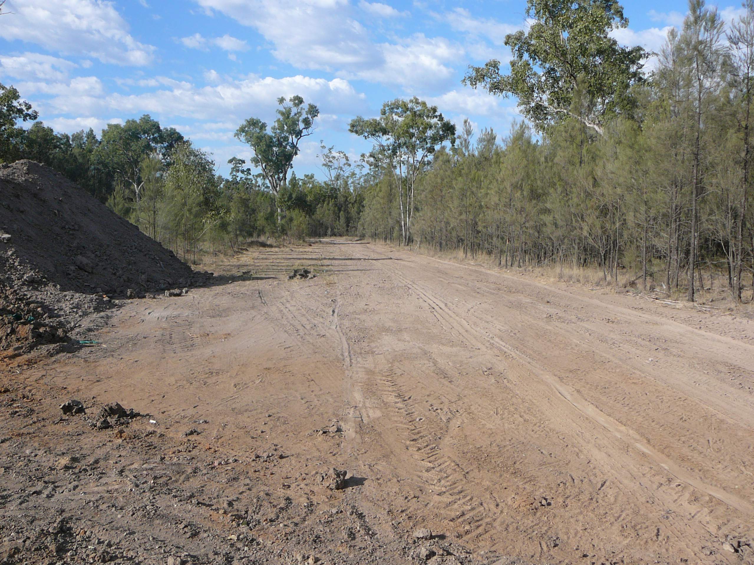

just finished about 4 hours on the tractor using the land plain. Works well, I thought at 8' long I would be able to use chain top link and just let it find it own level but not the case, as the front blade digs and cuts (at 10mm down) it has a tendency to lift the back so I had to use the solid top link to keep the back down. Didn't use the extra weight of the water drum, that may help with keeping the back down if I used a chair again but I didn't need to adjust the linkage much so I think I will just leave it this way.
Did a good job, this is a small section of one of the tracks
I found that after a couple of passes cutting then a pass in reverse smooths out the soil really well.

unfortunately it doesn't rain nearly enough. Australia is a very dry country and we are in the middle of a drought at the moment. Check out our dry looking photos. Our crap soil doesn't take rain well. It is bottomless after a big rain and goes to powder when regularly driven on in the dry. Makes for a very dusty job when using the land plain in the dry so I agree, it would be nice to orgainise the rain to come just at the right time and just enough to make it workable. Can you organise this for me, I would really appreciate it :laughing:

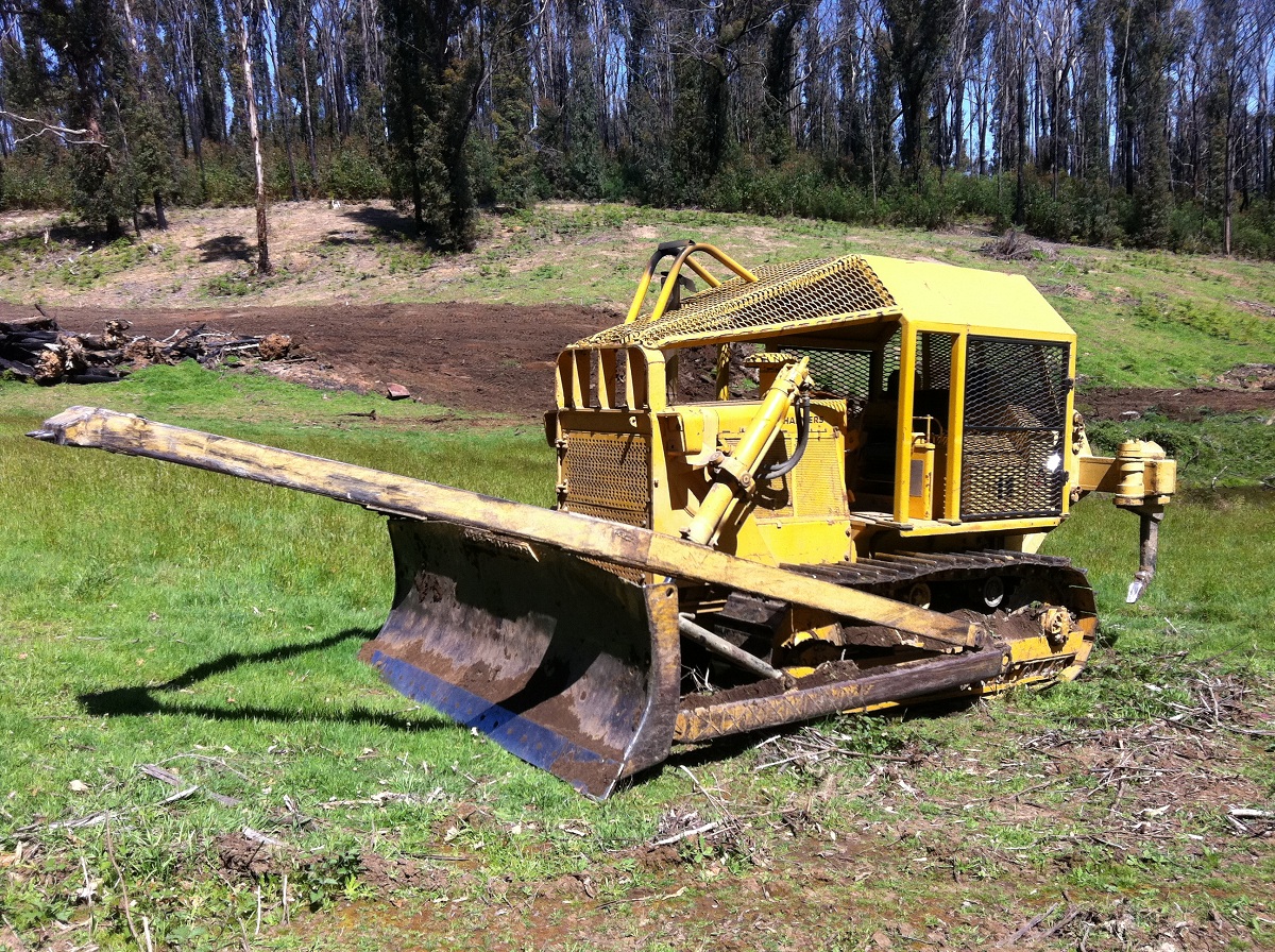

To answer your questions about my add on's, Not sure if our names may not be what you call them in the US. I have a 5' slasher (3pl PTO cuts grass) and a 5' grader blade ( 3pl back blade) listed but not a 5' slasher blade?? That would be a big *** slasher to spin a 5' blade:D. Jibb is just a lifting arm that attaches to the 3pl like a crane. The tree pusher, or tree spear is an heavy "A" frame that attaches to and above the dozer blade to push high on a tree to push it over. It normally has about a 3' toothed or spiked front that digs into the tree trunk so it doesn't slip off. Hope this answers your question. I do understand that this is not something that is common in the US for some reason?? I don't have a pic of my dozer with the spear attached so I have attached a pic of one I found on google to show you what I am talking about. You need a very solidly made canopy above your head to use this as large branches commonly come crashing down on top of you when you push over trees, we call them "widow makers"
