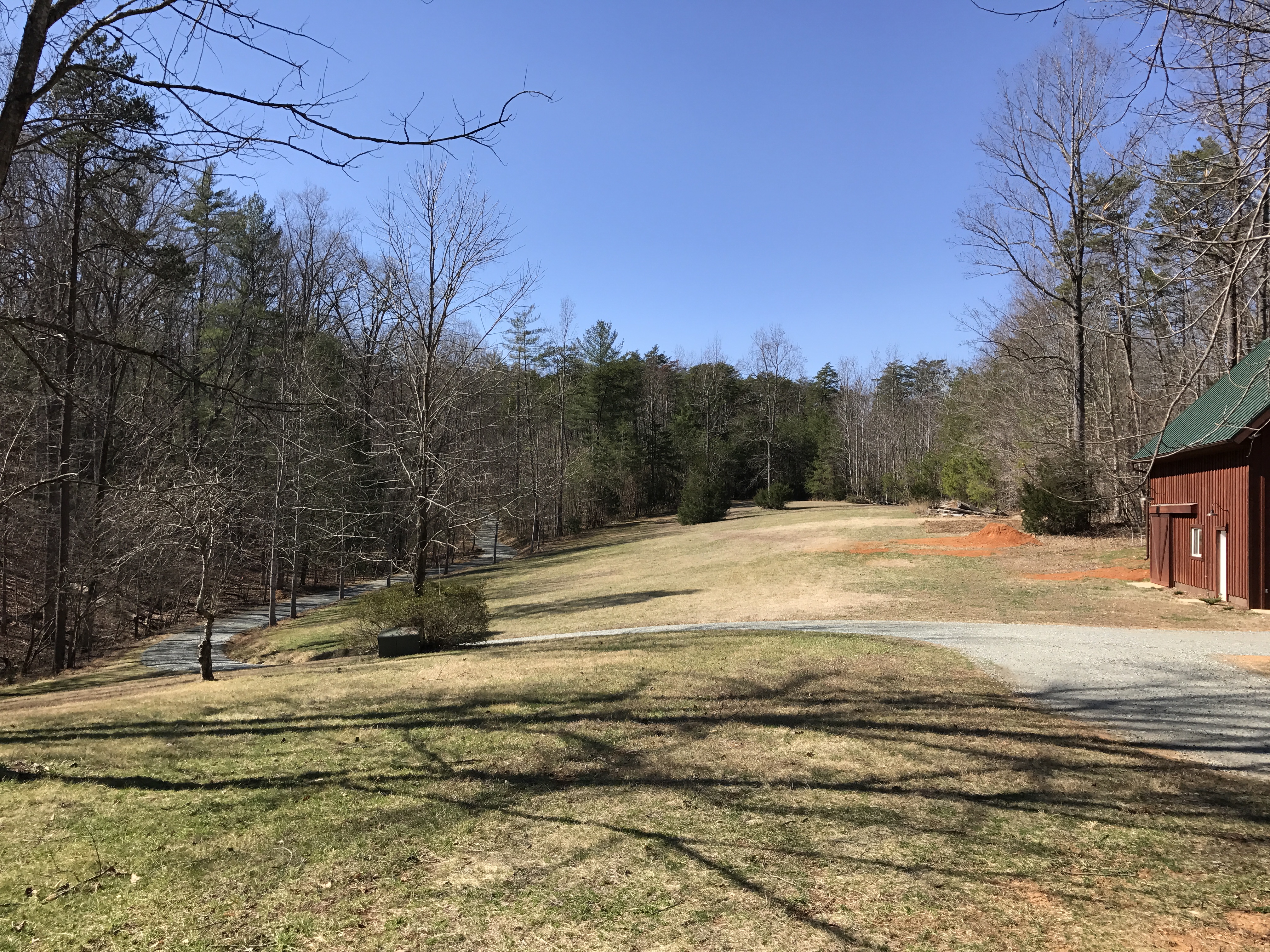

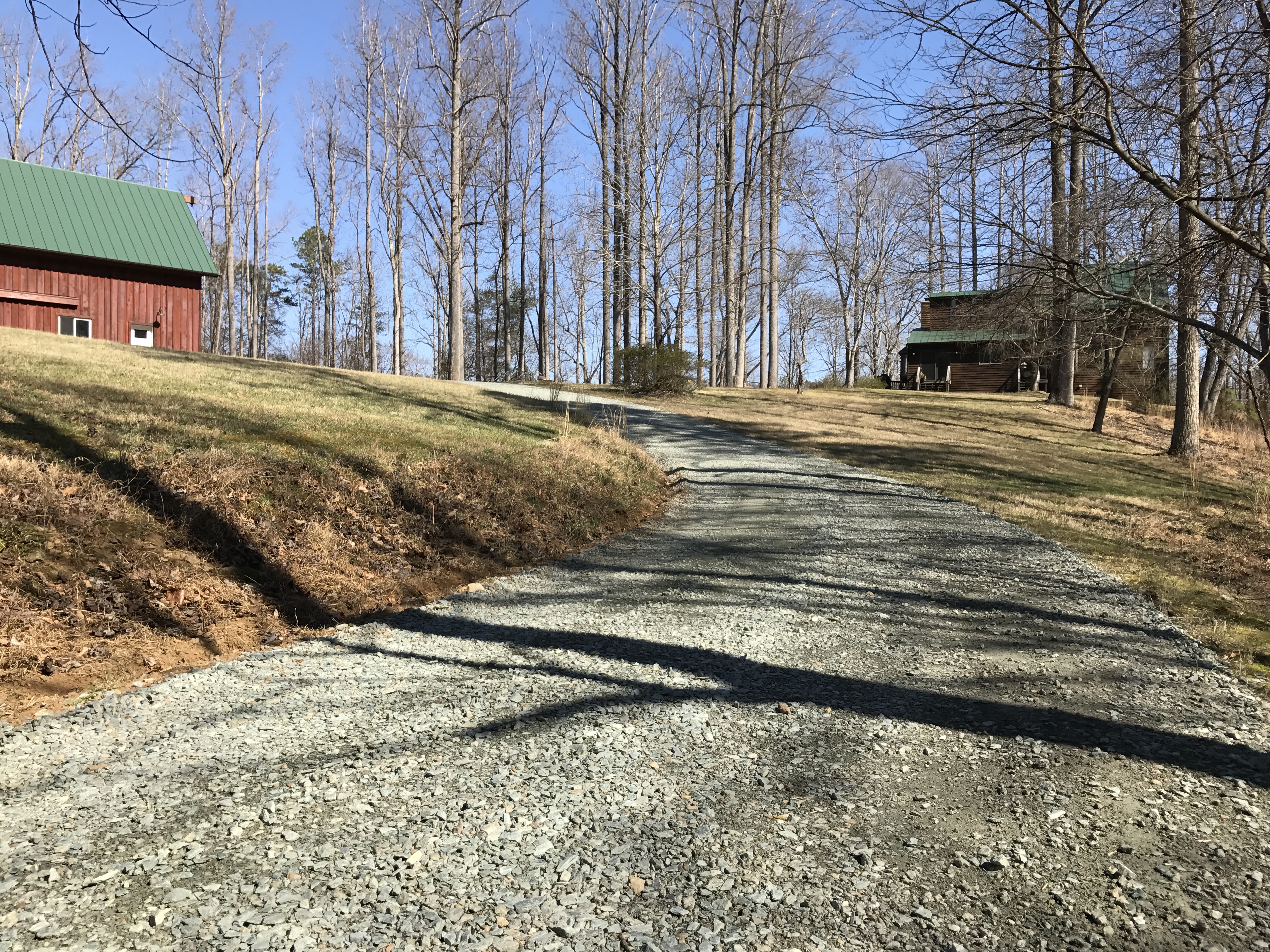

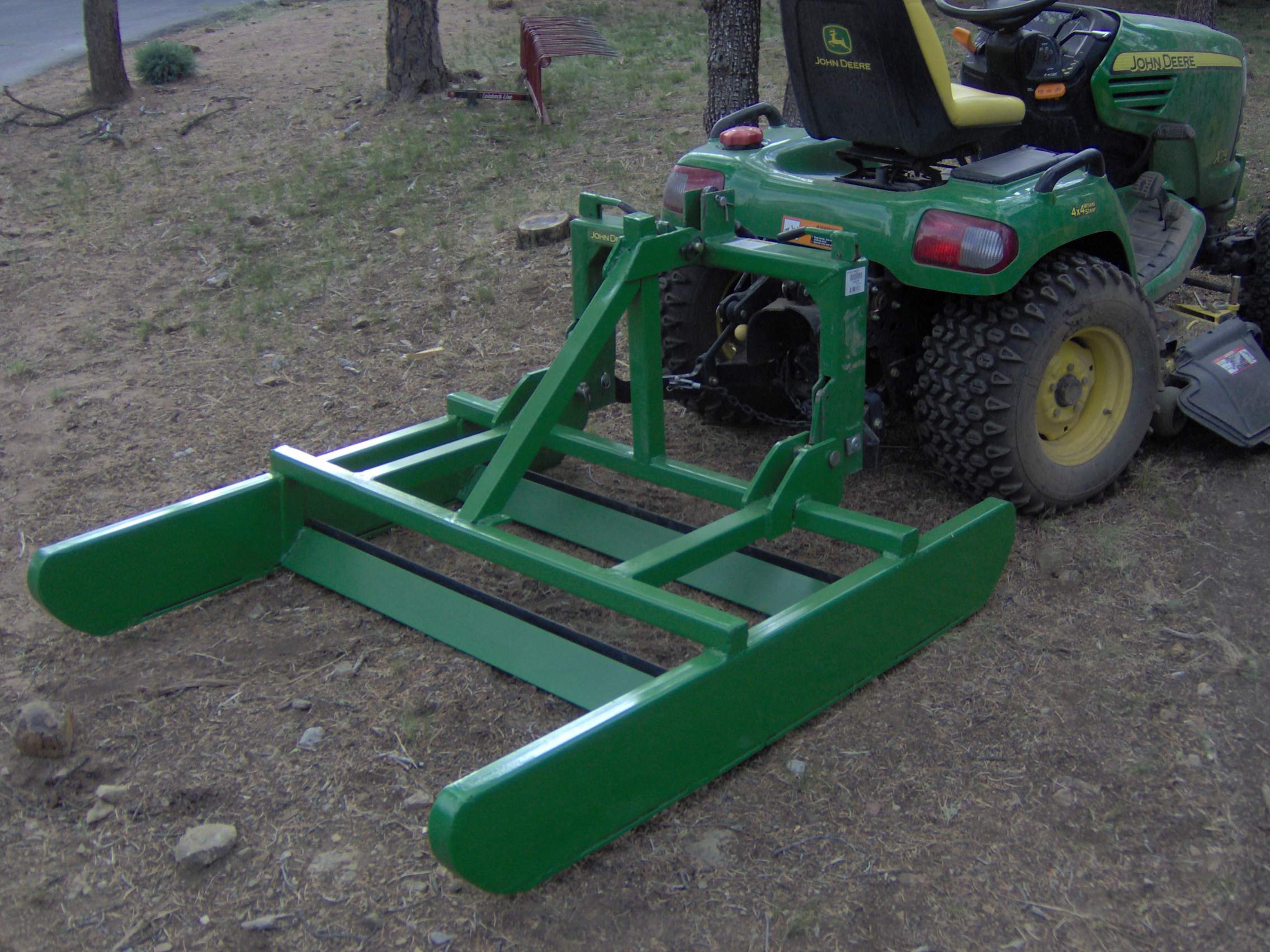

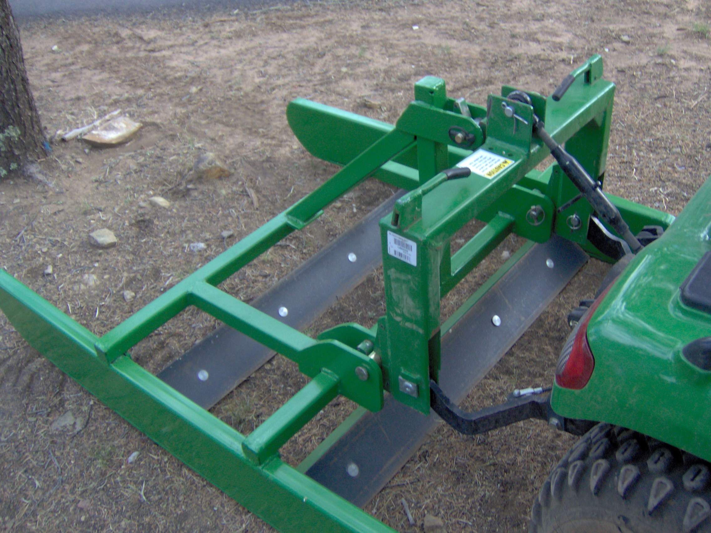

jenkinsph, You have helped enough people with enough wisdom around here that it feels a little odd to contradict you. But I also actually have been using this little tractor and this plane for the last several years and I just gotta. =) It's really not a strain.
My statement (and point really) was that I only need to lock it up on that one small steep section of the road. That part is steep enough that I don't mow it side-2-side, but I can still drag a fully loaded 5' plane up that section of the drive. I just measured the slope with an inclinometer and it is 17 degrees (3.75/12 rise/run) most of the way up this hill. That's as steep a drive as most will have, and steeper than most would want. (I sure wish the original owners had picked a gentler path up the hill, UPS hates me in the snow).
Also, I don't feel at all like I'm overloading the tractor on that section, as I'm running definitely running out of traction not power. If I ran rear chains, or a couple hundred lbs of wheel weights then I'm sure that I could pull my 5' grader (loaded) up that hill without 4wheel or diff lock. I only engage the other wheels because I need more ground connection than I get with my ittybitty tires and without the weights or chains. I never lug and frankly never see more than a couple hundred RPM of loading on the tach (maybe dropping from 3200 RPM (PTO speed) to 3000ish). Basically I'm just to cheap to buy a full set of wheel weights and to lazy to throw on chains in order to avoid engaging my diff lock on that hill.
Regarding the dry gravel point, I completely agree. The best time to grade is a couple/several days after a decent rain. If the road is too dry then you don't really accomplish much (especially with the smaller planes that by nature will be lighter weight), and if the road is still too wet then it's just a muddy mess. The reason I specified that I could pull a "fully loaded" land plane up the hill was to hint that I wasn't talking about just skipping an empty plane over a dry/packed road.
Note to the OP: With smaller planes like we are running you will need to run it back and forth over your drive a couple times to unpack the top 1" of the road and get it mobile, then the plane can really do it's work. Larger planes, and planes with rippers, can short-cut this a bit... But small planes will do job just fine, they just need a couple passes. With each pass you will notice that you are carrying/mixing more material and you will see more of the road surface is scuffed/marked/handled. Once you have made several passes the whole surface you are doing should be soft/mixed/worked for a least an inch of depth. Now you just want to pack this new smooth/even/mixed surface back down with a roller (ideal) or with the heaviest vehicle you own (driven back and forth, trying to always drive on virgin road surface).
My dealer recommended the 5' plane for me (salesman is familiar with the property) and he wasn't wrong. I've been maintaining this drive for 5 years now and it works great. It's literally one of my three favorite things on the tractor (other two being forks and backhoe).
So I have to respectfully disagree and I'd humbly suggest that my 1000 series Deere does, in fact, pull a 5' lpga in most conditions. (or I've just been imagining my nice driveway and easy time working on it)
Here's a couple pics for reference:

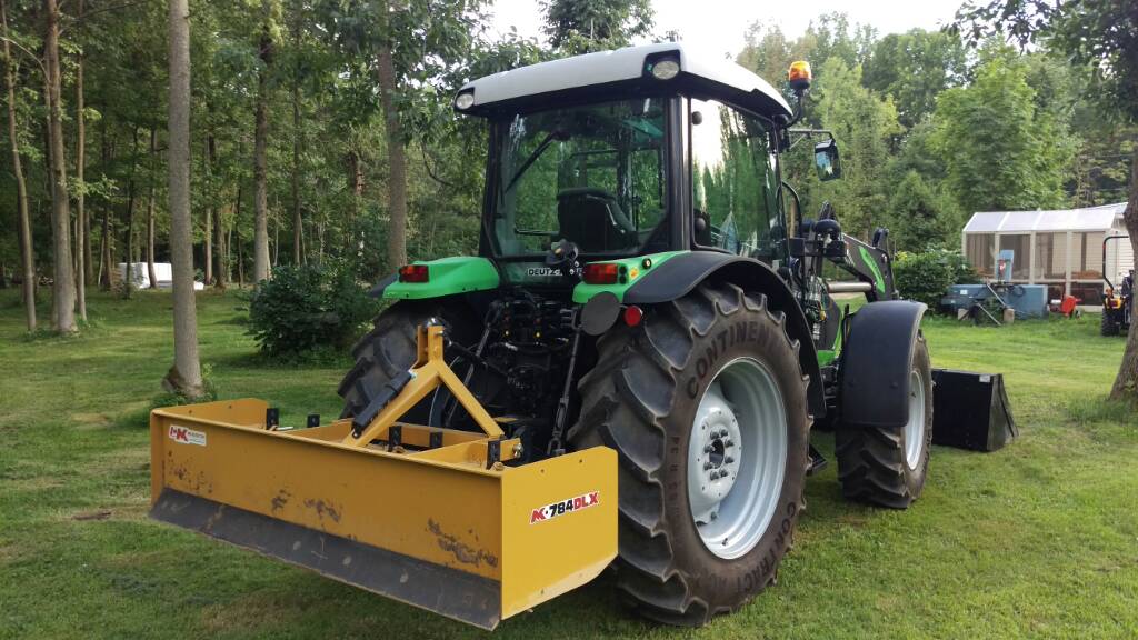

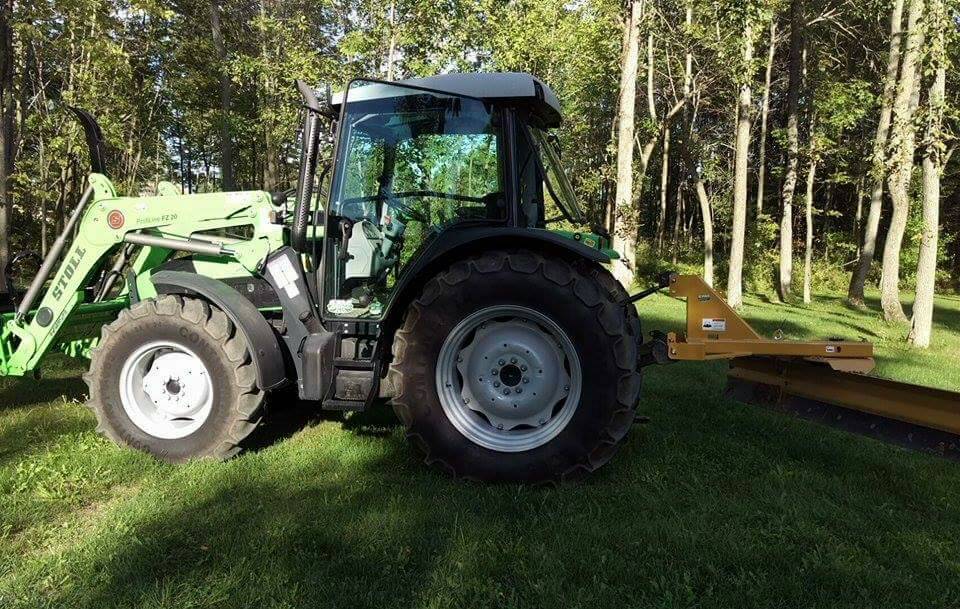

I have a box blade and scraper blade (7 and 8ft respectively) from MK Martin. I was looking into their scraper blade (rear blade) with the tail wheel and side shift but got the box and the blade for less than that blade alone.
Really good quality with no complaints.
I use them for leveling sand, gravel, earth. There are roots and stumps and stones and both of those attachments managed to stop my tractor in its tracks in 4x4 and low range. (I have a 110 hp Deutz agrofarm 430).
I had a Chinese subsoiler that got bent in half and I didn't even feel it on that tractor.
After 2 years of ownership and use. I can say that the paint and build quality is really good. My manual adjust rear blade even has a place to put a cylinder on if needed so if ever you want to upgrade to hyd angle you could without needing to get a new attachment or weld up brackets.
Hope this helped.

Unfortunately don't have a nicer pic of the rear blade. But like I said, they held up great and finding an attachment that can actually stop a big tractor in its tracks without bending/breaking is a sign of quality/strength to me (MKMartin). Paint quality is great too.
The box is 7ft and the blade is the 8ft model.
