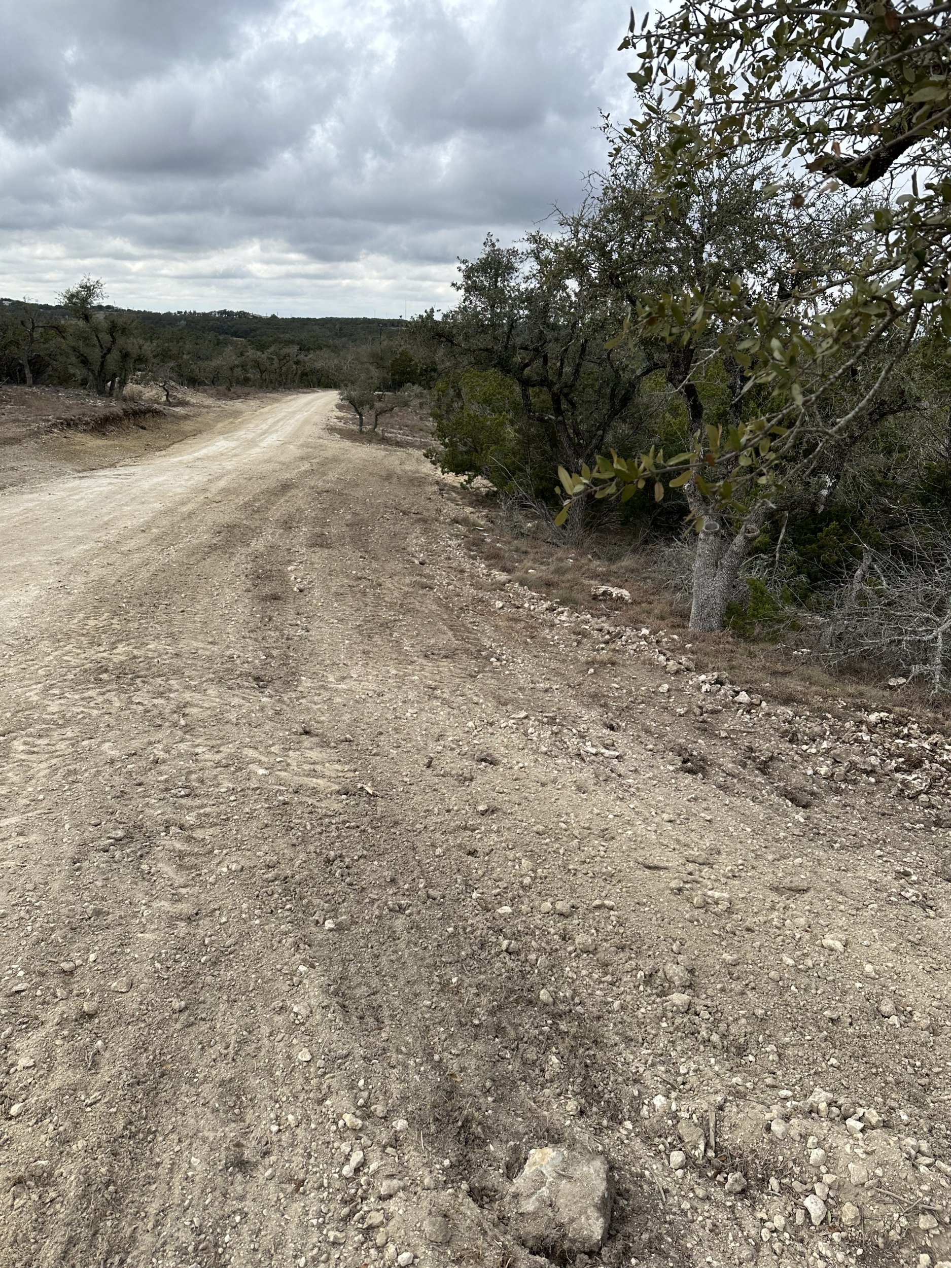

I live in an area that has a lot of caliche soil. It dries rock hard in the summer. I have successfully used my land plane with scarcifers to level areas of my property.
It has its place, it is not a fix all, I end up using landplane, box blade and rock rake based on what I am trying to do.
The biggest thing with a land plane the material you are trying to level has to be able to flow up and over the blades. Where I have seen it struggle in areas where I am pulling up large rocks (bigger than a softball) will clog up the flow.
In general it’s been a great tool on my property. Picture below shows the right side of my driveway that I just cleared and smoothed over with the land plane and rock rake.
