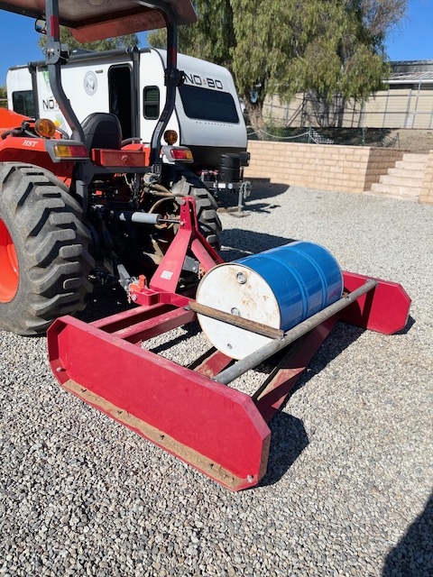

I have used the LP with good results on our clay soil. The key to any dirt work is to ensure the moisture content is right. Too wet is a MESS and too dry is like working concrete. If you rip up dry dirt it won't work well or stay where you put it. Watch the dirt start to dry and hit it when you drive on it without sinking in and the LP can still cut the surface. Then once the area is leveled out wheel roll it to compact.
I have gone in too early and completely sunk my LP and balled up lots of clay and weeds on the ground and in the attachment. I ended up adding weight to the LP so it would cut better. I can adjust the weight by adding or draining water from the barrell

Thanks, good advice on trying to target the right moisture. Do you not use scarifiers on yours?
   / Land plane for grading lumpy land (not a driveway) #13
No Scarifiers. If you catch it right you will not them and they won't be pulling up rocks and chunks of earth. I only use scarifiers when I have a deep cut to make which it sounds like you do not. It may take a few sessions after a few rains to get it where you want it. Then seasonal maintenance to remove weeds etc. like we do on our firebreaks should be painless.
