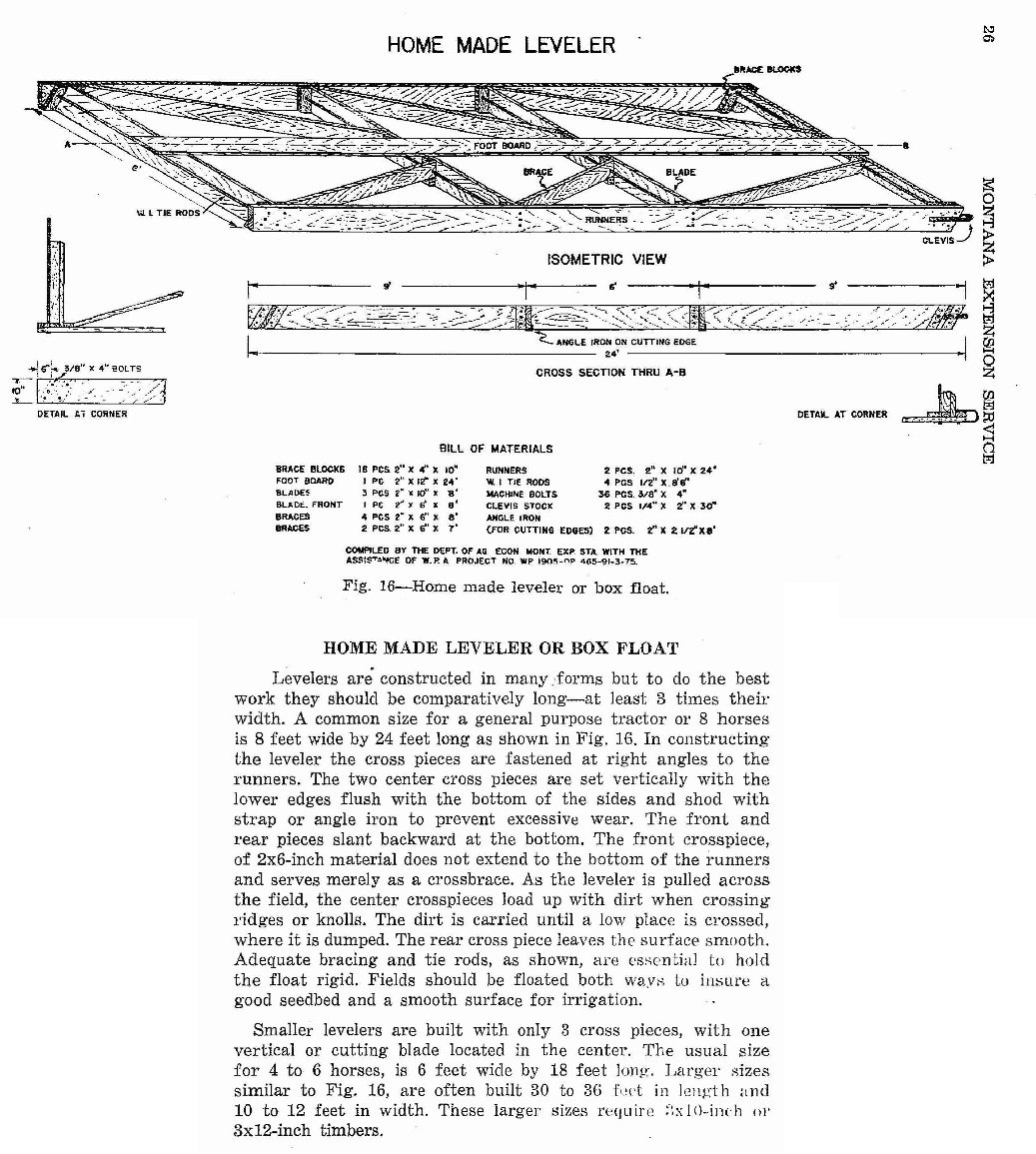

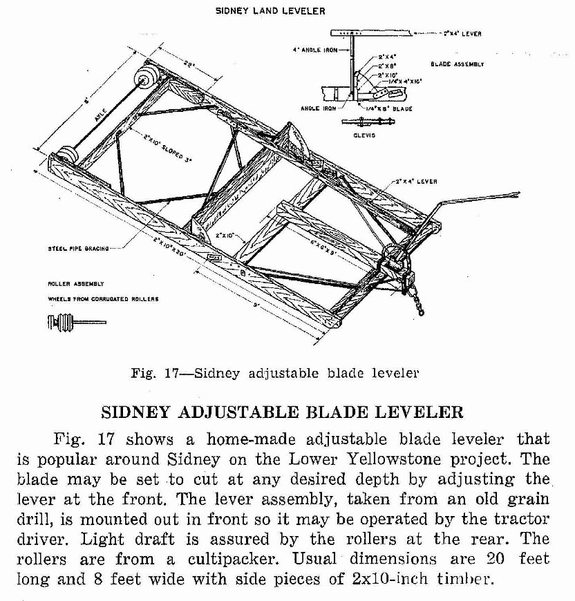

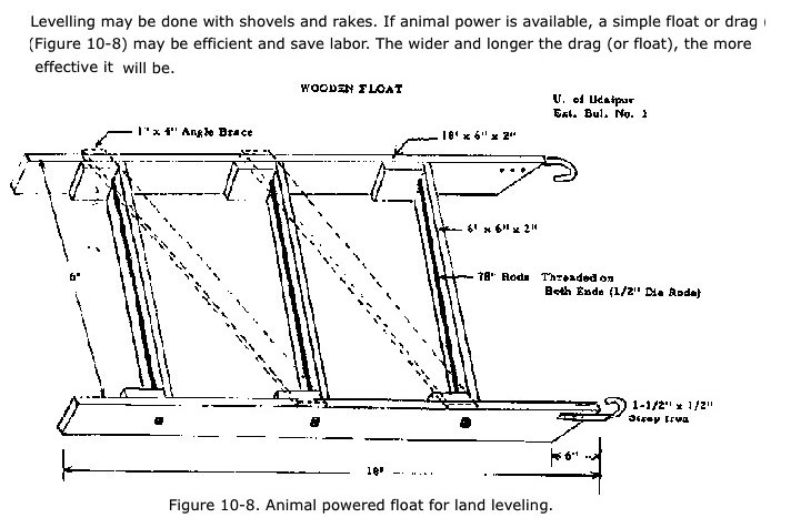

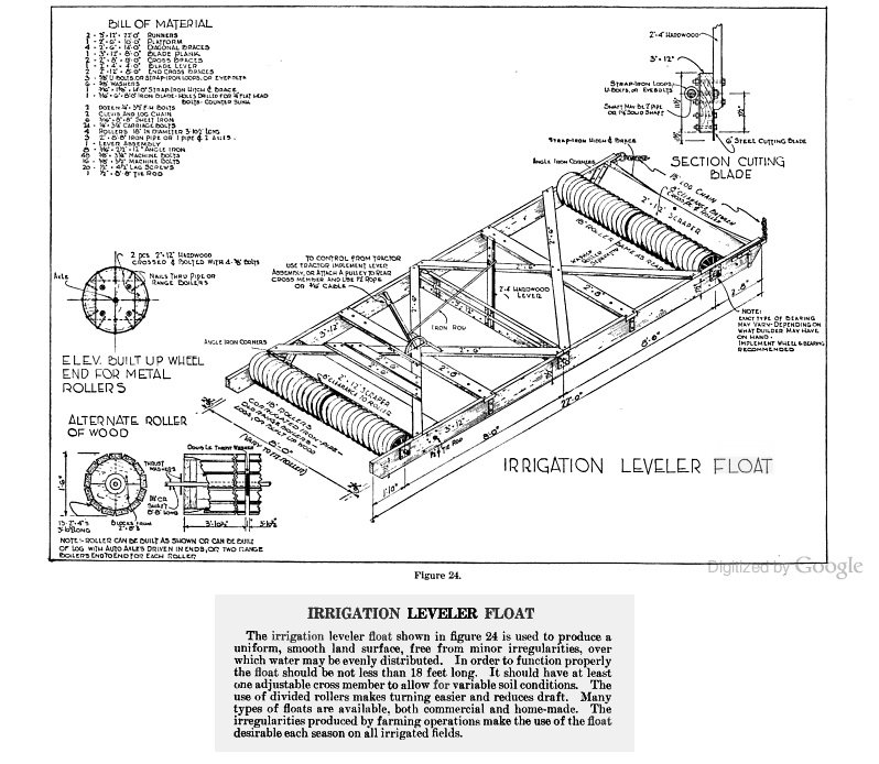

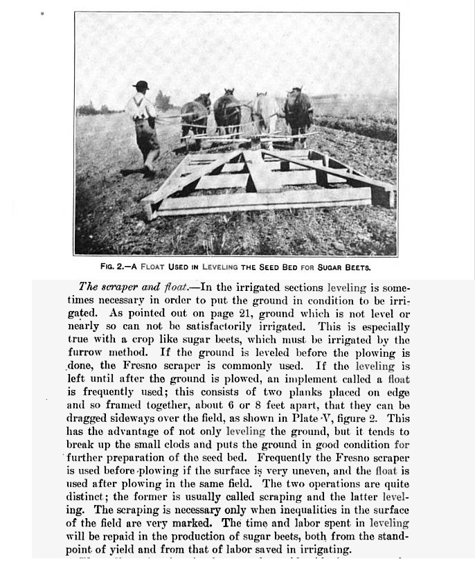

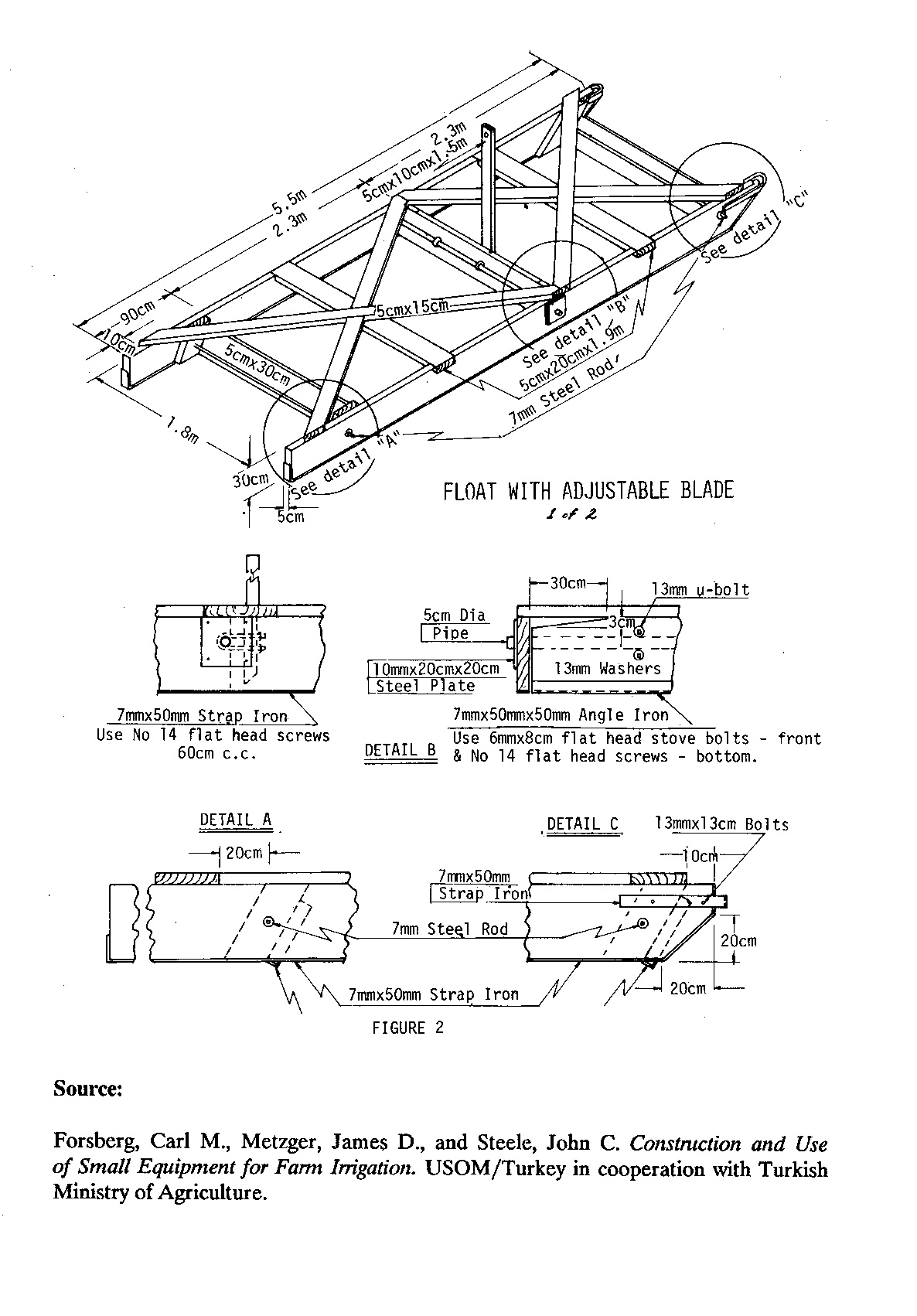

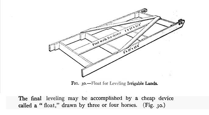

You need a float.
Bruce
   / Land plane question? #3
If you have access to some pallets, join two together (front-back) with 2x4 on the sides, and then drag them around, top side down. Will do a good, cheap job of leveling loose soil. Heck, if a big enough tractor, use 4 pallets and go twice as wide.
   / Land plane question? #5
We used larger, heavier, simpler ones than shown here. 3 or 4x12 lumber, 10-12 wide, maybe 20-30 feet long. Usually pulled by a Cat D6. Sides and center board vertical, front and back boards at an angle, X-braces of steel rod.
In the early 1950's they were almost totally replaced with various styles of wheeled land planes.
Bruce
   / Land plane question? #6
As shown by bcp, length is needed just as we would need a long #8 Bailey wood plane rather than a short plane to flatten a piece of wood.

   / Land plane question? #9
Short drags will smooth the land, long ones will flatten it.
