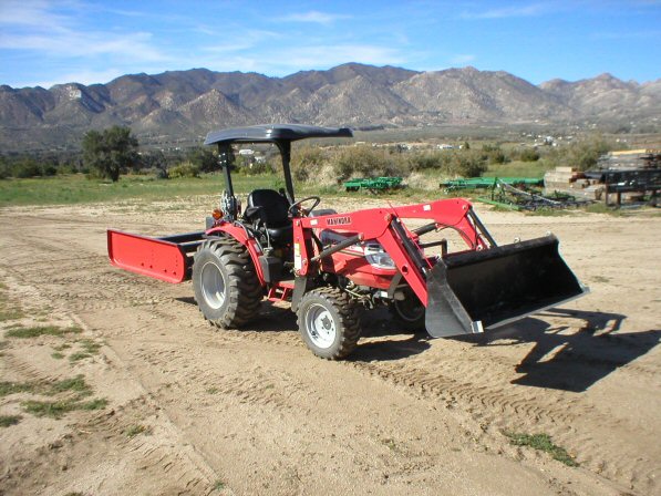

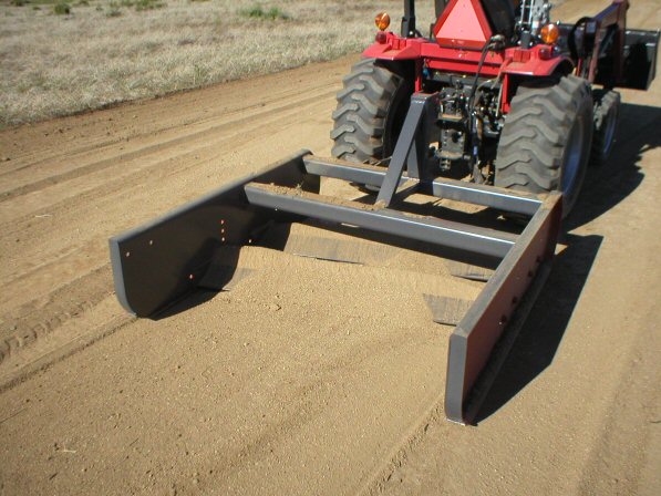

I would say a 4 footer to be realistic. There are a lot of variables to be considered though. I pull a 5 footer behind my 5000lb 32hp tractor and it is all it wants. But then my grader blade is a bit heavier than the average 5 footer. ;)
