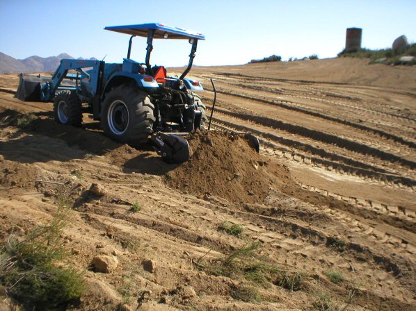

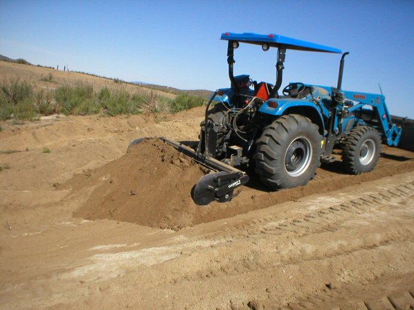

A LOT has to do with the size of the tractor. I have had zero problems with mine and that is going in reverse in virgin soil.
