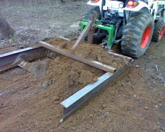

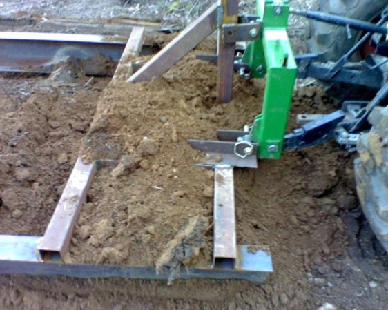

Had an old buried brushpile and smoothed off the mound of dirt that was left, it stopped the tractor a few times but that was a loss of traction. I then used the boxblade to rip out a potholed lane and you guys were right again it worked very well, I borrowed my uncles landscape rake to collect all the large rocks and it turned out well.

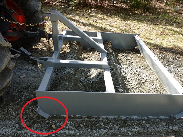

I don't see ramps/ slopes on the front of your I-beam skids ... ? If you don't have those, it seems like they will just dig in rather than gliding along your I-beam skids like they should. It may work OK this way, but I think it would work better with the slopes.

I don't have skids yet. I have the steel to make them just been to lazy to do so. But actually they don't dig while grading the lanes but do when leveling the soft dirt. It's supposed to rain tomorrow so it might get done then.
