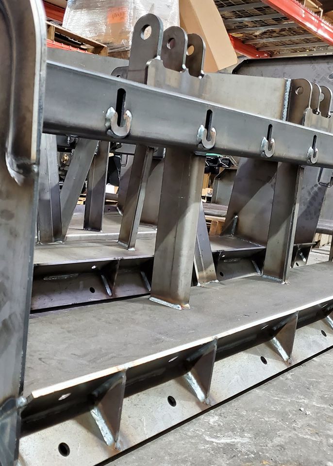

For some reason, I can't get the pic to post properly, but I'll give it a go..
The pic shows how every tube we pierce for ripper shanks is reinforced. Every single box blade and land plane with a pierced tube gets the extra horseshoe plate.
To answer your question, I do think this is a warranty issue, due to a poor design. Unfortunately weak and/or poor designs are quite common in the industry.
Travis
Those reinforcements look great. If you don't mind I am going to download that photo and add it to my warranty arsenal.

Looking ahead I'd like to hear opinions about how to repair my LPGS and beef it up so it doesn't happen again. Thanks.

I have a SF2577 scarifier with the same issue, but i bought it used. the bar they claim is reinforcement is not well attached inside the tube. i have a 28 hp tractor, not sure what the previous owner had. its a weak spot for sure. I was thinking of using a post vice i have to squeeze them back in, grind out the cracks and weld, and then weld an angle along the entire back of the tube. if i had an easy way to cut plate, i would probalby do some brackets like the EA stuff for each hole, top and bottom.
