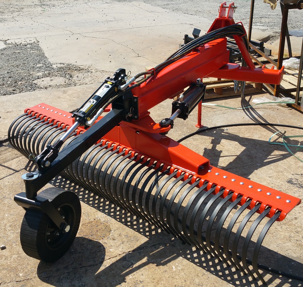

Here's a sneak peek at our heaviest duty rake yet.
The rake hasn't made it to the website yet, but we usually give you guys the first look at our new products.
The 84" rake shown is configured with a hydraulically adjustable, center mounted gauge wheel as well as hydraulic angle and offset functions.
It is Category 1-2 Quick Hitch compatible and features our floating style hitch for better results with the gauge wheel.
Questions and comments are welcome. What do you think?

I like the hydraulic angle. What is the thought for the having a cylinder on the gauge wheel and the thought of one wheel versus the two wheels?
   / Land Shark Hydraulic Landscape Rake
This rake is going to a customer who has lots of hydraulics on his tractor, and more cylinders= less getting off of the tractor to make adjustments!
The single gauge wheel will give him the ability to tilt the rake(with his hydraulic side link) and utilize the gauge wheel at the same time, which wouldn't work with dual wheels.
One center mounted wheel will also be more maneuverable.

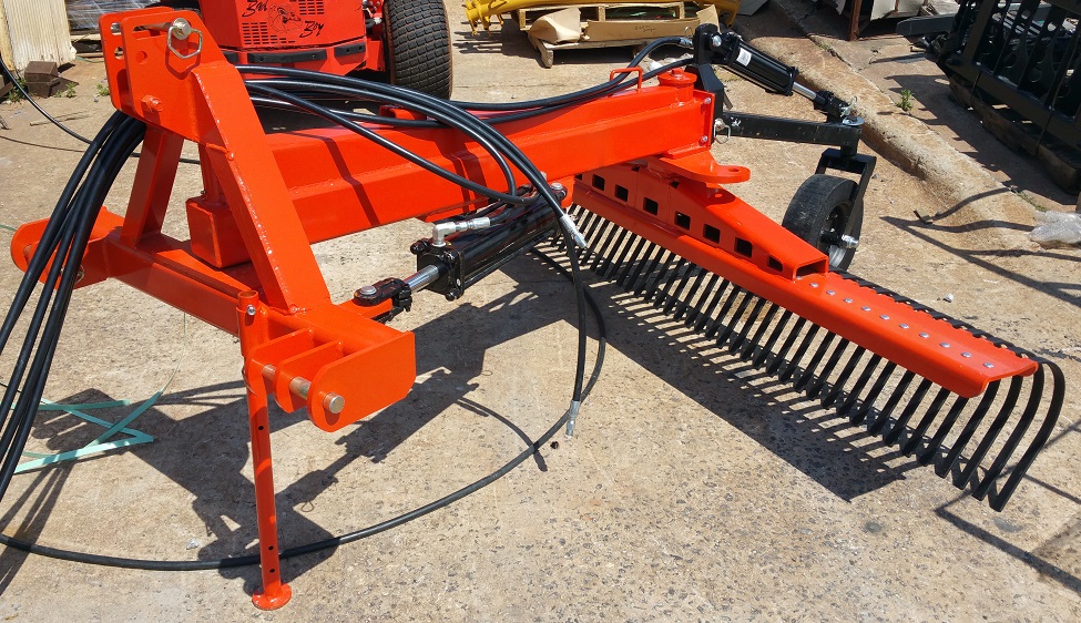

To add......
You will be able to configure the rake for your needs, so any of the hydraulic options shown in the photos will also be available as mechanical.
Travis

Nice piece of design work.

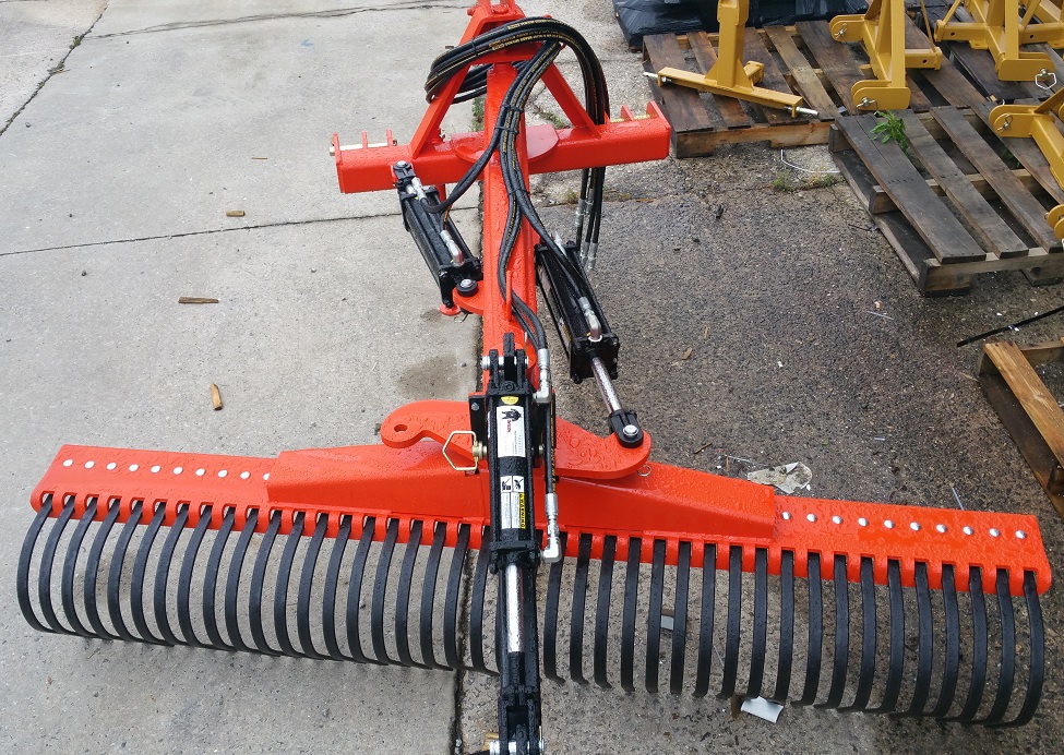

Am I correct in assuming that the dual cylinders for angle adjustment allow for the rake to be offset, as well as just angled ?
Thanks! It's definitely built for serious work.
I think the photos are playing with your mind a little.
One cylinder is connected to the back tine bar for angle.
One cylinder is connected to the front hitch for offset.
The top cylinder(obviously) is for gauge wheel adjustment.
Here's a clearer illustration showing all of the cylinders:
