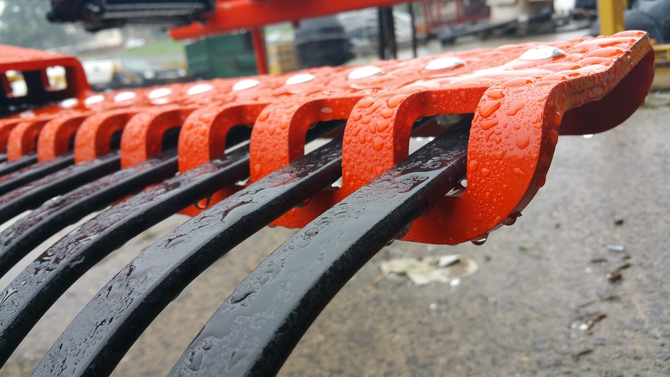

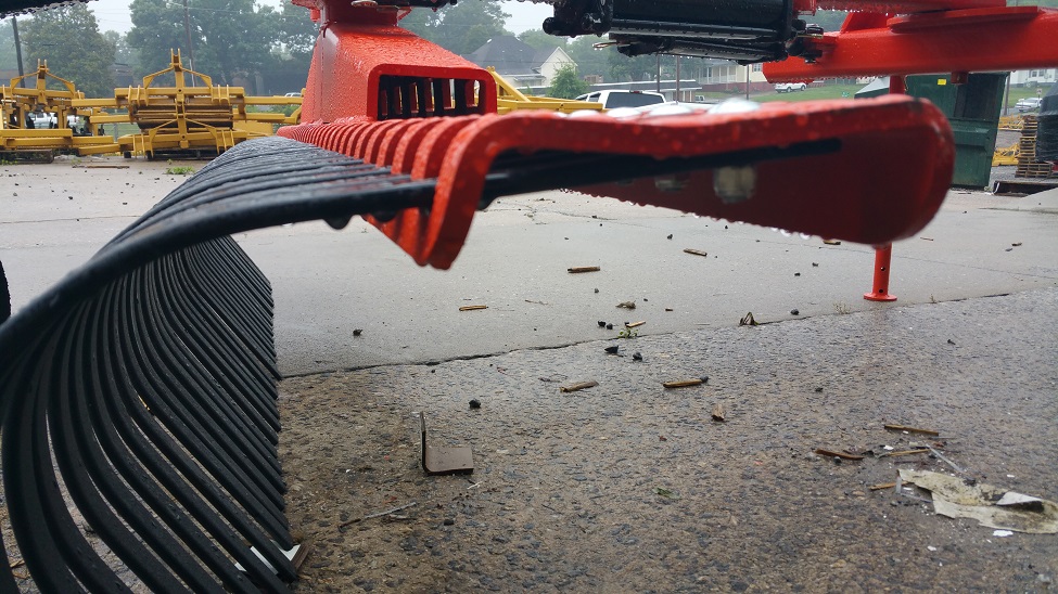

Looks very well built and extremely heavy duty. Are the tines easy to remove and replace? I'd remove every other one of them with the thought that the spacing is going to pick up too much dirt. In my experience with my rake, it fills up with branches and sticks so quickly when I use it that the less dirt I get, the better.
Thanks!
Our unique tine bar design is simple, yet very durable. The laser cut holes keep the tines aligned perfectly and the bend in it lets the tines move and work extremely well.
Each tine goes through a hole and is held in place by a single carriage bolt. All EA rakes feature the same tine bar design.
Travis

That looks stronger then mine. I have two bolts and the tines always break at the bolts. Holding them in place with your method would take a lot of the stress off of the tines at those bolt holes, where they are the weakest.
Travis, tell Ted he needs to add another cylinder to raise every other tine! :laughing:
