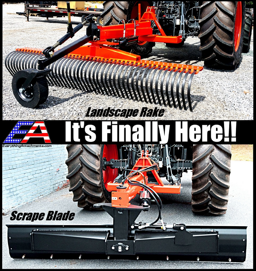

Well done, and I'm with Eddie on the stress distribution.
One thing I've encountered on a cat 1/ cat 2 combo grader blade is that the 3point hitch lower arm attachment points on the A frame were too high for my cat 1. You want the pivot axis to be plumb in the operating position so when you rotate the blade, it doesn't inadvertently tilt the blade too. Not much sense in having hydraulic rotation but then needing to get down and manually correct the sidelink if you don't have hydraulic tilt too. By the time my cat 1 3ph was high enough to make the axis plumb, there wasn't much further 3ph lift available to raise the implement very far. That was a Woods grade blade and they might want to keep everything high and out of the snow or dirt. Hope your rake design is better it that regard.

Here's the product video with Ted. It gives you a better idea of the physical size of this beast with him standing beside it!

Last year I asked Travis and Ted to build a killer rake for me and they did. Although I meant to put out some videos about this attachment, I never had an opportunity to use it until just yesterday. I can see that this rake will become one of my go-to tools for smoothing bumpy, washed out driveways and roads. My first use and I smoothed a mile of our private road, cleaning out a washout on my driveway and began exploring cleaning up forest refuse and litter and smoothing the top soil where I've cleared.

The incredibly strong main hitch/beam for this landscape rake will also accept our hydraulic scrape blade moldboard, so why not save money?
You can now purchase an 84" or 96" Land Shark scrape blade and add a Landscape Rake tine bar to the order!
