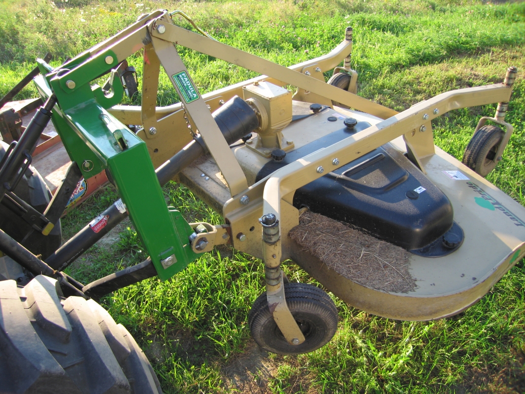

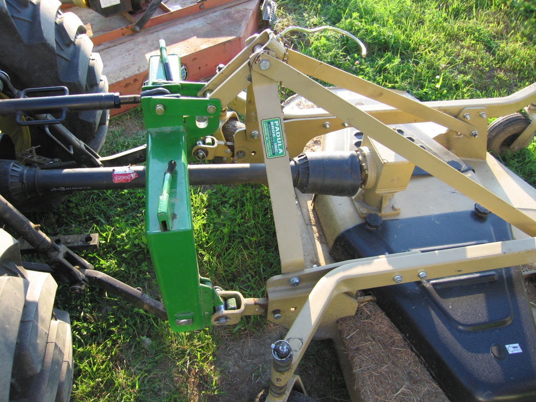

Here are the pictures I promised. They show the floating top link when the RFM is floating and raised. I finally got around to painting them JD Green. They seem to do the trick.

your configuration need two more plates attached at the end and then they go through the top pin to the quick hitch itself. This lets the mower float.
   / Landpride FDR2572 & JD I-Match #15
Thank you for posting these pics!!!!! :thumbsup:
