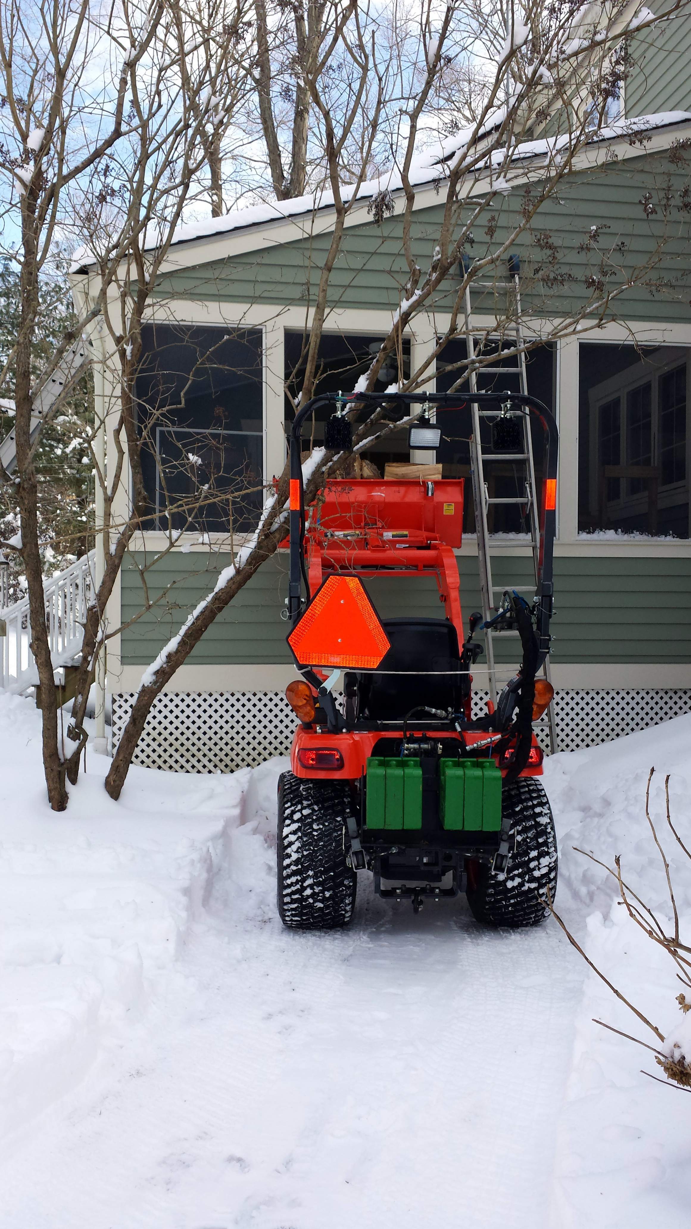

Hope youre weather improves enough to try our your grapple. Here's what I was doing yesterday - restocking firewood into my attached screened porch. I can put about 2 cords in there. Used about a cord and a half in January alone. Bad winter.

That's a lot of burning. I like a good fire in the fireplace but didn't even put one in my home here. Do you cut and split it also. That's fun work. I see a ladder on the left side also. If that for snow removal on the roof or for unloading your hard work. I only ask because I have grown to hate being anywhere near a ladder. I've never fallen but just have developed an aversion. I was going to hard splice my wires at first but the idea of switching the wires makes a lot of sense. I'm still worried a little about the clearance between the reversed valve assembly and the FEL stanchion or whatever it's called. However, I cannot see how it can move. I will have to be very careful when attaching the loader though although I cannot remember it being off more than once. It's my wheelbarrow. A lot of schools and businesses are closed or opening late today around Austin. However, it's only been a little cold. If a snowflake fell the whole place would close. If a road gets a little slippery it's like circus of clowns sorry to say so erring on the cautious side is prudent. :) :)

Yes, I cut and split most of it, but have bought a cord here or there when I didn't think I'd have enough to get through the winter. Probably use about 5 cords this year. And yes again, that ladder to the left in the pic was to get on the roof to clear off snow. Back in 2010 we had about 4' of snow in January and it was cold, so very little of it melted. Ended up with ice damns and water coming into the house where the roof meets the wall. We have since installed the water and ice barrier a ways up the roof, but I still don't trust it, plus I start to see nail pops in the ceiling when the weight adds up. Fun, fun fun.
