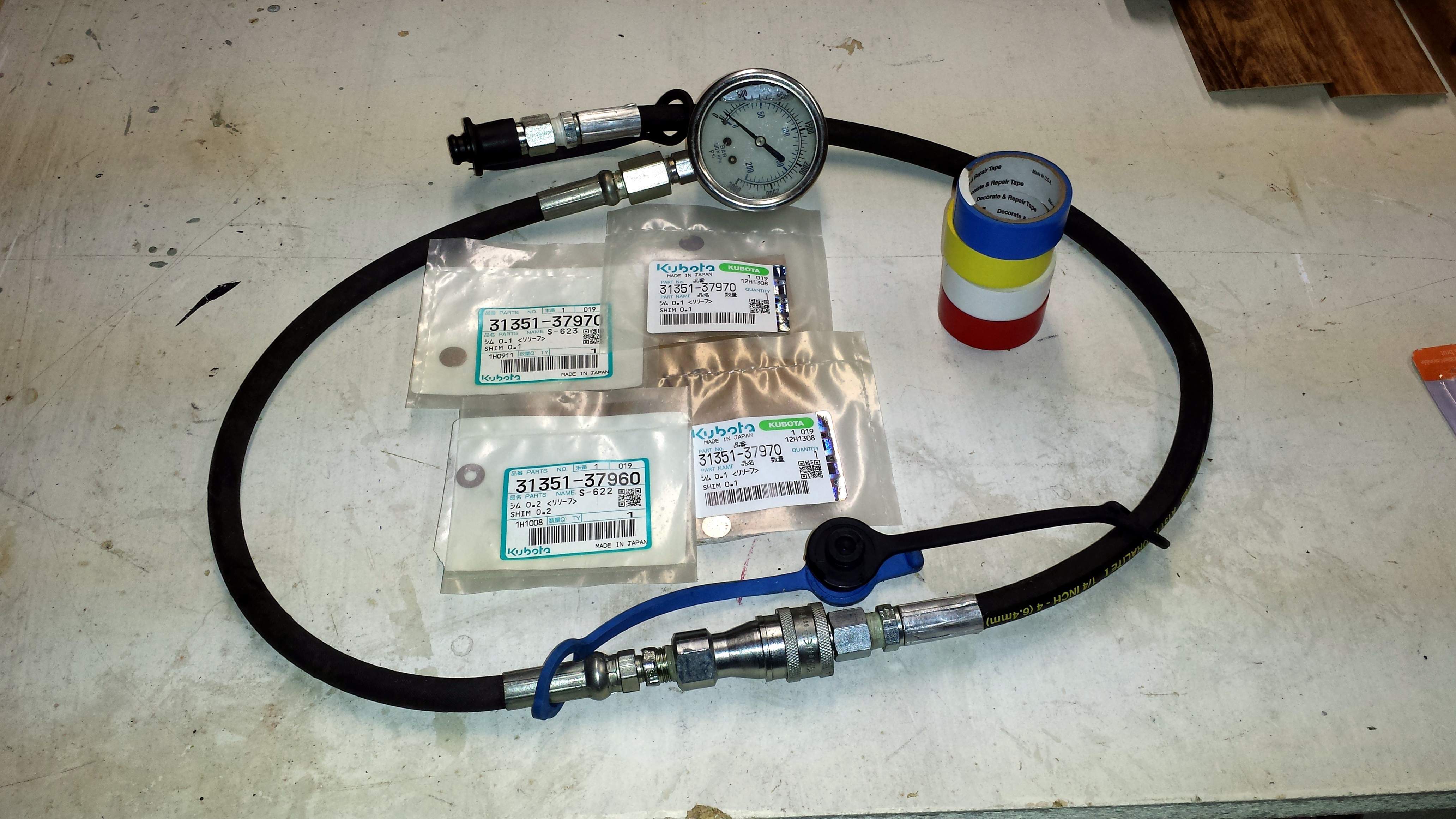

Nice lowell! Did you bump up the hydraulic pressure at all or is this 'stock'?
I am more jazzed about this than ever. I figure I am 2 to 3 months away though. How many hours do you estimate it took for install?
   / Landpride grapple for SCUT? #130
Haven't tweaked my hydraulic pressure yet, but I'm in position to do so. Got my shims late last week and have the pressure gauge set up for male or female QC connection. Also, have my colored tape ready to mark the hoses once I get them connected correctly, if that ever happens. I'll be calling the dealer Monday to check where the missing QC's are. I don't have any tracking info since the dealer dealt with LP directly. Frustrating.
