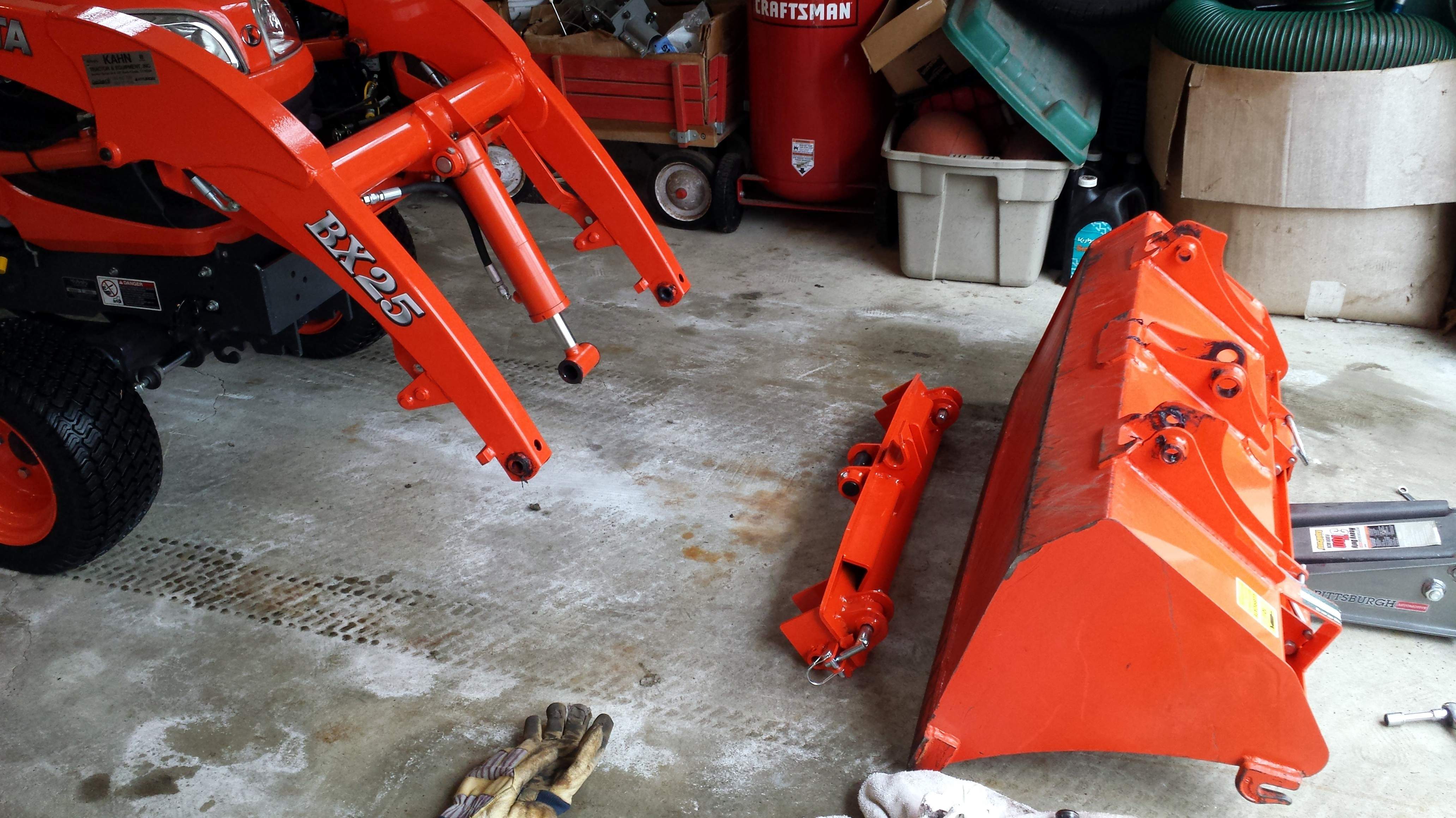

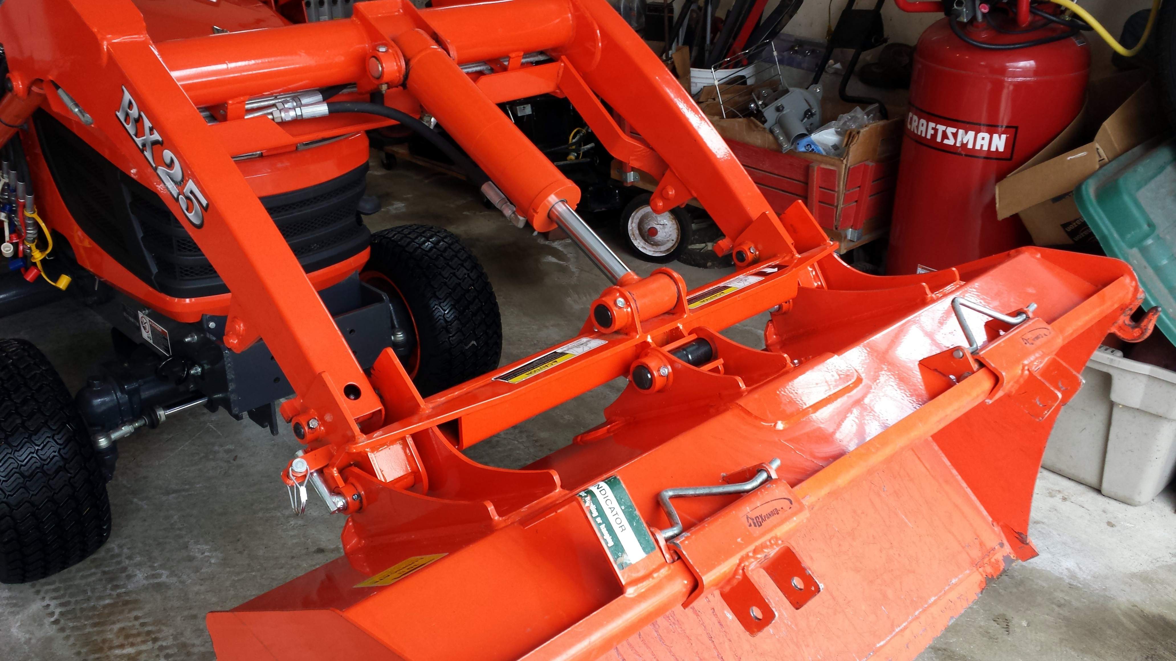

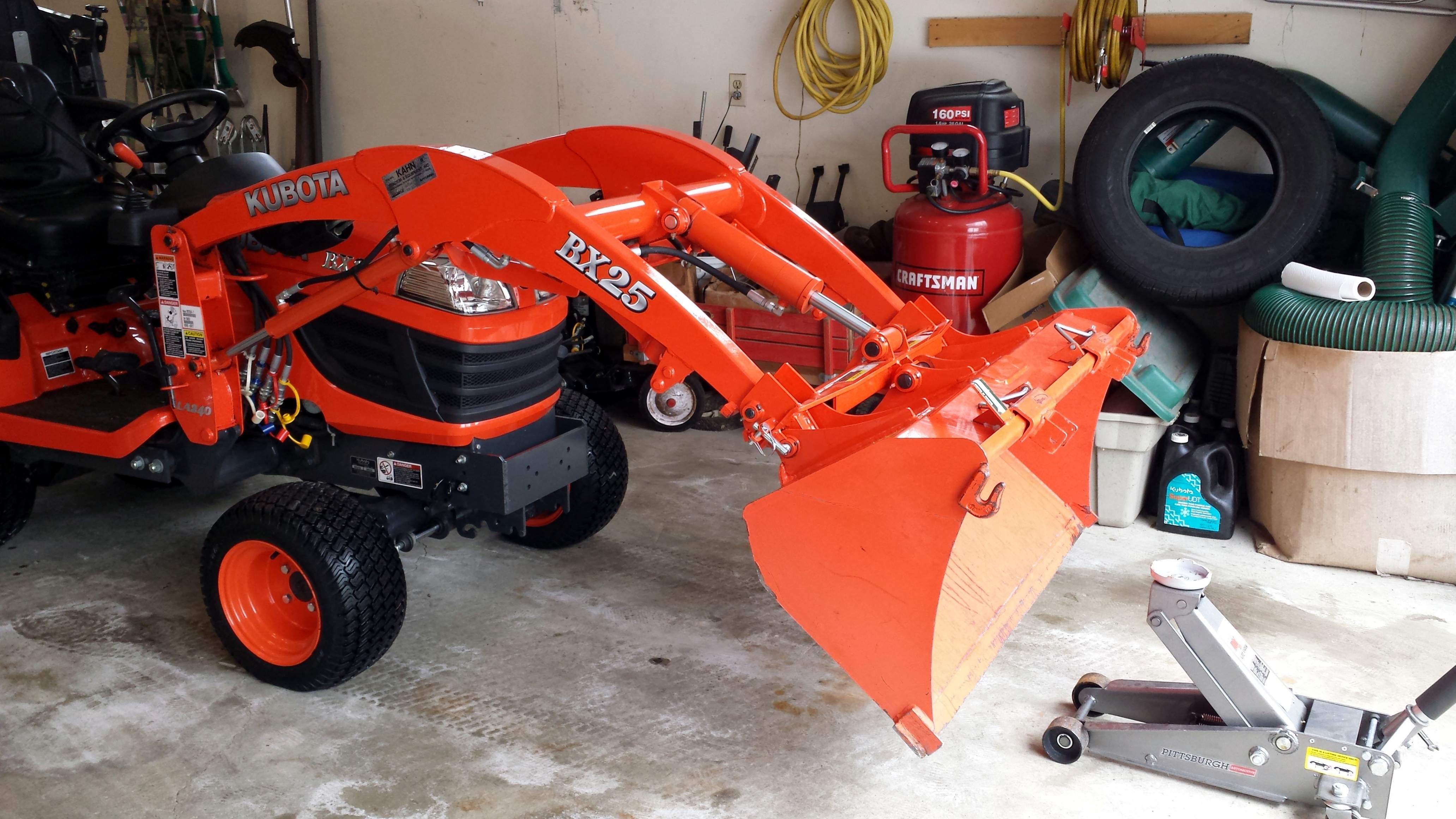

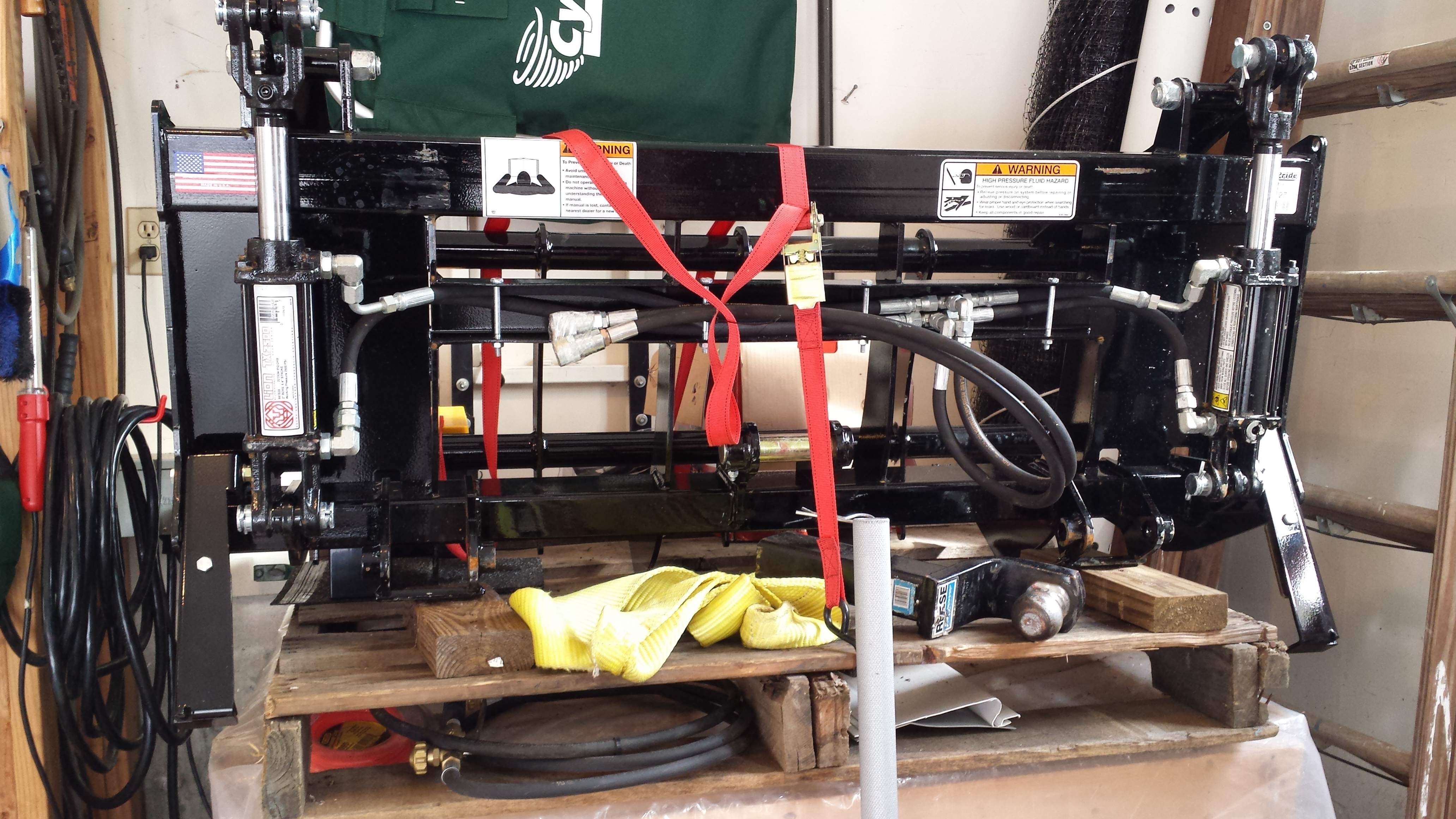

It's 40 here today, but going sub-freezing again tomorrow, so I decided to mount the Kubota FEL quick hitch. Pretty straight forward. Going to be nice to be able to drop the bucket and mount the grapple, and maybe forks someday, quickly. Also attached is a pic of the grapple as it sits in my garage now. One item of note is the 90 degree fittings for the hoses that will plug into the male QC's on the FEL torque tube - they look rather exposed should a stick/branch/etc. come through the back of the grapple. I may try to turn them 90* counterclockwise, or maybe get some expanded metal screening an weld that on the back of the grapple. We'll see once it's mounted how exposed the hoses are. It might just be how it sits now unhooked.
Oh yeah, quite a few small rust spots which are a bit annoying. I will touch it all up come Spring.

Yes the QA is definitely in the near future plans. Keep the pics coming. The price on the grapple is a bit stinging but man what a great implement! Forks are a definite.

I have looked into this unit also and deluded by the price. I downloaded the instructions from LP and was surprised they send a line all the way back to the PB port on the HST. My dealer's non-negotiated price is just at $2K, plus 160 miles for two round trips to the dealer and 2-4 weeks in the shop. Most grapple hydraulic kits I have perused before use a solenoid in the lines to the curl cylinder with a switch on the joy stick to open and close the grapple by selection. The PB connection is then through the FEL joy stick valve. My thought on this is they made it complicated to discourage all but dedicated DIYers and double the cost of the hydraulics. The only advantage (maybe to some, not me) I see is that the grapple can be used independent of the curl cylinder. If you are working that fast you need a lot bigger tractor than a BX. Everything has its pros and cons.

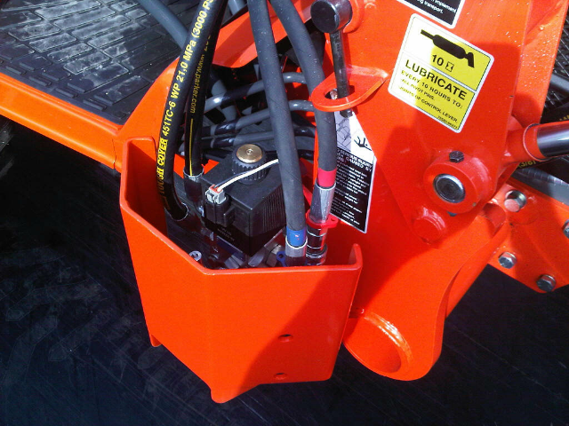

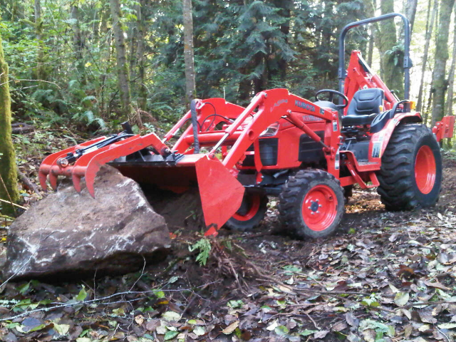

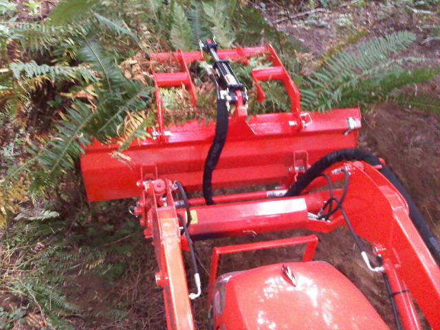

I custom built mine and used a diverter valve to run the grapple. My diverter is wired up to my loader lever with a button. Love and use it almost every time I get on my tractor. I plumbed in the hydraulics with quick connects so the grapple and lines can be quickly removed.

Ron, the diverter set up is where I was headed until I got what I considered a good package price on the grapple and 3rd function together. Grapple prices were around $1,200 by itself, so I paid about $350 for the 3rd function set up. I figured the diverter set up like I linked above would have cost around $300 by the time I was done adding hoses, fittings, quick connects and finding a FEL joystick with a switch in it. I was researching where to get a joystick handle with the switch when the pricing changed my mind.
I forgot to post one update yesterday and that was that it looks like those hydraulic pipe connections that I need to get at are accessible from underneath the tractor. I will have to at least loosen my skid plate to drop it down, or maybe even drop it entirely, but that should be easier than removing the floor pan, I think.
Shatter, nice workmanship on the protective box for the diverter valve. Just curious where did you get the grapple from and if you don't mind what does something like that cost? Thanks, Stanley
View attachment 357398[/QUOTE]

I started with a grapple off of eBay and then doubled the width and added more support. I the dealer mount my diverter and wire it but I think in the end it was under $1,000.00 for everything. Piecing it together and doing the fab work saved me a ton of money.
