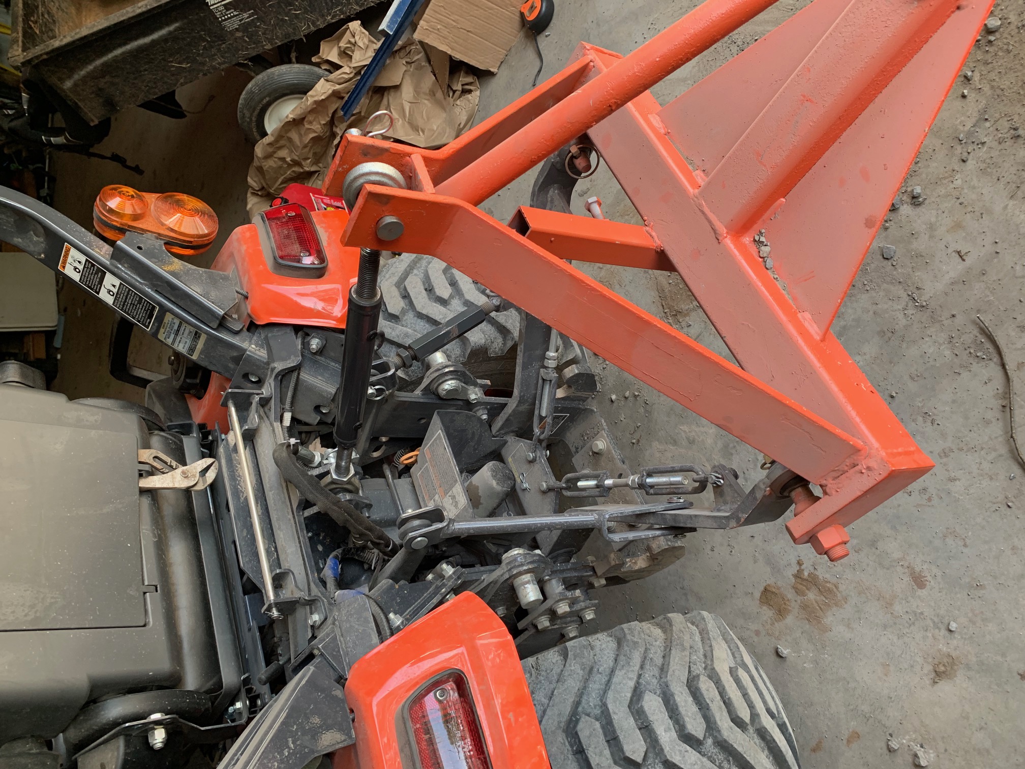

   / Landscape Rake Gauge Wheels #25
Can you post a pic looking FORWARD at the rear (hitch) area of your tractor, specifically including where the toplink attaches?

   / Landscape Rake Gauge Wheels #28
OK, that helps - except there's a hose blocking the view of where your toplink hooks to the tractor - looks like there's at least one un-used hole BELOW where the toplink mounts, with some kind of pin in it - two q's, is that pin DOING anything other than filling the hole, and (2) is there more than one option for where the toplink itself goes? IME, most tractors offer at least two positions, some three. Lowest position gives you the most lift range (geometry) and highest one gives you the most lift capacity.
What I'm looking for here is a NON-moving mount for upper end of chains that is also CLEAR LINE OF SIGHT to where your snubbers mount (the turnbuckle just ahead of the lift pins) ... Steve
