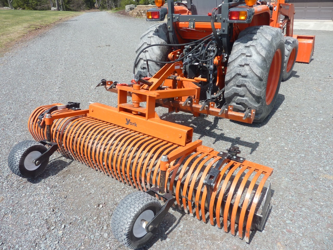

+1 on York rakes. I've had mine with scarifier, gauge wheels, hyd. angle and grader blade for over 20 years. Not one broken part or repair in all that time while maintaining 1.25 miles of private road.
Prior to the York, I had several cheap rakes which didn't last long doing this heavy work.
If the work you do isn't rough, you could get away with a cheap one though. Keep in mind, you get what you pay for with this type of equipment.

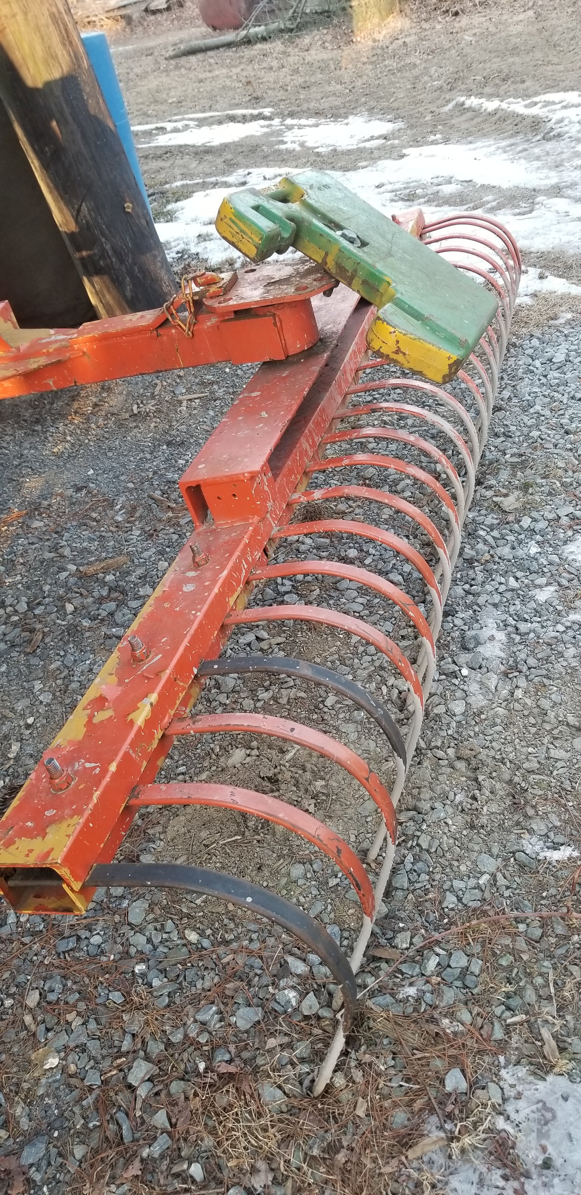

York rakes are pricey but worth it in my opinion. I found an hd with scarifiers, blade, wheels and hydraulics at auction so I cannot tell you how it was used previously but it had a couple broken teeth and a broken arm for the blade. I suspect it was pushed past its breaking point. So while the features are great it’s not as strong as a dedicated box blade.

That thing is 20yrs old and maintains over 1mi of road? It still looks like 98% of the paint is on the rake teeth.
   / Landscape Rake, need opinion ! #18
Sorry to mislead. The pic is 15 years old.
The rake has wear on it now but is still fully functional with most of the paint intact. I'd post another pic but it's put away for the winter season.
