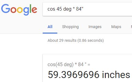

A 7 foot at 45 degrees is approximately 59 wide

This is a basic trigonometry question. In the era of the interwebz, you can ask Google this way:
cos A deg * W"
Where A is the angle and W is the rake width. Example for a 7' rake at 45 degrees.

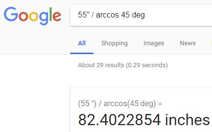

To find rake width for a given span S at angle A,
S" / arccos A deg
Example for 55" span at 45 degrees.

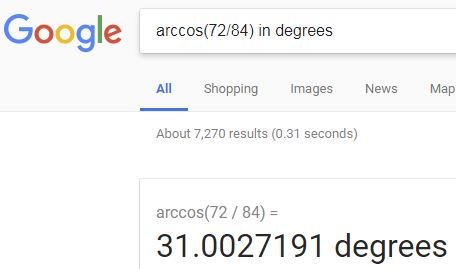

For tractor outside tire span S and rake width W, the largest angle that will cover the tracks is found by,
arccos(S/W) in degrees
For example, 6' tire span and 7' rake width
