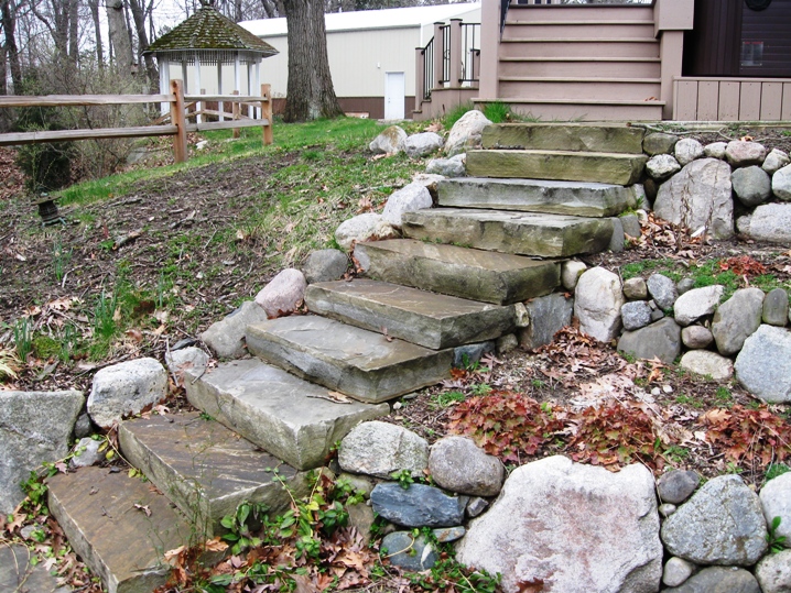

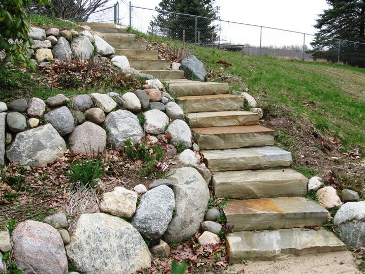

More cost and effort, but here is a permanent solution to the steps problem.
When I bought this house, it had timber steps that could have been 25 years old. However, they were so far gone I was afraid to even walk down them. I contracted this out because it's too much for my little tractor and impractical to do working alone. However, three guys and a skid steer did this pretty quickly.
