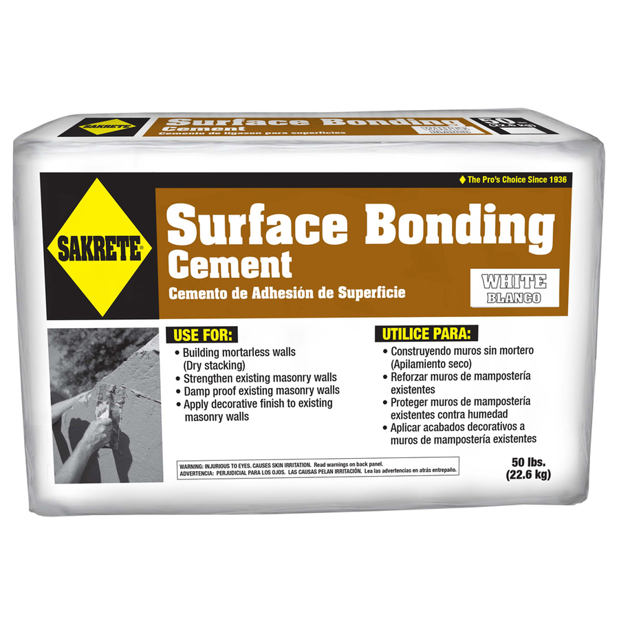

I like this idea alot but it sounds crazy expensive. Anything with the "marine" name gets awful expensive.. I asked another forum and ideas were too use Sakrete surface bonding cement. Sounds somewhat inexpensive and relatively fast to use. Any thoughts on this??

Go to Home Depot (or elsewhere), and buy a gallon of concrete bonding adhesive. ($14)
This bonding adhesive product looks like milk.
Paint the bonding adhesive in the cracks, and let it dry.
Then make a concrete paste of fine sand & cement (with water), and also add some bonding adhesive to the mix.
Coat the cracks for a second time with bonding adhesive, and while that is still very tacky, fill the cracks with the paste.
When dry, coat the trough with two coats of two part epoxy paint.
Flexseal would NOT BE A LASTING FIX for this situation!
Concrete bonding adhesive? Is that the same as surface bonding cement? I don't much like the idea of flex seal even though it sounds easy..

Hydraulic cement is not significantly higher in price than regular cement. Regular cement shrinks during curing which will lead to leaks in tank. Hydraulic cement does not shrink. Bonding agent will help with patch adhesion, I think it looks like elmers glue. The packages of bonding cement have bonding agent added at factory.
Nope! It is not the same as surface bonding cement!
As in my post: "This bonding adhesive product looks like milk".
If you read the label (at Home Depot) it will explain how it is to be used.
Now I see what you mean. I read the product label..
