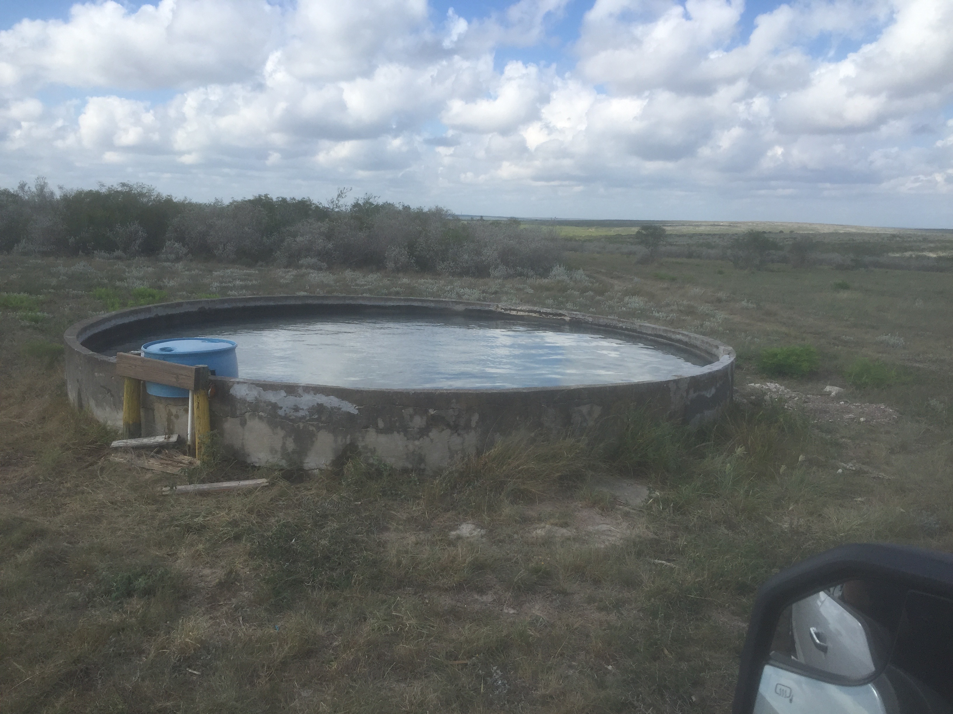

How deep and wide are the cracks.
   / Large concrete water trough needs repair.. How
#22
This is a large concrete water trough. This is the type that is built on site. it's about 12-16 foot in diameter 3 foot tall. Some of the cracks are small while I do have a large crack down to the rebar about 3 foot long.

I purchased some concrete bonding adhesive and 2 large pails of hydraulic cement. Ill post some pictures of the progress this weekend.
#24
Well after using the bonding adhesive and two pails of hydraulic cement, my water trough is back in business. Still have some seeps but nothing major. I ran out of cement so kept the water low until next trip where I can finish job on the very top end...

Nice tank, what are you watering
#26
It's built for cattle but we haven't re-stocked after our 8 year drought we suffered through. Currrent plan is for wildlife. Our main pond dried up this summer. I would like a place for our whitetail herd to be able to water if needed..

Fight fire with fire. Masonry problems are cured with masonry products. Clean crack and repair area. Get acrylic fortifier (acryl 60 etc), bag of surface bonding cement (aka b bond), and a bag of Thoroseal. Pack crack with the b bond, then skim over the damaged area. Next day 2nd coat. Use the acryl 60 as part of your water in all steps. Then coat the repaired area, or preferably entire trough with Thoroseal, 2 coats. One bag goes a long way. It'll be fixed till the next settling and makes more cracks...
Thoroseal with acrylic fortifier is amazing. I went into my cistern, made of concrete block with washed out joints, cracks, and holes and did all of the above, it's like a new tank. 1,000 gallons of spring water inside, no leaks outside.

Use it as a form and line it with fiberglass, will last another lifetime. Get the FG at a marine supply place or industrial pipe supply house.

A liner isnt a bad idea. A roll of 30mil maybe. You could clean out the whole insides with a pressure washer, open the cracks and have someone come in and shotcrete it. spray the cracks a couple times then the whole tank. They build swimming pools that way.
maybe get ahold of a swimming pool company...
