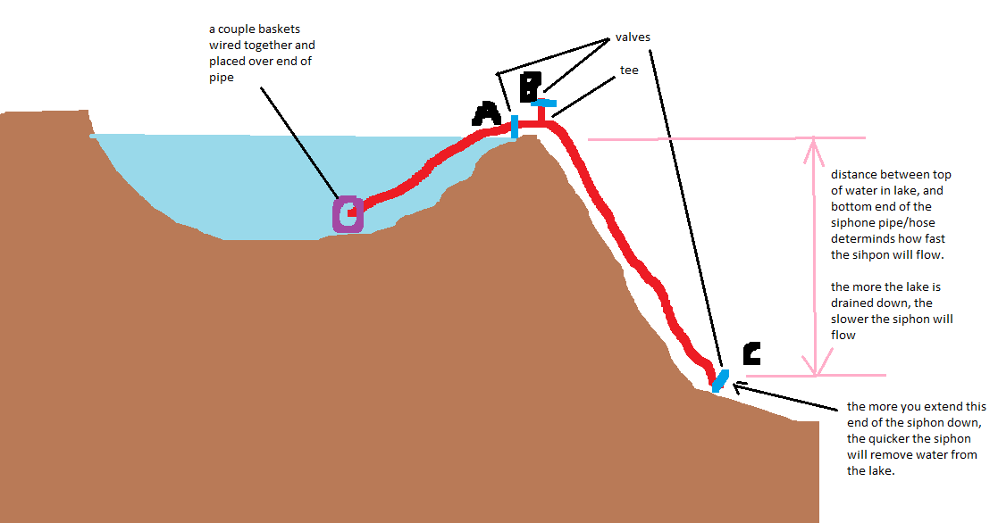

both lakes here on the farm, same winter, decided to get clogged up in the overflow pipes.
using sch 40 4" pipes. some tees, couplings, a couple valves... a couple baskets... i created a sihpon on both lakes, and it took about a day or two to drain it down to were i wanted it.
most lakes have a "d a m" on one side, were you can run a pipe all the way down to the bottom of the dame. then up over the "d a m", and into the lake.

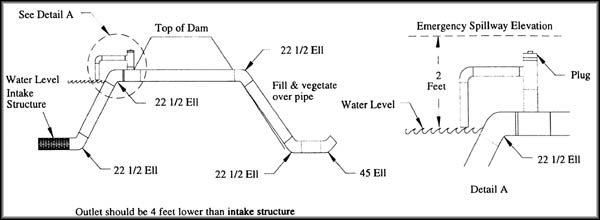

I apologize for resurrecting this old thread. There is some wisdom here I obviously don't understand which would help me with my pond which badly needs a cleaning.
The bottom is all gravel I'm told and spring fed. Very high ground water table around here. The contractor I have hired does not think we will ever be able to pump it down enough to get an excavator in there. I'm renting a long ready excavator with 60' reach. Drag lines seem to have gone out of fashion around here.
I have a 150x125 ft pond so that get the spot in the middle - 40x60 feet.
I'm going to start pumping it out and would implore someone to decipher the siphon advice above in plain English to non mechanically inclinded guy. What is the point of a siphon vs using a pump here ?
Not plain English, but worth a thousand words. :)
The Website: Conventional Pond Piping System
