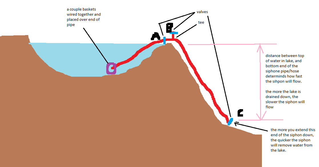

Well, I thought of draining it but it has a few spring water sources ( one being under water ) so even if I totally drained it I don't think it would ever get dry enough to use equipment in it. Here is a google pic of my place.. Frostburg, Allegany, Maryland - Google Maps
Okay, I remember your post sometime back about your long drive :). I still say the best way is to drain and dig using machines. A good operator won't have a problem with an underground spring, they'll know how to work with and around it. Even if you use a suck method you're still going to have to get rid of VERY wet muck. I have to wonder if the suction method is so great then why are most jobs still done with excavators and dozers??

Getting rid of the silt isn't an issue really. Luckily right beside my pond ( on the right side of the pic) is a hill down into the woods. and a creek . No big issue with pumping it down over the bank.
The thing with getting an excavator in here is this. I don't want the bank and grass all tore up and getting rid of the silt would mean o would need a dump truck, which translates into even more money. Also, I don't want my pond out of commission for 2-3 months while it dries out enough, of it ouw deven dry, to work it with a piece of machinery.
Also, While some ponds would be easy to drain and dry, this would would be a real pain. Not only is there an underground spring feeding it, it is also fed by yet another large spring or more like a very small stream ( on the left of the pic) that runs down into the pond and is sort of like a small wetlands. Daming this up would be pretty close to impossible.
So, since drying it would be very hard and since I have a convienient place to put the silt, pumping would not only be easier it wouldn't tie up my pond for most of the summer. My kids would not be happy for sure.
