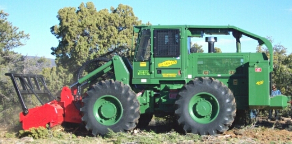

This one will eat standing dead, live, downed trees of ridiculous size. We use it here in Utah for fire rehab and fuels reduction. It's an awesome site underway. You can just chew up the trees or mulch them in to the soil.
