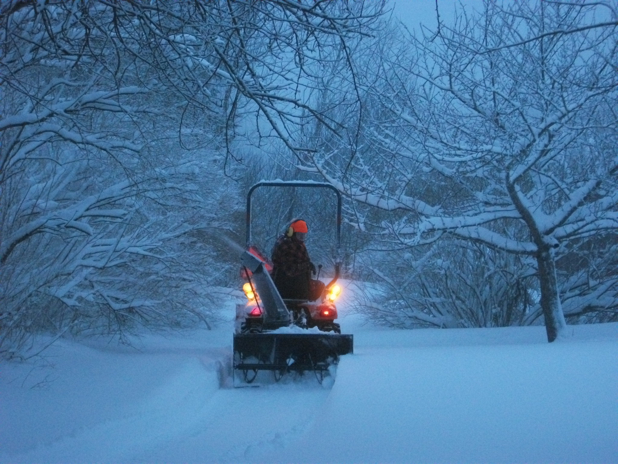

I'm running a Lucknow L48 on my BX25. This will be the second full winter - used it yesterday. Very satisfied with both.
Cheers Dave
