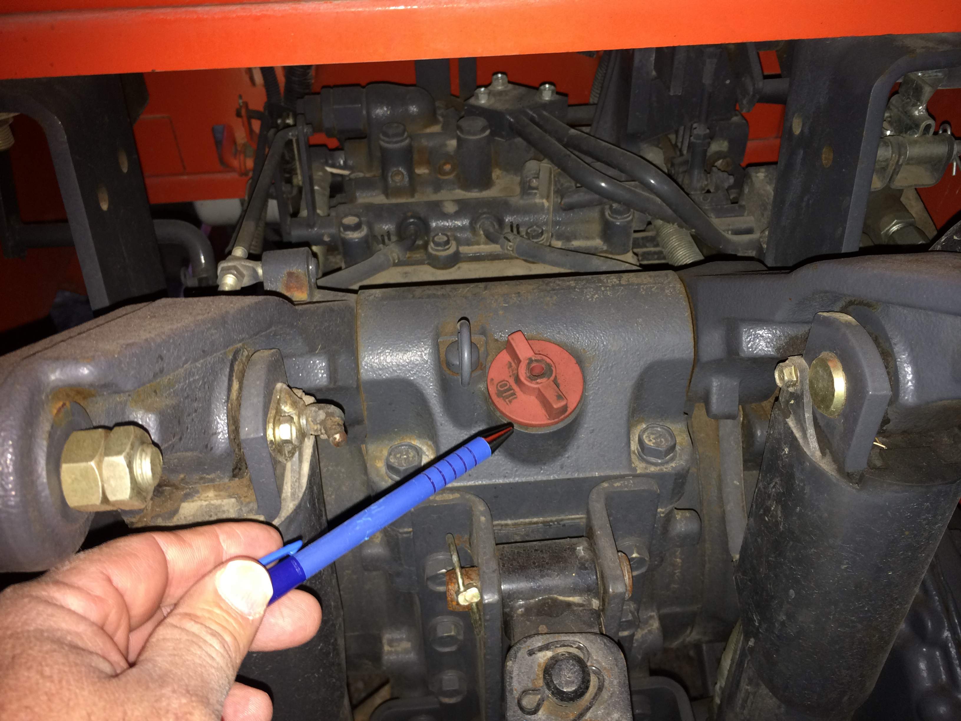

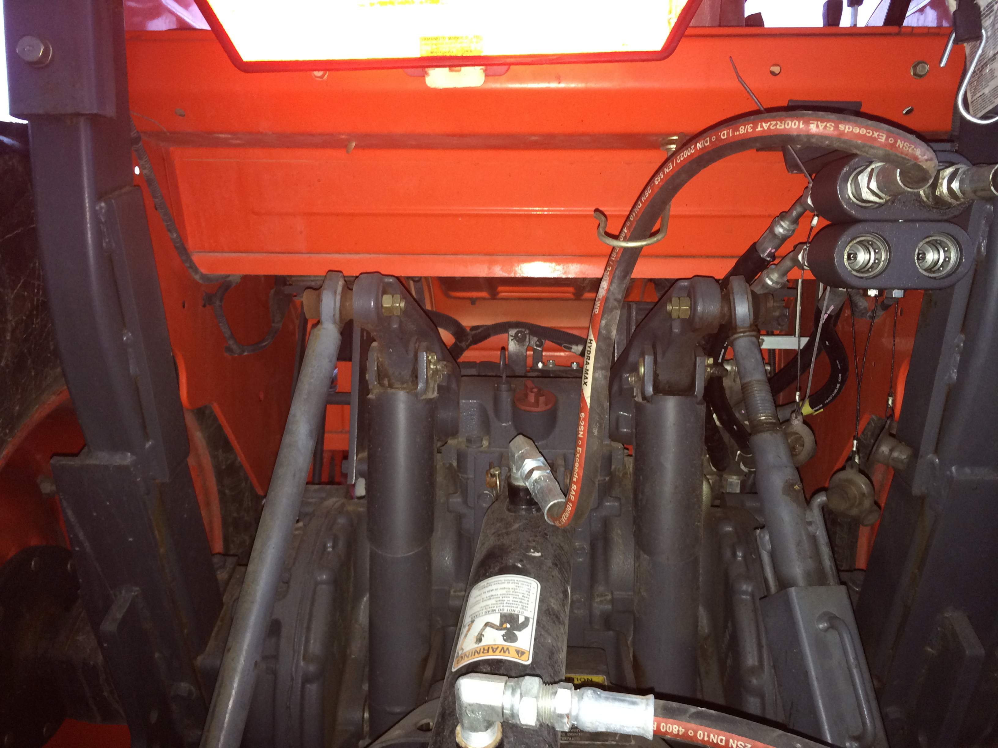

Got it hooked up today. I put the valve in the line just to verify that there is no more pressure.
Right away, it started spewing oil out of the vent hole in the fill cap. I called my guy at the machine shop, and he will try to fabricate another connection with a diverter welded inside to make sure the return oil goes down, and doesn't spew out of the vent hole.
I am curious if this matter was ever sucessfully resolved?
No, it has not. My guy at the machine shop is supposed to be fabricating a fitting similar to the one in my pic above, but with a 'baffle' welded in it to keep the oil from spewing out of the vent hole. He hasn't got that for me yet.

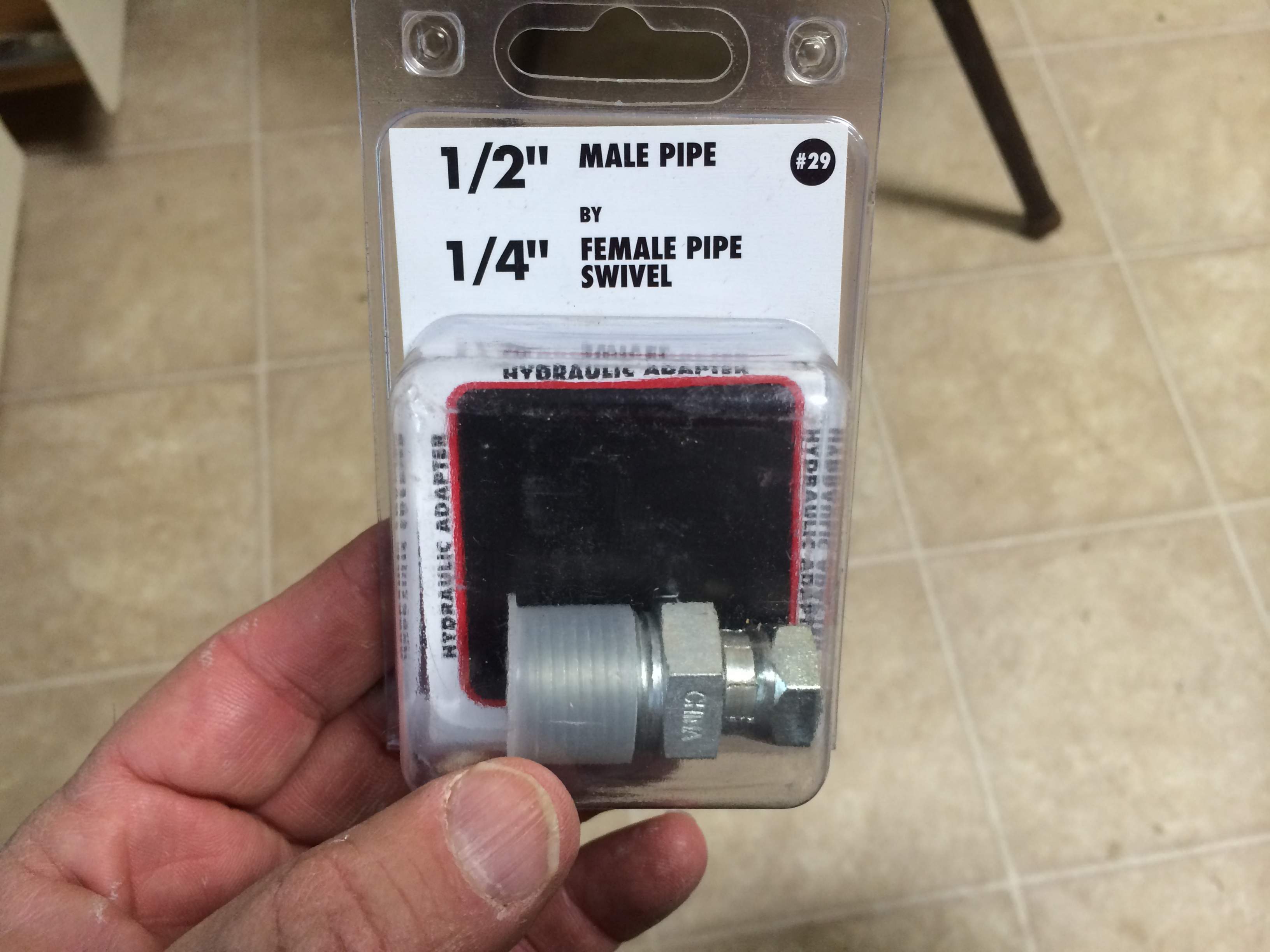

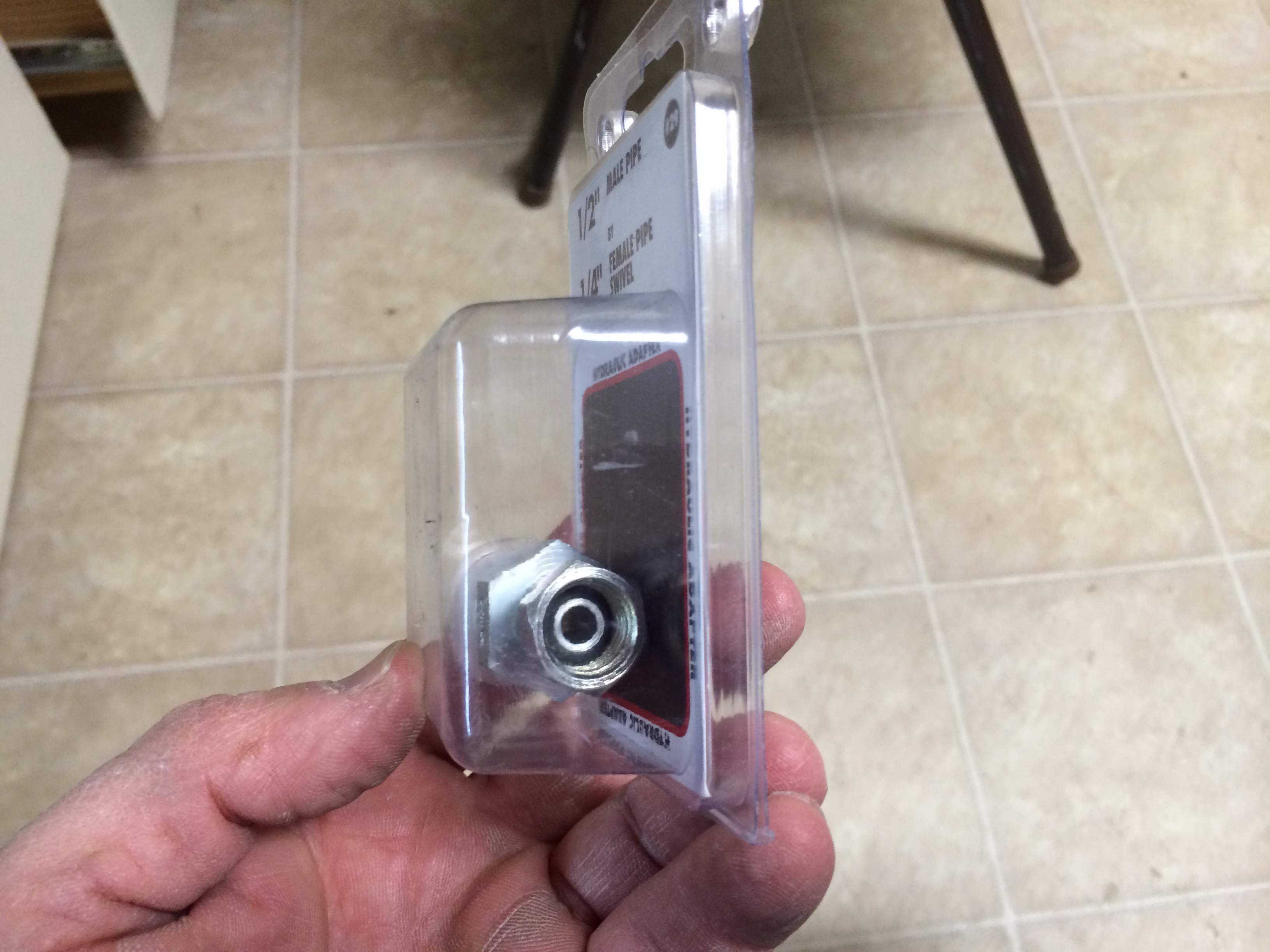

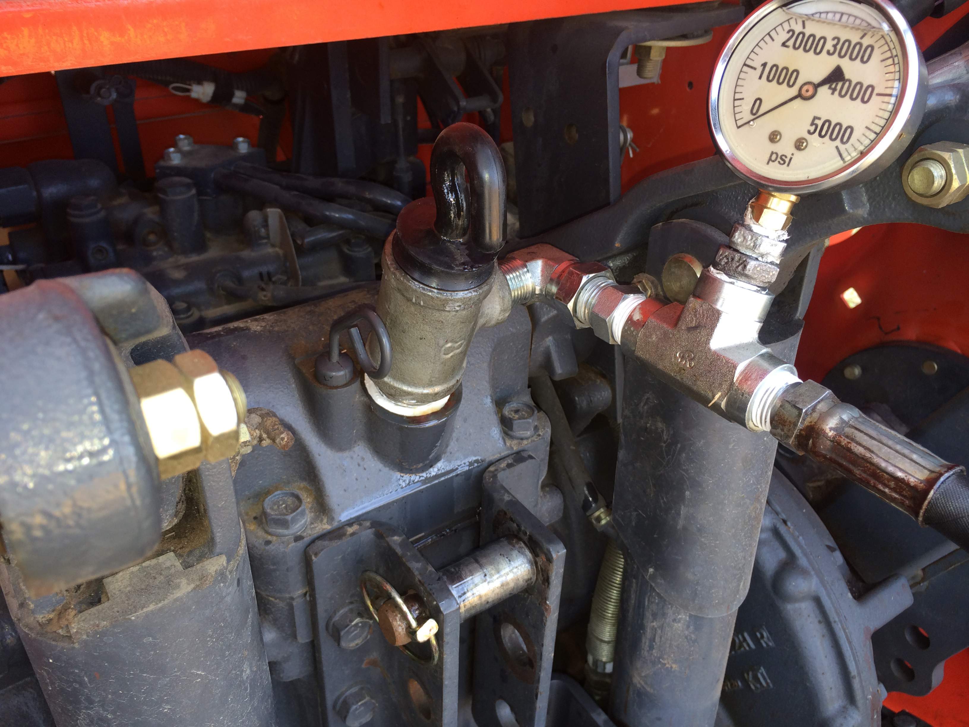

I had a new fitting made hoping to direct the oil flow downward so that it wouldn't spew out of the vent. You can see the new fitting on the left and the old one on the right.
It didn't work. As soon as I got the rpm's up on the tractor, oil began spewing from the vent.
The picture below shows the vented cap in place with the dipstick where it should be.
I replaced the vented cap with a non-vented cap and pulled the dipstick out just a little hoping that this would be enough to 'vent' the system. I'm headed to work on a field early next week with it like this. Hope it works.
I also checked with my Kubota dealer to see if there is any kind of 'power beyond' kit available for this tractor, and they said there is not. I would have to go to an aftermarket system. I've gotten so many different stories about how I should handle this, that my head is spinning. I'm going to try it like this, and if this doesn't work, I'll hook it back to my New Holland tractor to finish this job.
   / Laser grading hydraulic valve issue. #78
I suspect that set up above will entrain so much air to cause system damage. Not familiar with Kubota plumbing but it would seem to be better to tee into the lower drain plug than to go thru the vent/fill.
Hope you can get this resolved and put all of this to work.:thumbsup: I am waiting on a PVG 32 dual valve set up for a new laser system in the making right now.
