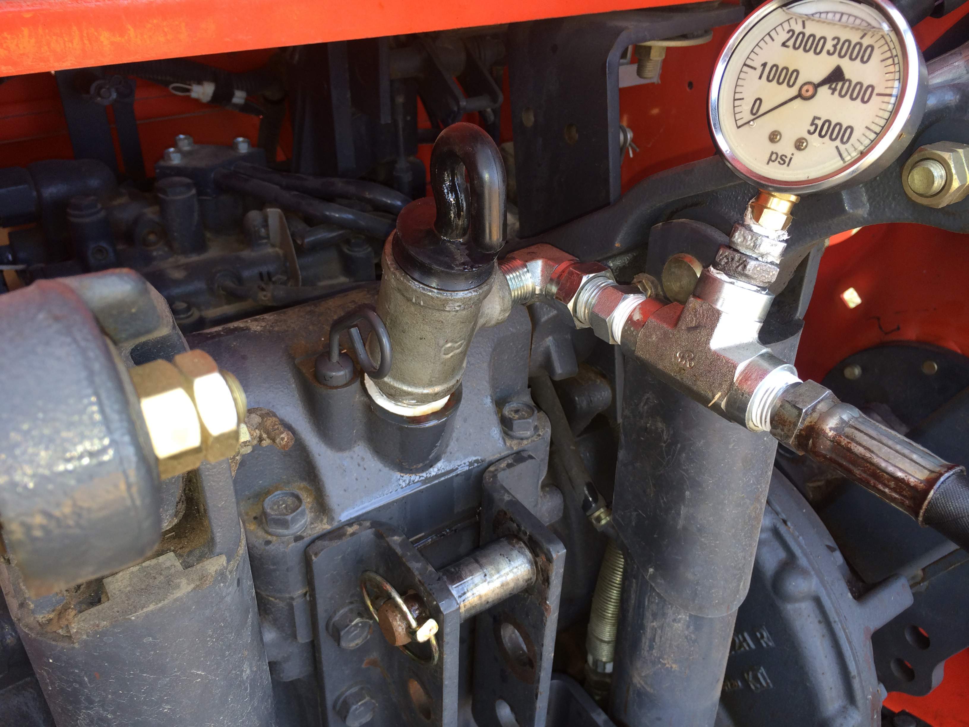

Got it back from the machine shop today. It turned out to be very simple, because the oil fill cap was 1" NPT threads. We originally thought it was something different. I will take the male QD off of my 'return' hose and attach it where the red plug on the right side of the pic is.
It will be a few days before I can test it, but now, there should be no restriction of return oil. And, I now have no way to check the pressure.
The guy at the shop is concerned that if my pull pin were to break, there is no QD for that hose to disconnect and severe damage could result.

Got it hooked up today. I put the valve in the line just to verify that there is no more pressure.
Right away, it started spewing oil out of the vent hole in the fill cap. I called my guy at the machine shop, and he will try to fabricate another connection with a diverter welded inside to make sure the return oil goes down, and doesn't spew out of the vent hole.

#55
