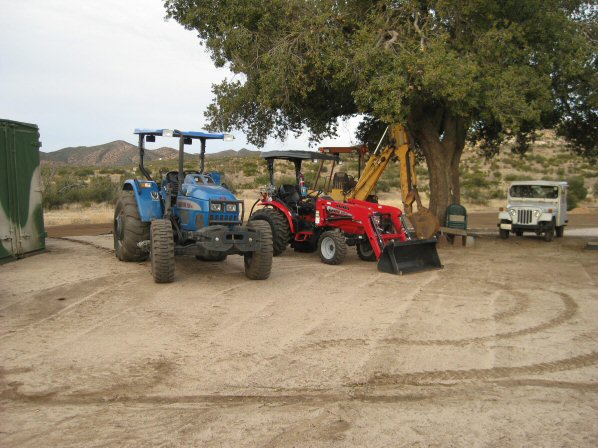

I don't know where you are located, but I know that I simply could not operate for any length of time without some sort of a canopy.:thumbsup:
   / Last minute checklist/add-ons for new tractor?
I checked with Max at Safeway Mahindra and he also sez that from Mahindra it's pretty much one to the front, one to the rear. Wasn't sure how many I actually needed, since I really don't know what I'd use them for outside of the grapple up front. Is a single rear remote pretty worthless? Wasn't sure what I needed to operate the possible top-n-tilt. For no more than I'd prolly need it I could always get my sorry butt outta the seat. :laughing:
Max said canopies were cheap (~$200). I made the one Rusty is sportin' outta the diamond tread aluminum floor that used to be in my flounder boat. Still has the holes from the center console in it. :eek:

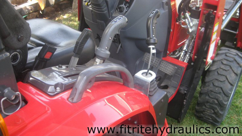

As far as a single for the rear, you bet it is, or can be very useful.:thumbsup: Most people only get a hydraulic top link anyway and you can sure use it for that. If you decide that you want the tilt cylinder, we can just add a diverter, or 2, or 3 to get you a few more rear remotes after the fact. Using the OEM unit and then using the diverters is the cleanest way to get the remotes that you need anyway. That is in my opinion, others may feel differently. Only problem is that the single factory rear remote is sort of expensive. :(
