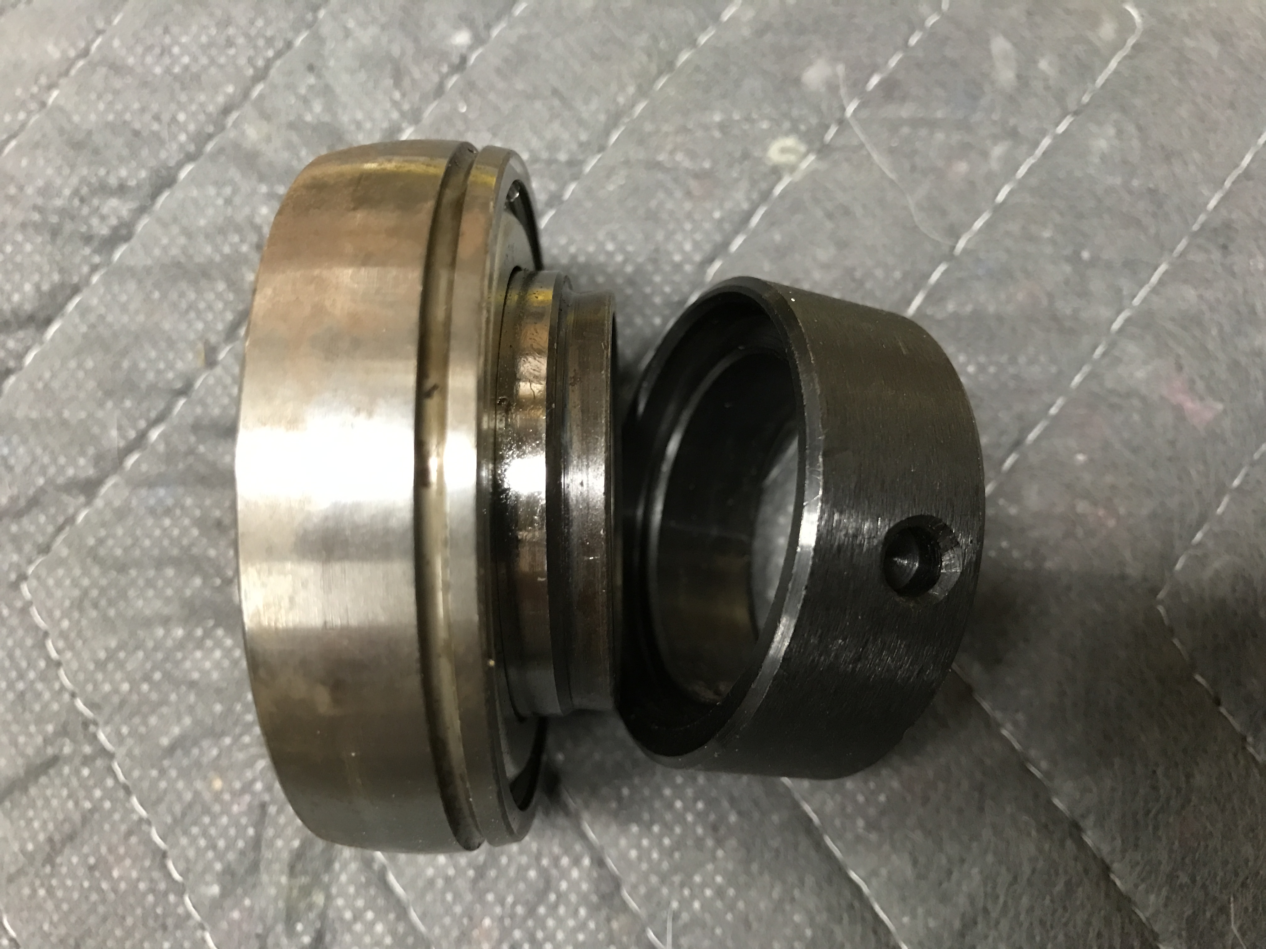

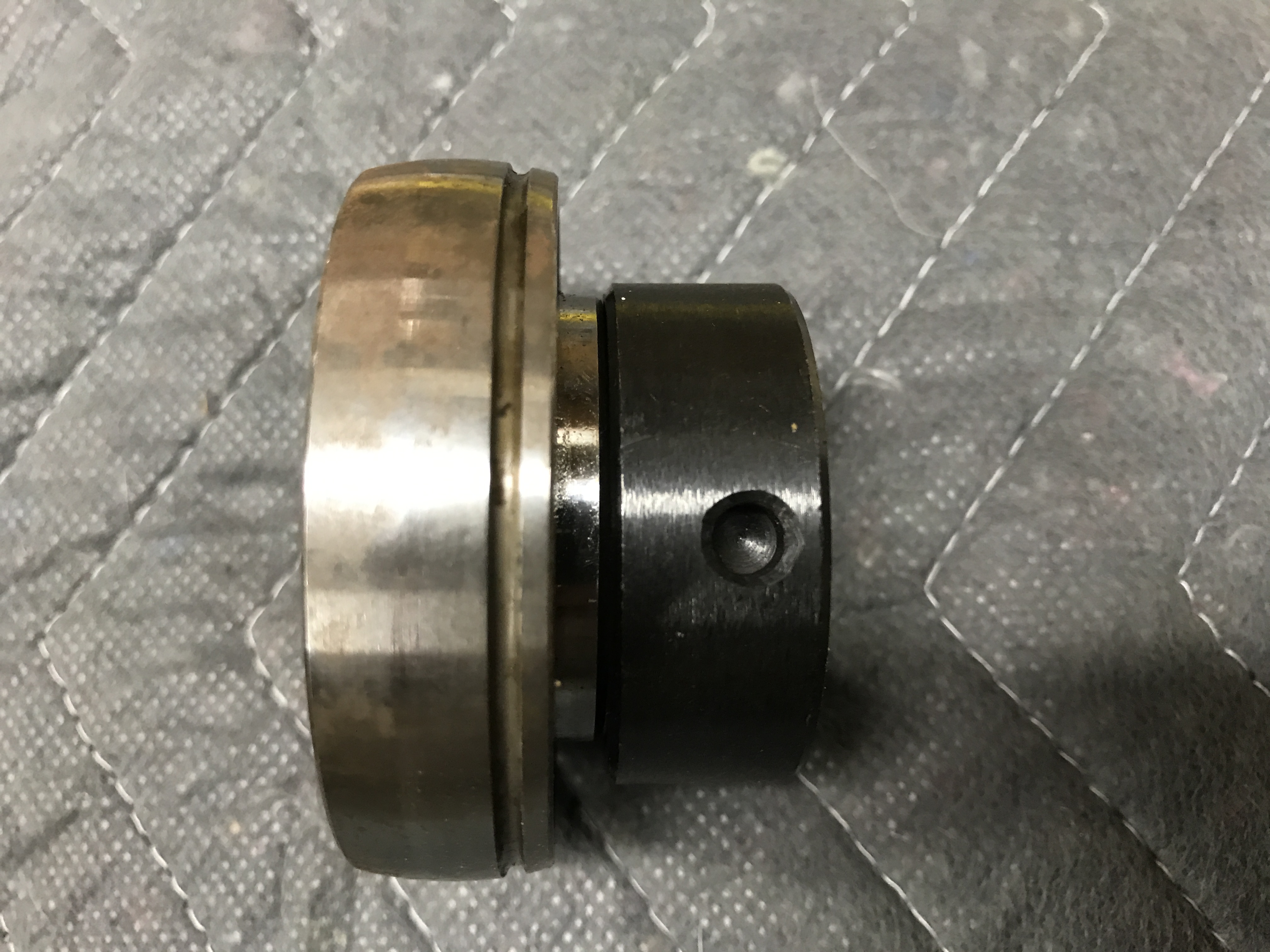

That bearing in the housing you just posted is one of the "Double Set-Screw" type not an "Eccentric Collar" locking type.
That was just one of them. I saw another that was Eccentric but it had an even greater length through bore. That's something I'm concerned about because of the difference in length outside the mount along the axle shaft. I'll have to measure to see to what length I have.
* The eccentric collar type has a longer length through the bore due to adding the collar to the outside.
Mounting the bearing inside/outside the bracket will make little difference.
It will if the axle shaft is not long enough to handle the extra distance outside.
*Yes, axle shaft length is the limiting factor.

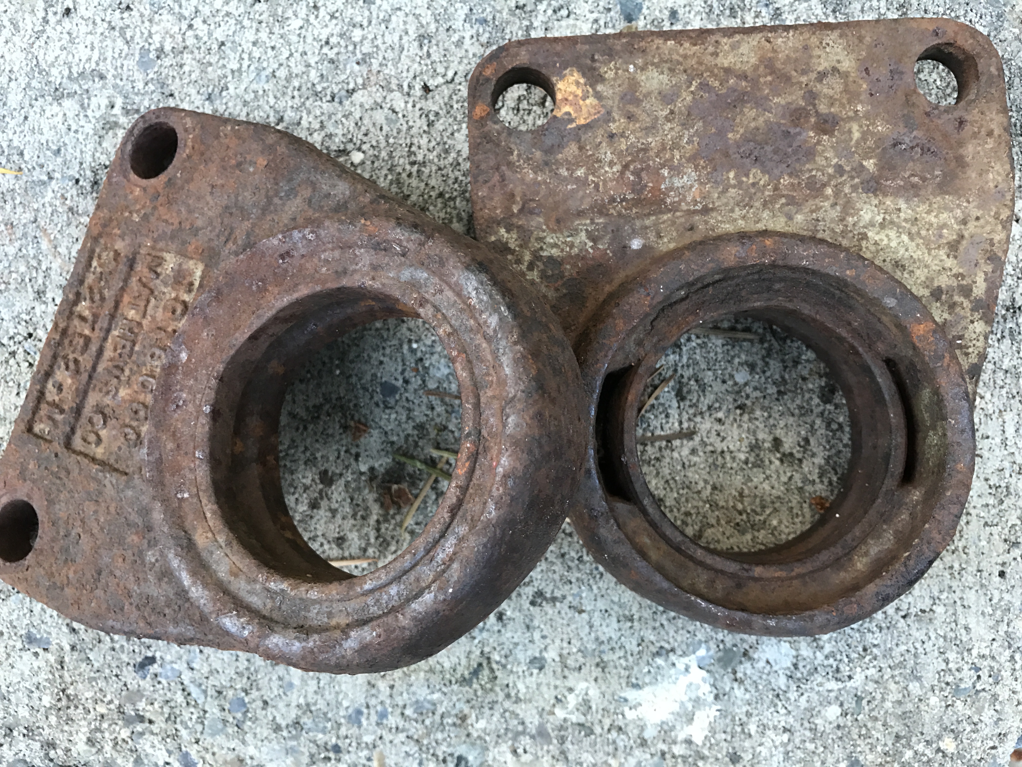

When or if the bearings on my Mott 72 roller go out I'm going to redo the mount and install the 4 bolt cast with the insert bearings. Mine was modified (or cobbled up) after the roller broke. Can't gripe cause me done it in a hurry to get it going.
If you all see me posting about it please help. :) May just go ahead and do it this winter and get it over with. The cast mount is the way to go because the bearing inserts are inexpensive to replace and with proper maintenance the housing will outlast me.
