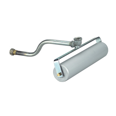

THere are roller mounts for the spray heads but i cant find a link for them.
Edit found a link. Underhill Tracker and RollerPro Traveling Sprinklers They's be simple enough to fab up though.

really great ideas, thanks. It hadn't occur to me to fab up a base for rainbirds, what a really great idea.

My inground sprinkler system runs on well water. What I did this past year for the vegetable garden was to fab my own sprinkler system because all the ones that I have used in the past had crapped out after one season. It is run off well water and fed through a 3/4" hose. The riser is made out of 3/4" PVC and the impact sprinkler screwed directly into the top. Mine is attached to a post sunk in the middle of the veggie garden but there is no reason it couldn't be made portable. As others have said, the Rainbird impact sprinklers seem to handle hard, mucky well water better than most. Use the largest nozzle that you can depending on the line pressure and coverage that you want.
